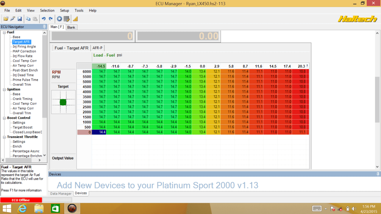

Mike here are the maps I am running.
I have settled on these to give myself great power but still be fairly easy on the stock, rods, pistons and bearings in the 160,000+ mile bottom end. In your setup with forged rods and pistons you shouldn't need to taper boost at all.
First is my Air to Fuel map. I have keep it fairly close to 14.7:1 in Vacuum but taper to 11.5-11:1 as boost builds.

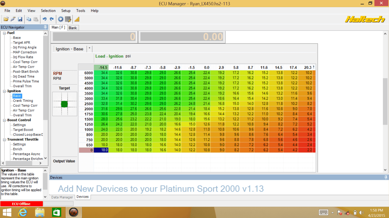

And finally my timing map.
This one is the most rough and I think I could push timing up a bit more, but I really need more dyno time and some knock ears to detect any detonation, but I know that this is safe so it is what I am running right now.
Spark tables are hard in my opinion to setup. Reason I asked was because a while ago I asked you what your fuel mileage was with the turbo when I was considering whether to go 1fz turbo or Ls. When u said 11, then I decided to go with a LS motor. But looking at your table, have you considered upping the "cruise" timing area of your map? Maybe your not that concerned with it, but I think you have room to get considerable fuel mileage increases if u upped the timing in the cruise area of the spark table. Highway cruise timing is something I've tried to research quite a bit and have gotten some nice gas mileage. On my 2f in my fj40, I'm getting 16MPG with 35s at 70mph. In some areas I'm running around 50 degrees of advance during cruise.
At Cruise I get 16mpg. When I said 11mpg it was city driving and lots of idling. I am pretty sure I mentioned that. Lol. And gas mileage is just a function of right foot control. When you actually have power it’s a lot more fun so you see a decrease in mileage. Lol
I see about 10-11.5mpg around town and 15-15.5mpg on the hwy. the around town includes quite a lot of idling and a little hooliganing. The hwy mileage isn't changed from before I was boosted unless I push it up to 80+mph.
