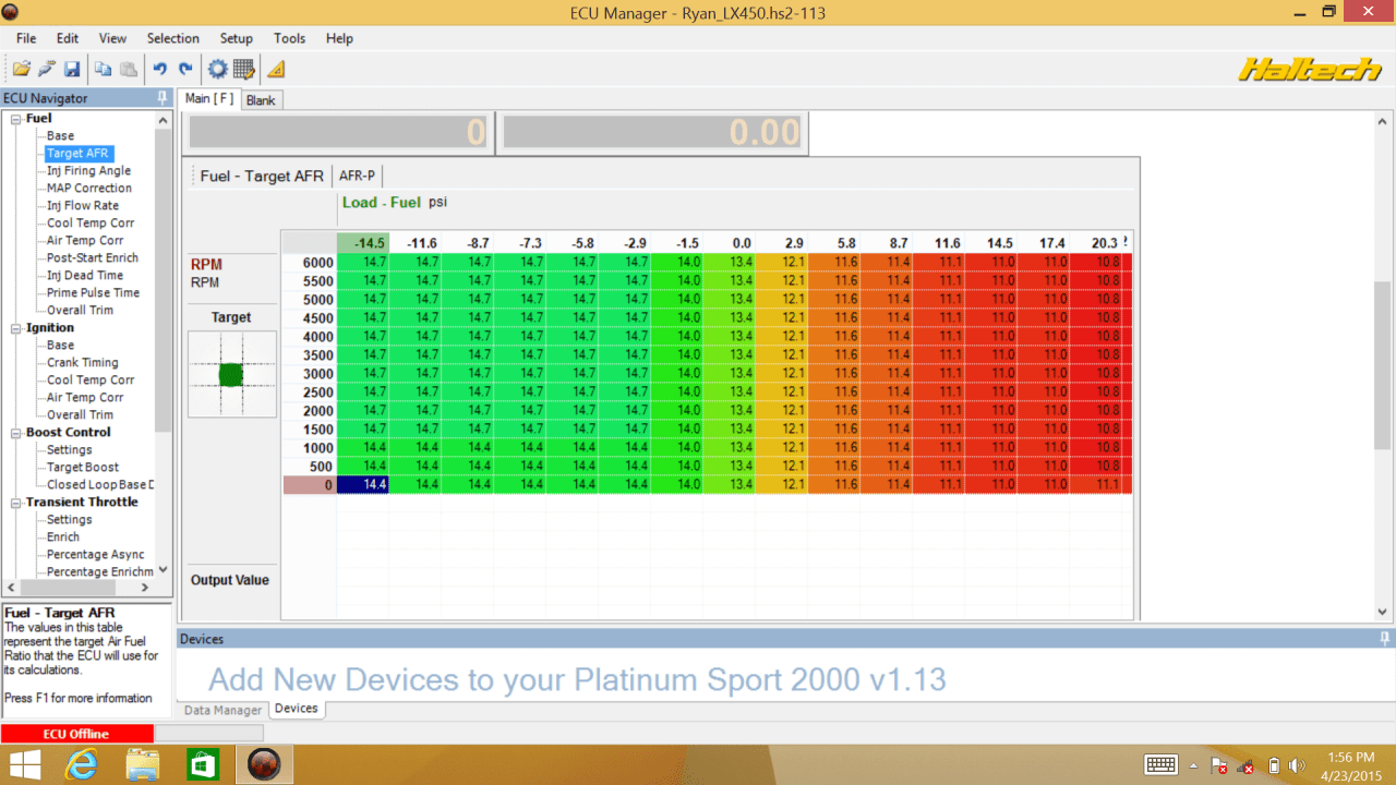

First is my Air to Fuel map. I have keep it fairly close to 14.7:1 in Vacuum but taper to 11.5-11:1 as boost builds.

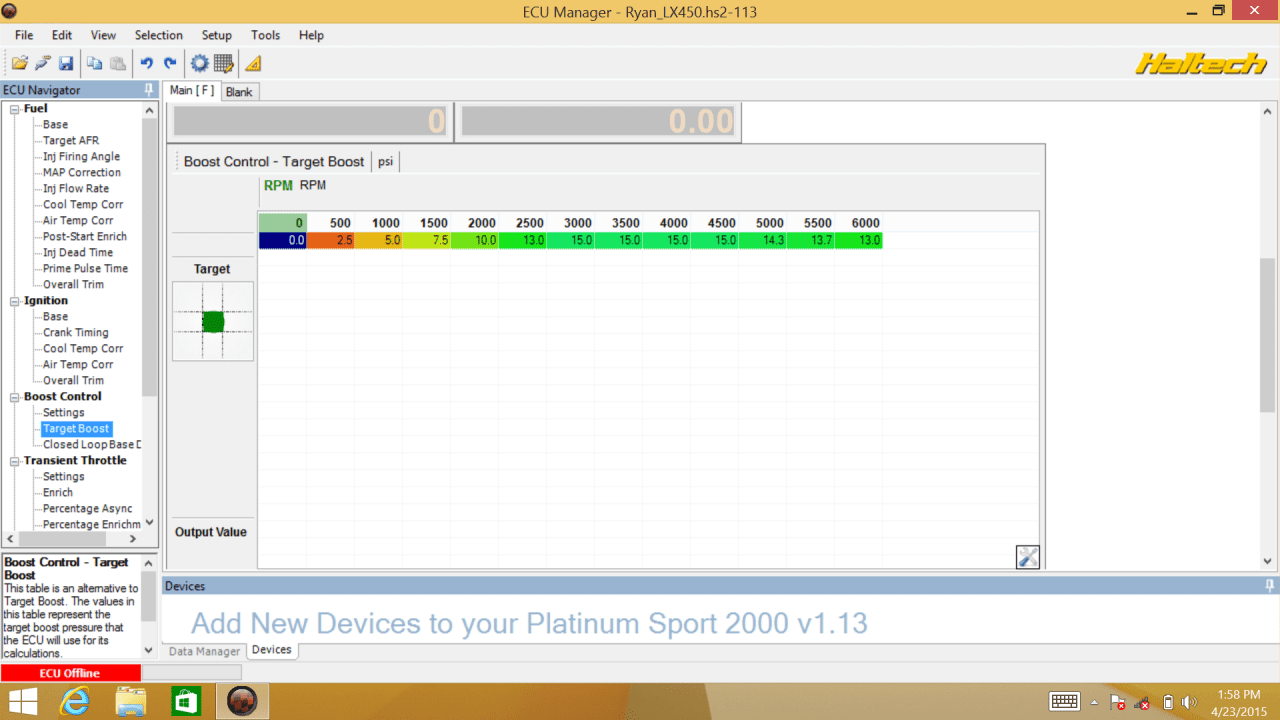

Next is my boost taper map.
I have run higher boost (up to 17psi) but this is what I settled on to give myself the best mix of power and longevity on my stock motor, with OEM bolts and head gasket
