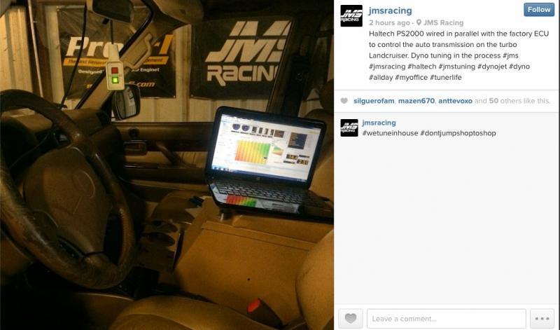

Ok I resisted the urges to mess with it any more, no crazy ignition systems etc, just run it how it is and leave the damn thing alone. Got the transmission finished, the transmission guru says it should be good for 700hp. Also installed the Haltech and cleaned up the tune a lot. Picked up another 60hp and 60ft/lbs in the midrange, the tuner was so happy to get away from the AEM he said the Haltech was a thousand times better. haha. Hope he doesn't care I stole these pics from their instagram page. lol.
New steels, an extra clutch and redone valve body. Pretty simple mods. I am no where near 700hp probably closer to 450hp maybe peaked 500.

Which Haltech kit did you go with? The Supra one?

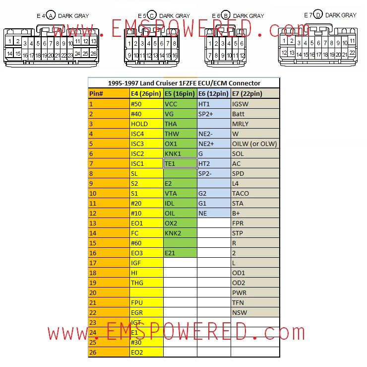

I didn't use a kit, I used the PS2000, with the pigtail wiring loom to wire it in parallel with the stock ECU. I know EMS gets a lot of hate but they had a custom 1FZ patch harness made up so I could plug it in between the vehicle harness and ECU and then make all my splices/taps there and not cut any of the factory wiring. If I wanted to go back to factory, I could just change injectors back to stock, remove the patch harness, plug the stock ECU back in an remove the turbo setup.
I would not go with the PS2000 now though. Their new elites are much much better. They have auto tune and knock standard.

Again I know EMS got a bad wrap but they did more FI stuff in a year than the 15 years anyone else did prior. Lol. Here are the old pin outs I had from them.

The patch loom is compatible with the Haltech units your saying?
The patch loom plugs in between the vehicle loom and the ECU so that you can splice and patch into the wires you need without hacking up the stock wiring.
Thanks for posting the pin outs, I'm saving for when the time comes...
