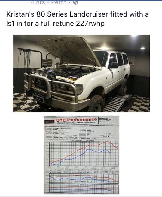

Terrible picture but the only LS LC I have found that was actually dyno'd. 227rwhp is much less than 3UR and Turbo 1FZ.

Can't see from that photo what type of Dyno is being used there. DynoJet to DynoJet is apples to apples (sort of based on settings), but a Dyno Dynamics is load based and will always yield a lower whp number. Where I came from in the tuner car world people played games with dyno settings all the time to manipulate numbers. I'm not saying this is the case here, just saying its hard to be really accurate unless the 3 setups were compared on the same dyno on the same day on the same settings.
I have an LS2 swapped 350Z and it makes a bunch more whp on a Dyno Dynamics than 227rwhp. LS2 is a few more cubes than an LS1, but the truck above isn't even running 4wd. That driveline loss must be staggering. My swap is stock other than an intake, headers and 3" exhaust with no cats. Guess I just expected more from the LS, but regardless I like the turbo idea on the stock motor more I think.

That figure of 227rwhp is about what would be expected considering an LS1 was only like 305-320hp at the crank. The 3UR with headers and exhaust should be close to 400hp at the crank and is only 286awhp. I think it is something many people do not realize. The stock 1FZ is 212hp and around 135awhp. We are not comparing if a sweet K&N air filter gave you more horsepower and it needs to be tested on the same dyno/same day, we are making gross generalizations backed up by moderate commonsense.
