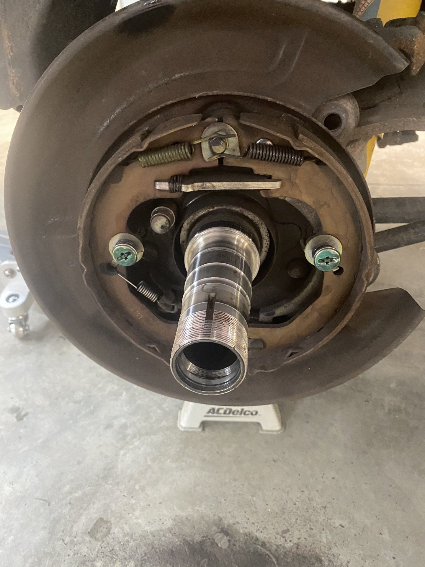

Haha the joys of daily driving a 23 year old truck. I am sure this is probably the first time this axle has been resealed and had new bearings. So not bad for 170,000+ miles. Lol

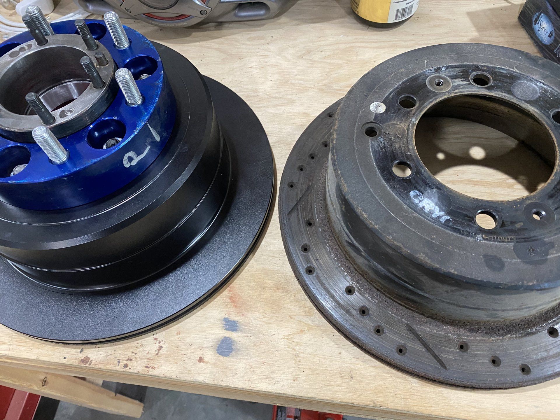

Today I went to do rear bearings and seals and the rear brake calipers were not satisfactory. So ordered all new brake parts. Calipers, rotors, pads, hoses, banjo’s, washers, all the e-brake components, etc.

pretty safe to say I got my money’s worth from these. Lol
There's still more pad left on those, i bet you can get another 5k out of them.... :) JK of course.
New calipers too, that's going to feel like a whole new truck.
Haha, I think there were the pads you guys did at your shop when I had you put the locker in the rear end. So that was like 7-8 years ago! Good to see you back around.

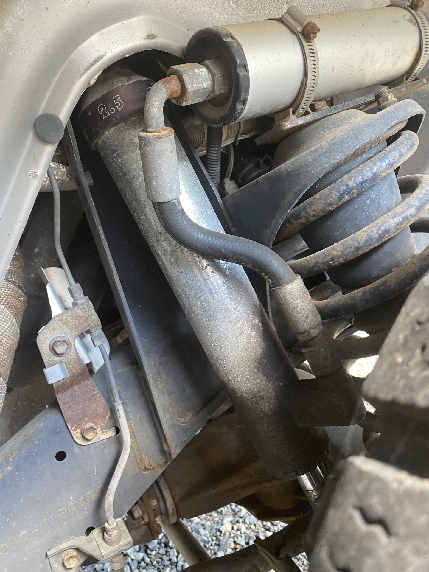

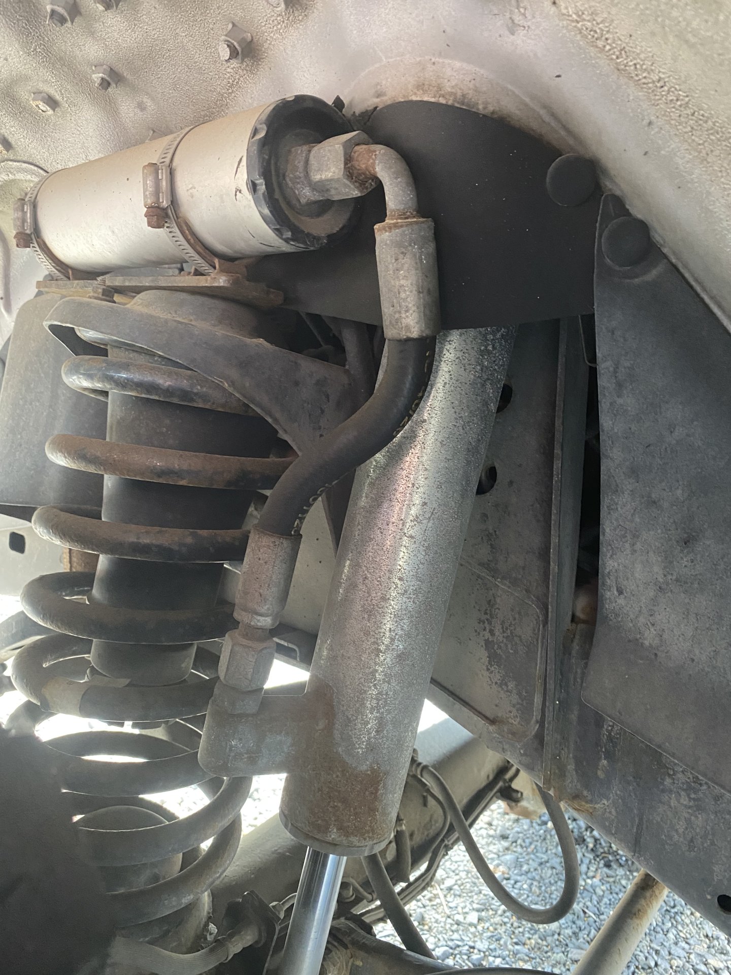

I had a PM request asking about my Slee/ADS shocks. They wanted a picture and adding pictures in PM is a pain so I am going to post them here.
Now just to be transparent I love my Slee ADS shocks they make the ride feel great and I wouldn’t hesitate to buy another set!
What you’re about to see says a lot more about MY lack of maintenance and abuse!! This truck has driven across country multiple times, been through east coast snow storms and salt, mag chloride on the west coast, daily wheeling for 3.5 straight months, driving like I am in the Baja, etc. I think pulling these shocks off, hitting them with a scotchbrite pad rebuilding them with new seals and spraying them with WD40 would bring them right back to looking new.
So after something like 8+ years this is what they look like.

For 8 years of use those look GREAT. Even 8yr old Toyota shocks need to be replaced by that point.
I have them on my 80 and they totally transformed the truck. Both on road and off. It corners like a rockstar even with 4” of lift.
