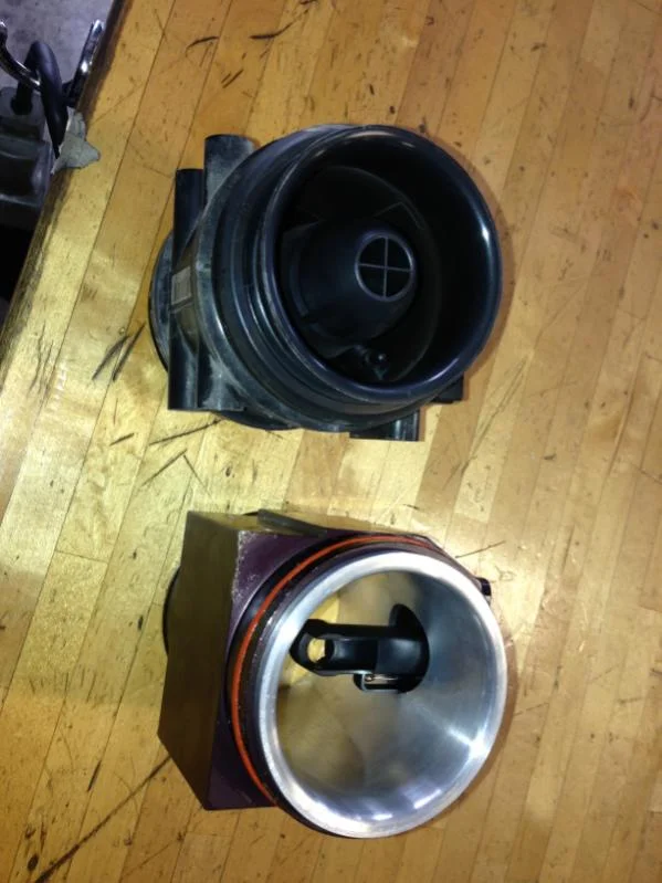

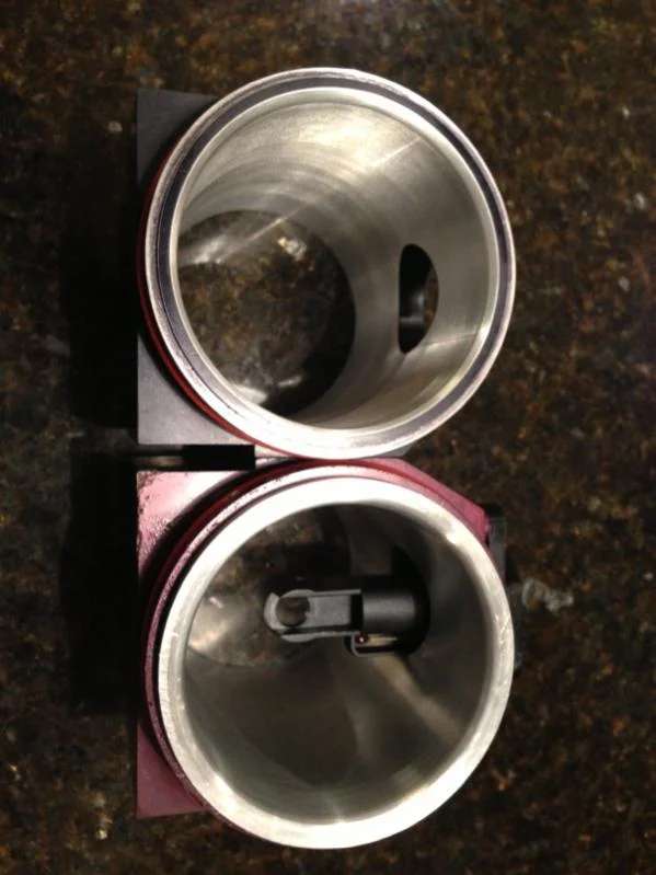

I will be putting it back on the dyno when I can track down a Landtank MAF Housing so I can get back to back results for anyone that might want to buy one.

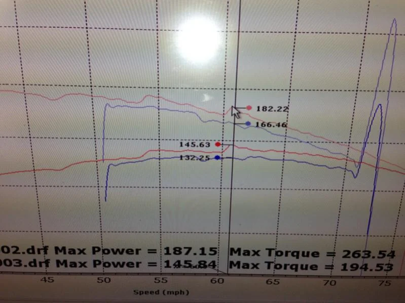

Well back to the dyno today! Had great results with EMS Powered's exhaust. Single cat and muffler with no silencer. Had gains everywhere with the biggest difference being 13hp and 16ft/lbs. so like 8-10%
Disregard the large spike at the end it was the truck shifting before JMS locked it to a single gear.

Ryan, nice gains...having a new head had to help bit...its sounds sweet
Lou
Yeah the head refresh might have helped a little, really it is pretty much the same gains Baktash saw on his stock 80. He saw a little more gains down low, but we couldn't get the truck to hold the gear down that low on my truck without shifting down so really it was about a 2800-5000rpm pull. I think freeing up the exhaust if you don't mind a little more sound will help the 80's, it is definitely noticeable and a plus having a nice full stainless system.

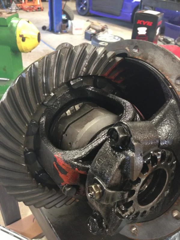

Installed an auto locker. Yes I know they get a bad rep. They are noisy they do have some odd street manners, but no leaking air lines or stuck electric actuators kind of another "keep it simple" mod.

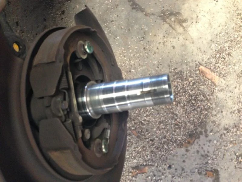

Since the third and axle shafts had to come out to install the locker I figured this was a good time to do a rear axle overhaul with new bearings, seals and gaskets.
Inner Bearing 90368-49084-77 X 2
Outer Bearing 9008036067 X 2
Oil Seal 90311-62002 X 2
Oil Seal 90310-35001 X 2
Hub Gasket 43422-60040 X 2
Diff Gasket 42181-60060 X 1
