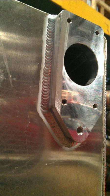

EMS had a break in their schedule so they knocked out the custom A/W tank for me. Awesome fabricators and I was lucky enough to be there to see it go together. Marc their welder/fabricator, can just see angles and sizes and was never wrong bending in the manual brake it was pretty cool to see. Me personally I would have been walking back and forth 5 times before I got it just right.
So it's about a 5.2 gallon tank, double welded (inside and out) with a thick weld on flange for the Meizere 20gpm water pump.
Awesome tank! Can't wait to see yours boosting
