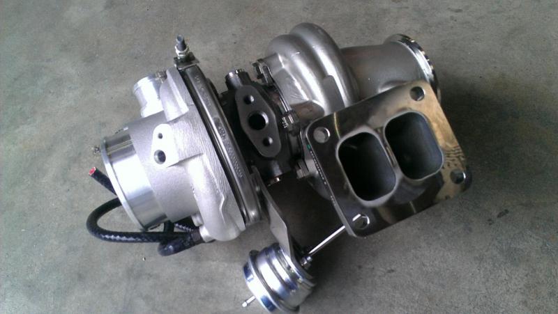

I am doing a turbo.
Ordering everything now:
Turbo - Borg Warner EFR 7670, right between a Garrett GTX3076r and a GTX3582r. Twin scroll T4 housing, .92 A/R
GTX3076r - 58mm Inducer, 60mm Exducer
EFR 7670 - 57.6mm Inducer, 62mm Exducer
GTX3582r - 58mm Inducer, 68mm Exducer
Injectors- sized for 85% IDC, stock fuel pressure, 450-500hp flywheel ~565-625cc
Tuning is still TBD, will be working with JMS Racing to have it tuned. Possibilities are PROEFI, Haltech, Motec. Musts are multiple maps for various boost and octane ratings.
EMS Powered will be doing the fabrication, well if they agree to it. ha. Will be w/a intercooler, unless Baktash and Marc can find some possible way to do a/a.

Haha yeah. I thought I could let it be, but after the Landtank MAF business, I was telling myself if I could just get a little more power I would be satisfied with it. I would have been satisfied with 15-20hp, but after wasting $650 and 2 days off @$700+ a day and got nothing I knew I screwed up. The wheels started turning.
The minimum ROI for me to turbo is 300awhp, so just over twice stock, anything less than that and the costs don't justify it in my mind. I tried to pick the very smallest turbo that would make 500hp at 5000rpm's on 4.5L so lag would be kept to a minimum. Borg Warner says I should see 5psi at 1000rpms. And full boost by 1400rpms.
JMS is very familiar with the 3 ECU's I listed, they really like PROEFI and just tuned a 1400hp twin turbo 5.0 mustang on it. Obviously very different platform from our 80 series but I trust the tuner and have watched him he is very methodical and takes his time. I like motec but the price is steep. Haltech is another great option. I will give them my requirements and trust their choice.
