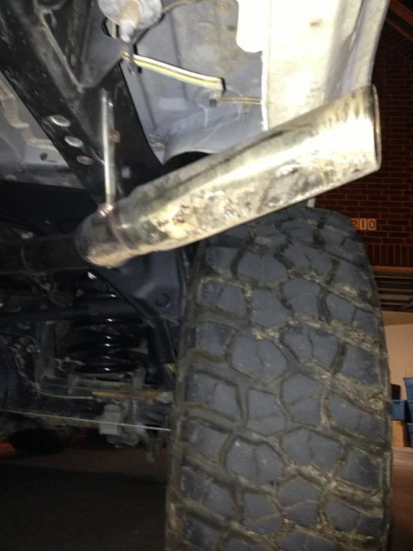

I can barely make out the exhaust end in the pic showing the muffler back, but does it cut level with the bottom of the frame rail? Is that the "tucked" version?
Yes it is tucked above the bottom of the frame rails, with a turn down that is cut about level with the bottom. Not sure if this is a better picture or not.
This isn't a serious rock crawler so I wasn't worried about it too much, I just asked them to look at it and give me something that makes sense given the powder coat scraped off of the 4x4Labs bumper from dragging the rear.
Haha Nice tuck job!
Yeah creating an exhaust must be a fine balance some people are going to want them tucked up out of the way others are going to want a big shiny tip showing, hedging your bets and spending the money for a production run must be hard.
I was talking to Baktash about this and I don't envy his job at all. It must be impossible to try and stock a part when everyone is going to want something different.
That's precisely how I wound up with untucked stainless. Requested aluminized tucked, but agreed to stainless due to logistics and production runs.
I can't weld stainless or it'd already be done, but plans to raise like yours is depicted.
I wipe mud on the tip to conceal the bling. Bahahaha.
