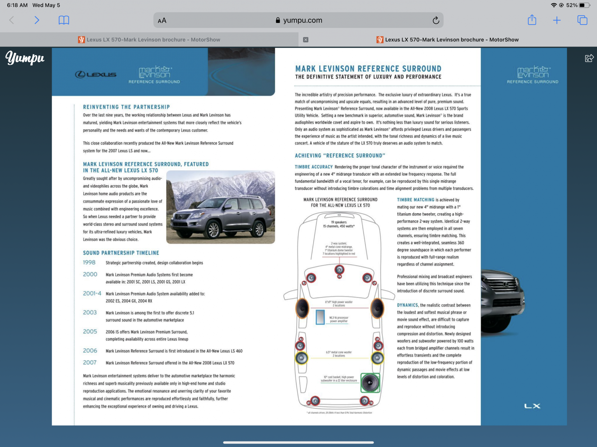

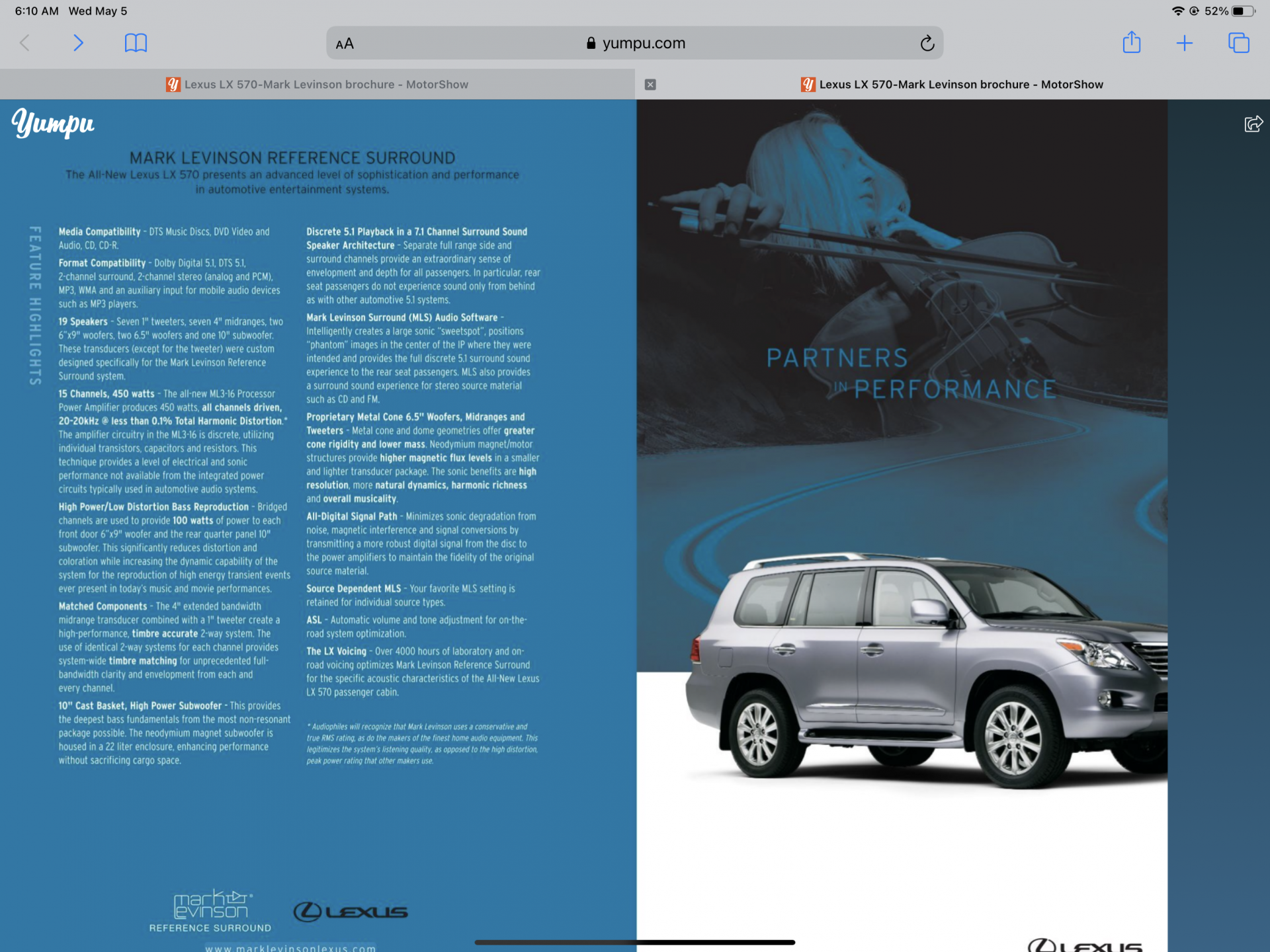

More info on Lexus ML Reference system:
Besides the speaker arrangement differences, it is the ML amp specs that separates it from lesser systems (e.g. LC JBL). ML amps are rated with all channels driven at same time and at low THD. Most other amps are listed with just one or two channel driven…thus, you see much bigger “wattage”.
Finally explains why there are only 12 powered channels. They have 15 100w channels and bridge 3 of them, for 12 different powered channels.
Yup. The front door woofers (6x9) and the cargo subwoofer take up most of the wattage from that amp! Bass needs lots of wattage.
I am 99.99% sure that the LC JBL also does the same thing in terms of bridging the front door woofers and subwoofer. This is common practice among the JBL and ML systems.
