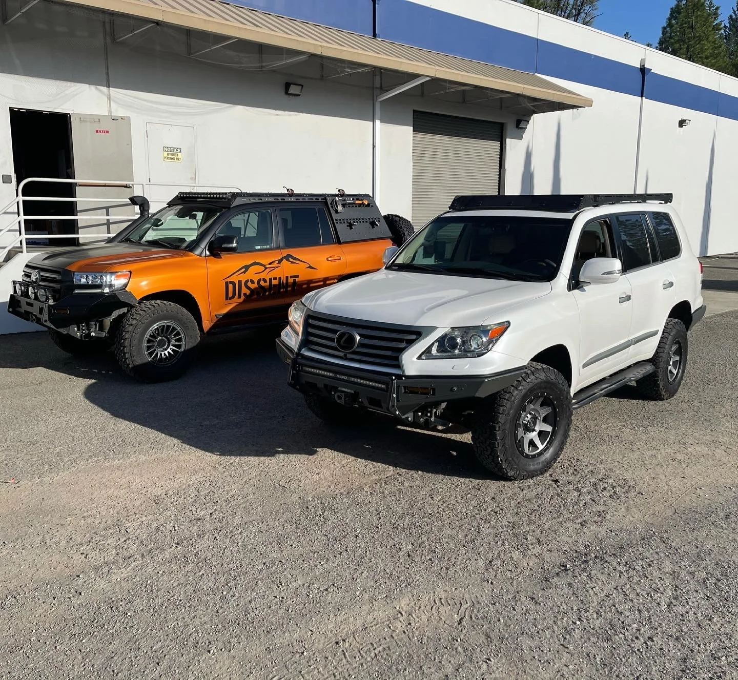

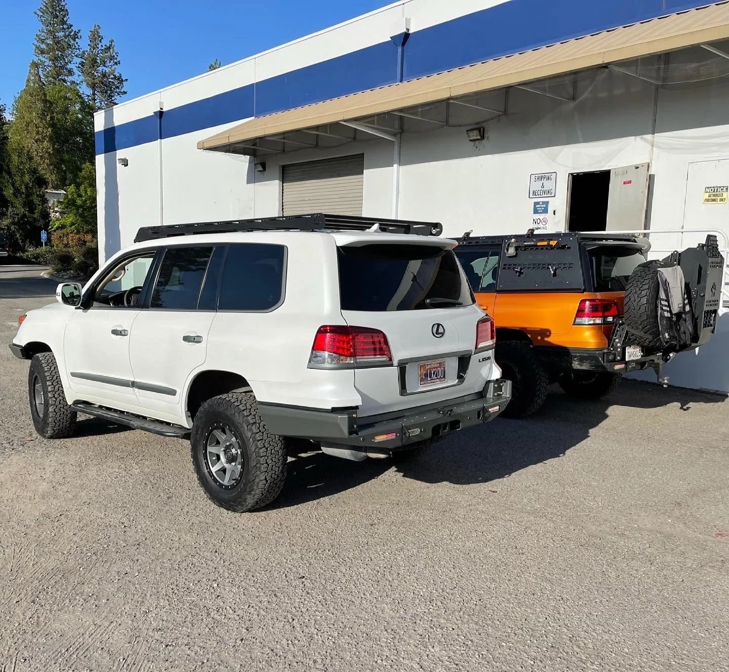

I just put Dissent front and rear bumpers on my 16’. (Sorry I haven’t taken pics of the rear yet)
I think that looks sooo good!
I just put Dissent front and rear bumpers on my 16’. (Sorry I haven’t taken pics of the rear yet)View attachment 2659236
My goodness - I've got the same color in a 2018. Nice to know what it would look like with Ben's handiwork. :woot:
I think I spy SLEE sliders too. Do you like the fitment?

Yes those are the slee sliders. Personally I wish the sliders were more aggressive, tube style, and were not so low. They really look like stock, I doubt most people notice them. I suppose they get the job done. Funny thing is in a perfect world I’d have the front bumper a little less aggressive... But I am very happy with everything how it is. Everything is very functional, and thats what I was going for

I think you're describing the Metaltech 4x4 LX570 sliders. Though not much can be done for the 'so low' comment. The frame is where it's at.
My slee sliders have taken a beating for what it's worth. There is quite a bit of vertical adjustment in them too. I initially installed mine pretty low but was able to loosen them up a smidge and put a floor jack under to get tucked another inch or so. There is some risk in deflection when you have them close to the body but I haven't had a problem.
Yeah, I like the metal tech ones, but at the time the slee were the only ones available. That’s great to know they can take a real beating, I haven’t had the weight of the truck really smash them yet. One thing I like about my truck is that it doesn’t look too “overland” or extreme, I drive it daily and it mostly passes as a luxury suv. I just think it’s awesome that one vehicle is comfortable for road trips, hauls my trailer and s*** loads of gear, off-roads, is reliable and can impress business clients. I can’t think of a single other vehicle that does all that
