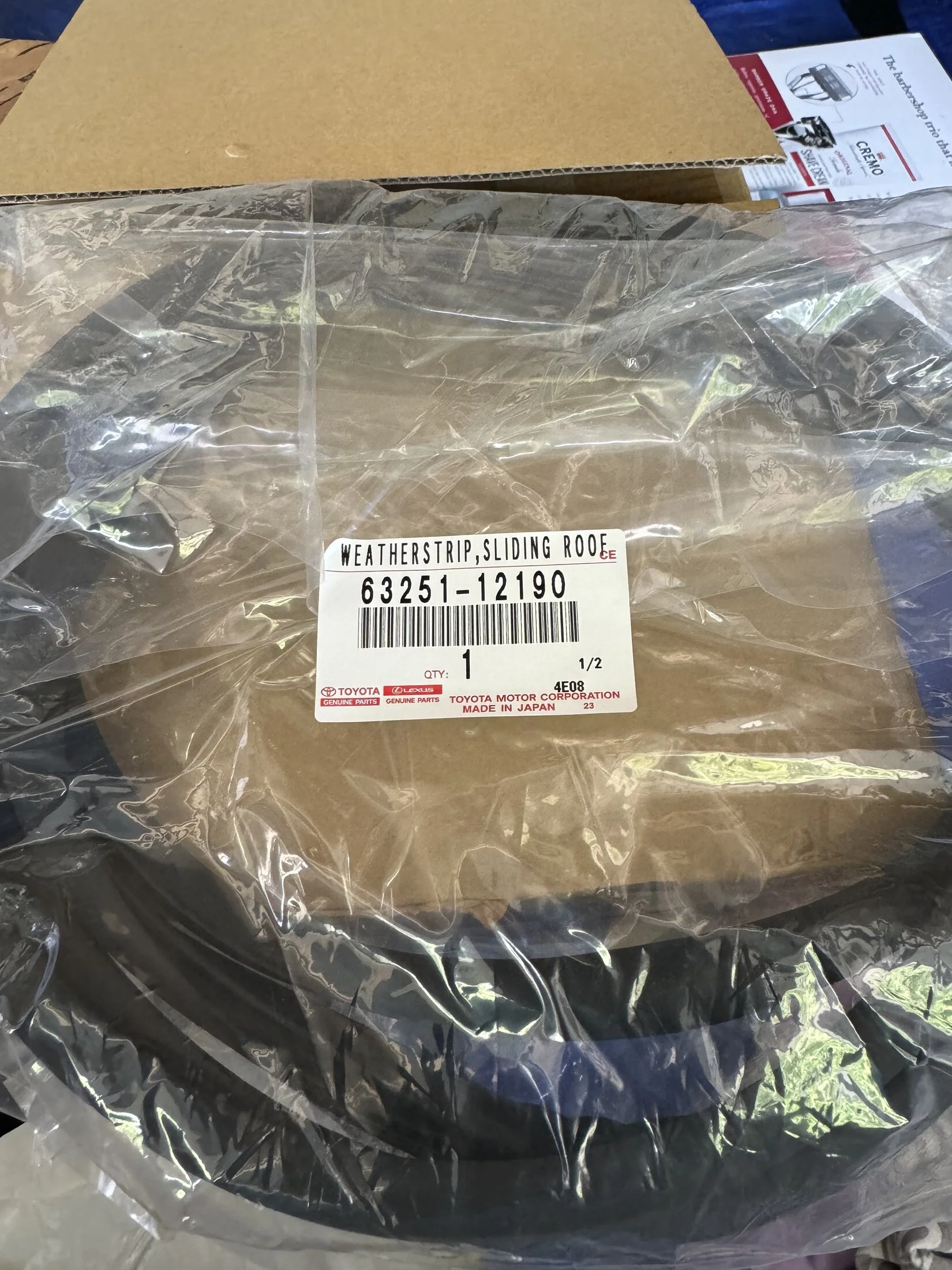

It's most likely clogged sunroof drains. You can get a tool to clean them out cheaply on your favorite mass online stuff retailer.
For the record that gasket will always leak to some extent, it just can't be water-tight and let the sunroof panel move in the way it needs to. The drip tray under it is intended to catch the stuff that gets through, but for that to work the water needs to be able to drain away. Pollen and dirt get through as well, take up residence in the drains, etc.
I have purchased the gasket just in case.
