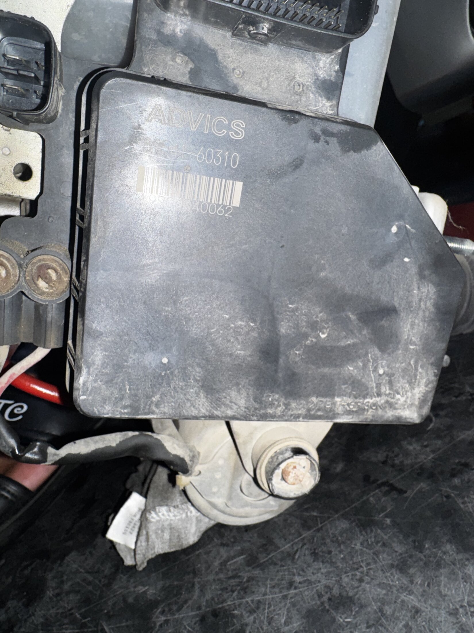

Need advice.

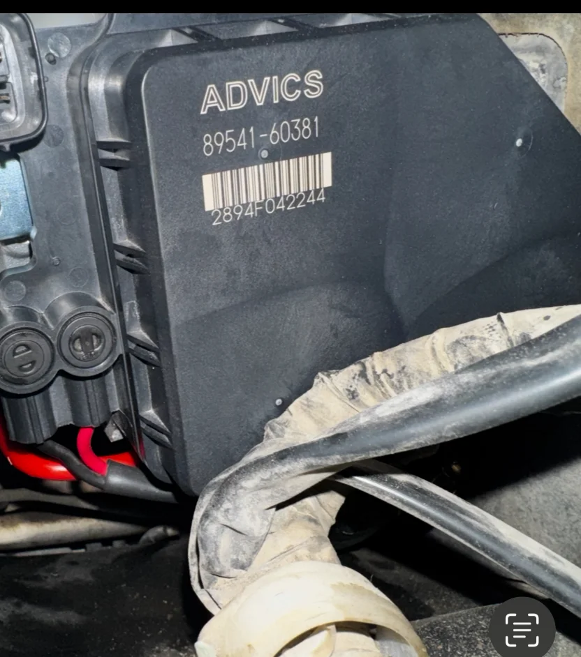

I had problem with my LX570 ABS it was giving lights and beeps with no brakes, approached mechanic he advised ABS unit to be replaced, the part no. Came out to be 47050-60330 but later on he suggested to replace with part 47050-60331 which was cheaper approx. 30% . I did that but ended up with two issues radar cruise is not working properly it cuts the cruise if brake need to be applied.
Secondly, if I put in 4lo traction light keeps on and crawl on/off switch don’t work but when I push traction off switch it activates crawl.
It seems the mechanic messed up everything now it is still and expensive part and cannot return neither replace if anybody has any solution your help will be appreciated.
There are no lights in dash.
Old ABS number printed on it was 89541-60310
New printer number on abs 89541-60381

Speedometer is fine sometime 4lo blinks but go away after restarting but basic issue is ABS was replaced with different part number however i check both are for LX570 and if i check compatibility online on and part website it shows both are compatible with my VIN
