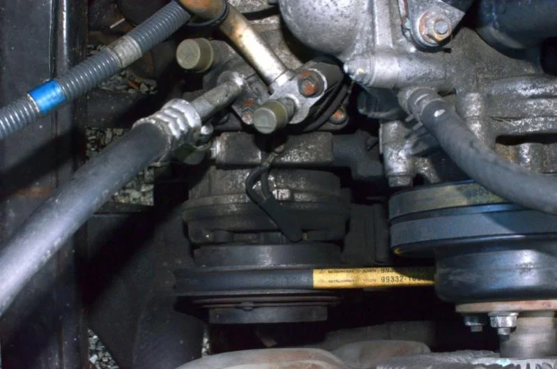

So AC is out in my new to me LX. I have read lots of posts regarding its failure. So.....I will remove the belt to see if turing the compressor is difficult, check to see if it has been over charged and inspect the clutch. The compressor has a good deal of dust around it. I am guessing it is dust from clutch and hoping it is not the result of a frozen compressor. If I find free moving compressor and charge to be at an proper level what else should I look for before bringing the system to be discharged and cleaning/replacing components to the system?
Check condition and tension on the belt, also check the tensioner pulley. Like CJF said, you can turn the front hub of the compressor without removing the belt. Once you've established that the charge amount is correct, gauge readings will give an indication of the condition of the compressor and you can proceed from there. Any chance of posting a pic of the compressor ?
Thanks for chiming in. I will post some pics tomorrow.
Here is the AC Compressor. Black dust I assume is from the clutch. The belt was very loss. After tightening it the compressor stayed engaged and the ac seems to work. The glass is showing some bubbles (low freon?). Previous owner said there was a "poof" then the ac stopped working and belt was squealing. I thought maybe a blockage in the system. I am going to run it as is for now (don't need it much in Maine) but want to trouble shoot before any trips. Will run it for a couple of hour trip and if it fails again buy some gauges. Seem like reasonable approach?
What kind of light do I buy to find the UV dye added by PO? UV led black light?
