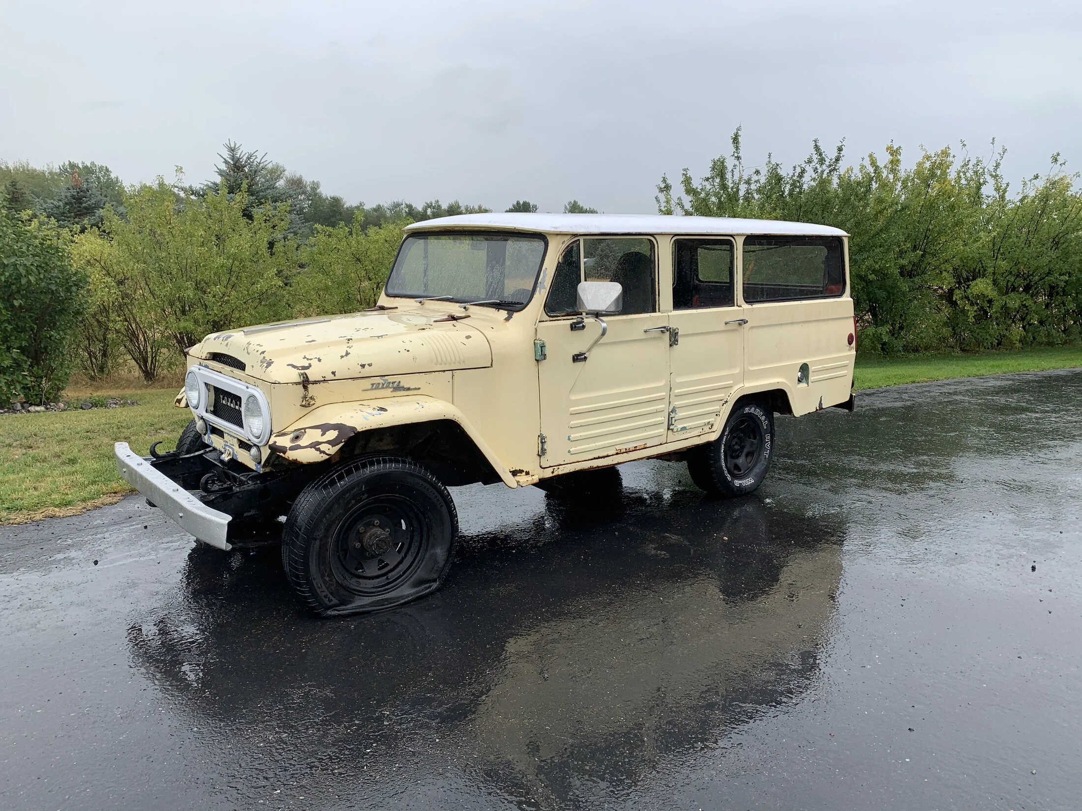

Yota ( the TO feel off on the first, or second rollover) has an electrical gremlin that I could use a little help with. I am looking for a wiring diagram for a 1966 FJ 45. Any help is greatly appreciated.

View attachment 3615821View attachment 3615821
Hello, Nice looking Cruiser. You should start a thread about your Cruiser, or ask questions in the FJ45 Club Owners section.

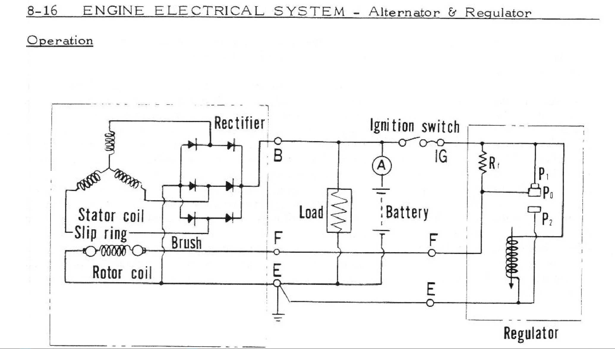

I have a more detailed diagram in a manual I have at home but, I also have a saved PDF version of the "F-Motor" manual. Here's a diagram of the alternator/voltage regulator circuit. You may want to take a look at the continuity between the "IG" pole on the regulator and the ign. switch. It could be open.

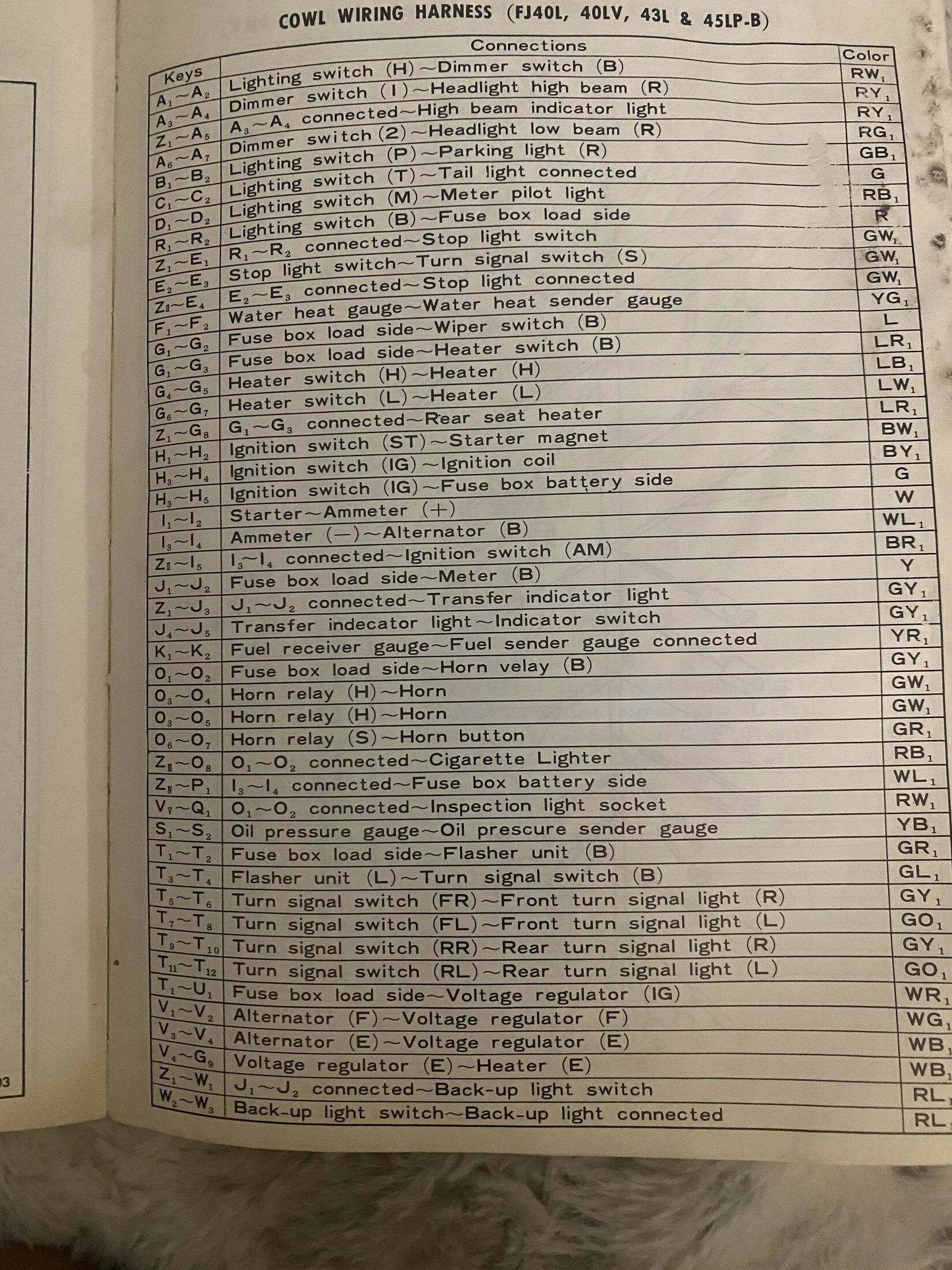

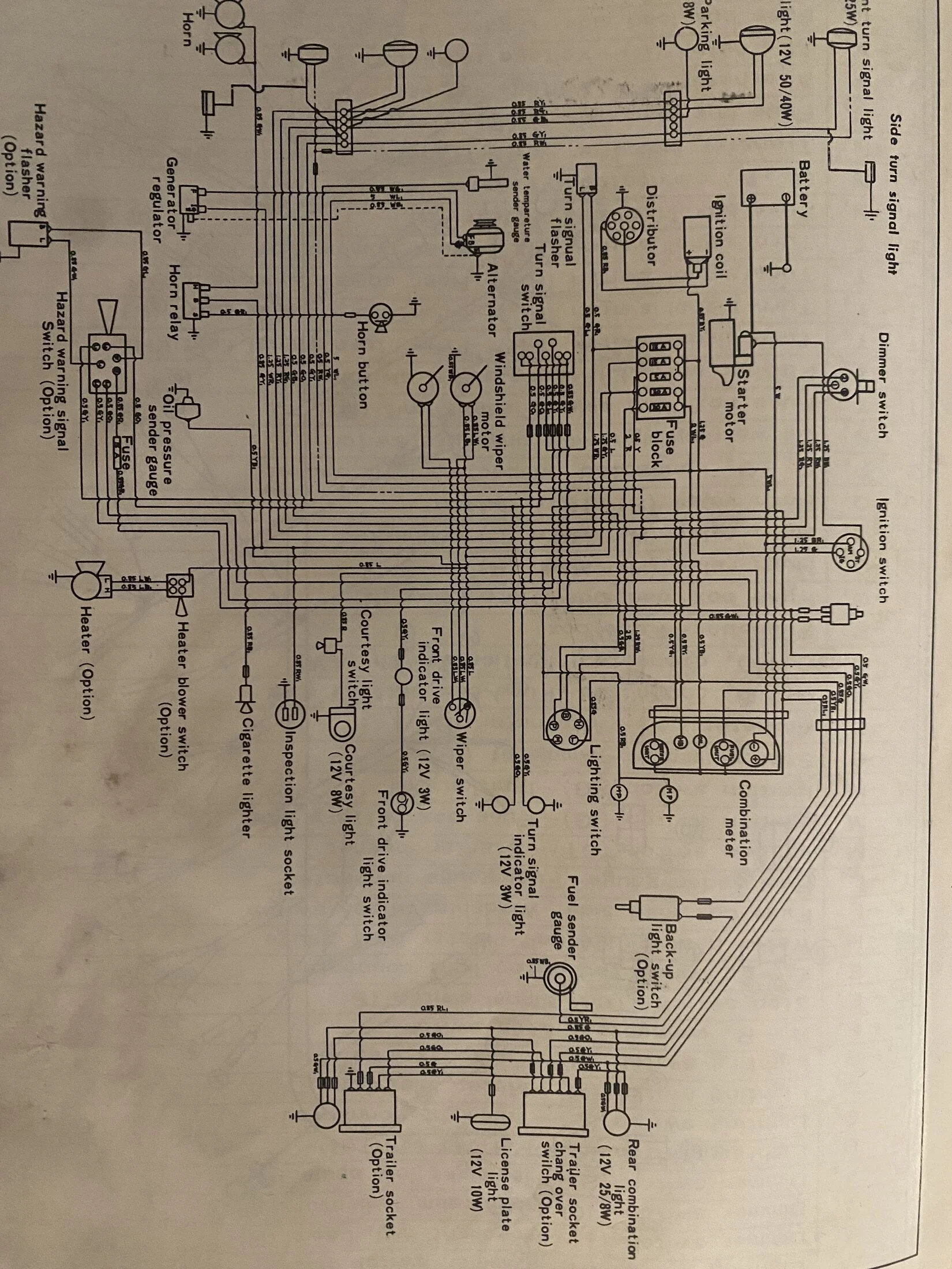

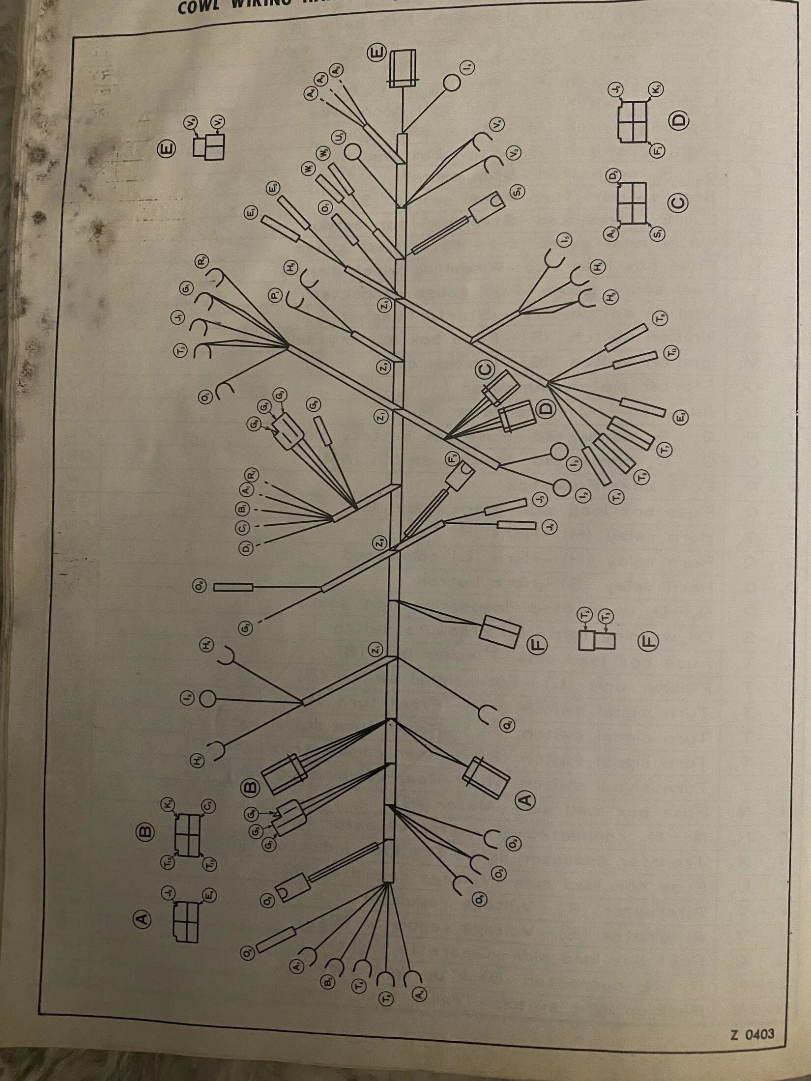

Thanks, any direction may get me to the issue. I’ll check continuity. Do you happen to have a diagram with the color coded wires? Some of the newer models have an inline fuse, I am unable to find one on ours, (there, not there?) your help is appreciated.
I'll check when I get home. This drawing doesn't show color codes. My other one does.
Found these in the manual. Hopefully you can enlarge sections and see what you need:
Howdy Chuckha62,
These help, thank you. Knowing the color of the wires help. The first picture of the whole wiring is a big help, do you know what year that is from? I have a lot less in my vehicle. I don’t have any trailer light stuff, no hazard warning lite stuff, no backup lites, no cigarette lighter. In one sense it’s easier because they aren’t wires there to follow but where do the wires that I have, connect to? Example: on the lighting switch, the ‘L’ post on the diagram goes to the trailer stuff, I don’t have any of that so I am not sure where the ‘L’ green wire goes on my vehicle. I’m going to pull the alternator to prove that it is all good.
What bugs me is, why no headlights, heater switch, wiper switch, starter motor does not turn over but can be jumped access the start solenoid and the engine will turn over. Like a fuse or a short. I have been looking for maybe a sneaky little rat the may have chewed into my wires. If I don’t answer back right away I may be traveling or it’s raining and I don’t feel like getting wet, like it sometimes rains in the northwest.
I do not know the year, but I'm thinking maybe 1967. Reason being that the vast majority of this is a dead-on match to my '66. The only exception being the emergency flasher, which wasn't standard in the US until '67 (but may have been an option in '66, I don't know).
