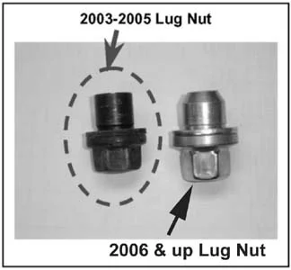

when I bought my 96 4runner it had new wheels...I dont like the looks of them but they are new none the less...well when I removed them to check the brake lining I noticed that the lug nuts were only contacting 3-4 threads on the studs...like 1/4" -1/3" of an inch...this does not make me feel good inside...I was thinking it should be a lot more....what do you guys think? I dont know what the stock set up looked like...TIA Garth:bang:
3-4 threads is NOT ENOUGH!!!!! Take a lug nut to your local parts store. Tell them what you have going.
You likely have acorn lugnuts,
but need lugnuts with a longer shank.

i have a full set of the stock style with shank will trade you for the acorn ones if thats your problem. just pm me in thats the case
hey SLOW...I will...do you have a pic of what I need for a 96 4runner? the pics abouve are not for my year....Garth:)
i have the stock lug nuts off my 99 runner, just like the ones in the pic. i swapped everything over from my taco IFS to the runner when i did my SAS and now have no use for them. pm me with your shipping info and i will send them your way.
edit: dont worry about paypal or anything, just use the box i ship them to you in to send yours back to me to the address on the label
