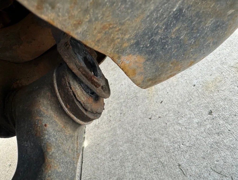

I've had horrible luck and some major failure with the Superpro Offset LCA's.
I purchased a set that wore out the lower bushings at ~30k miles. Superpro warrantied them, only to have a catastrophic failure of an alignment adjustment bolt ~20k later.
Original bushing failure:
Arms installed ~6/2020
Failure 6/2022
Broken bolt failure:
Arms installed ~12/2022 (6-months for warranty replacements to arrive)
Failure 5/2024 - Reported to Superpro, they never responded
I highly recommend avoiding Superpro.
-Rob
Are those bolts Superpro bolts or OEM Toyota bolts? Never heard of a OEM Toyota bolt snapping. I used some new OEM Toyota and re-used a few of my original bolts when I installed the Moogs.
IMO - despite being a Moog customer - my default recommendation are OEM Toyota bolts. May not be worth rolling the dice with a safety-critical part like a LCA to save a few hundred bucks.
They are Superpro hardware.
-Rob
-Rob
Gotcha. They look like very cheap cast bolts as opposed to something stronger. From having cut thru the OEM Toyota bolts to remove LCAs in two separate vehicles, they are extremely hard steel and don't have a "grain" like those Superpro bolts do.
Yesterday I sawzalled thru a W8x24 house beam (1/4" steel I-beam, 6.5" wide flange and 8" tall) in about half as long as it took to cut thru a single Toyota LCA bolt. My blade was still good at the end - those Toyota LCA bolts would sometimes kill a blade or two per bolt.
