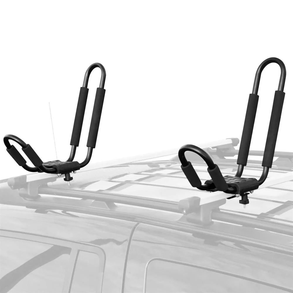

2. I have kayaks that I use quite a bit during the summer, with Thule racks like the ones in this picture. It clamps onto the stock elliptical cross bars. I'm not opposed to a separate bolt on crossbar that I'd use when I use the kayaks.
