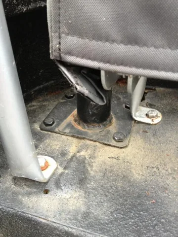

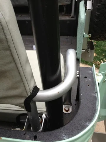

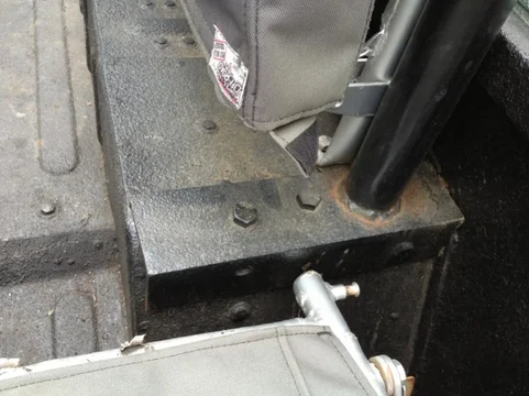

Hey Mike, I have been following your thread and happy to see you have some resolve with your fuel issue and are able to get down the road and return. I am also glad to see you have been working on other tasks while waiting for your carb. I have been doing the same thing on my 67. It was originally Spring Green and my wife's uncle, who had before us, changed the color. I'm okay with the beige but like also like the green. He had just about everything inside except for the steering wheel and dash cluster painted the same beige color and I have been slowly repainting everything back to pewter. I also dig your roll cage. I have always wondered how one could be installed in a 7 passenger 40 with the larger jump seats. If you have some spare time, would it be possible for you to take some photos of the mounting points both front and rear? I'de like to see how they were tied in. Thanks in advanced and I wish you well with your rig...Steve
That's a great looking 40. I'd have a tough time choosing between spring green and the desert beige if I had to.
Here's some shots of the cage mounts around the seats. There are also a few from Jamison's build threads that you can find linked in my first few posts. He found a very clever solution of dropping the rear bar straight down between the arm rest and the seat. This lets the seat be about in its regular position so it's not jammed up in the back of the front seats. Let me know if you want more pics.

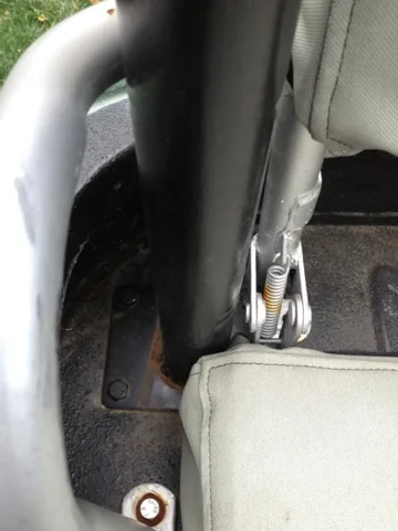

And here's the mount at the front of the seat.

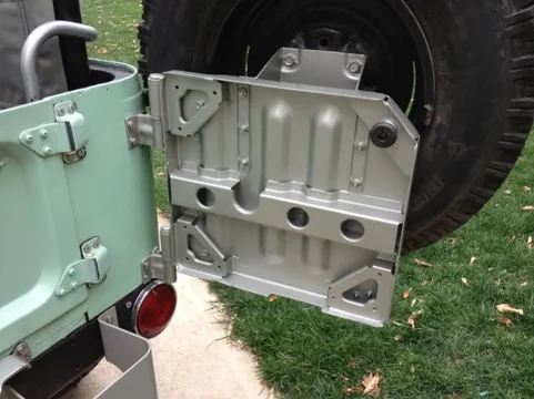

And yes it is nice to get little stuff done while you wait on the big. In all my excitement about the carb I forgot to post a pic of the refinished tire carrier. It's not perfect but not bad for a first attempt.
Mike, thank you very much for the photos. Exactly what I was looking for. By the way, your spare tire carrier turned out fantastic compared to what you started with. Did you have or did you create any drain holes in the bottom corners? I am going to remove mine, blast it and repaint or powder coat as there has been issues with standing water in the corners. Keep Cruisin'...Steve
