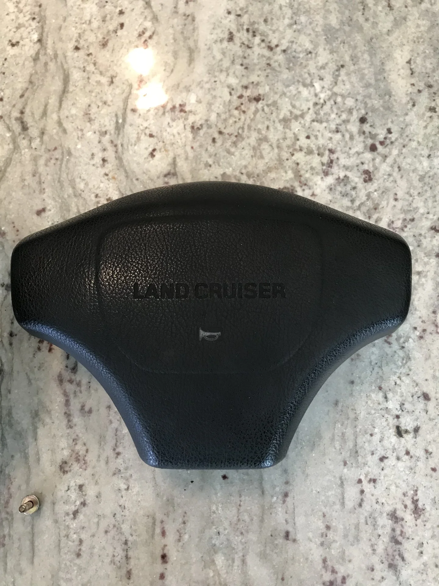

Good morning! I am looking for the center section of the early FJ80 steering wheel, my horn does not work and I assume it is the structure of the center section of the steering wheel that is to blame.
Picture of what I am looking for...
Could be worn contact pin. A new contact pin fixed my problem.
84312-12040
