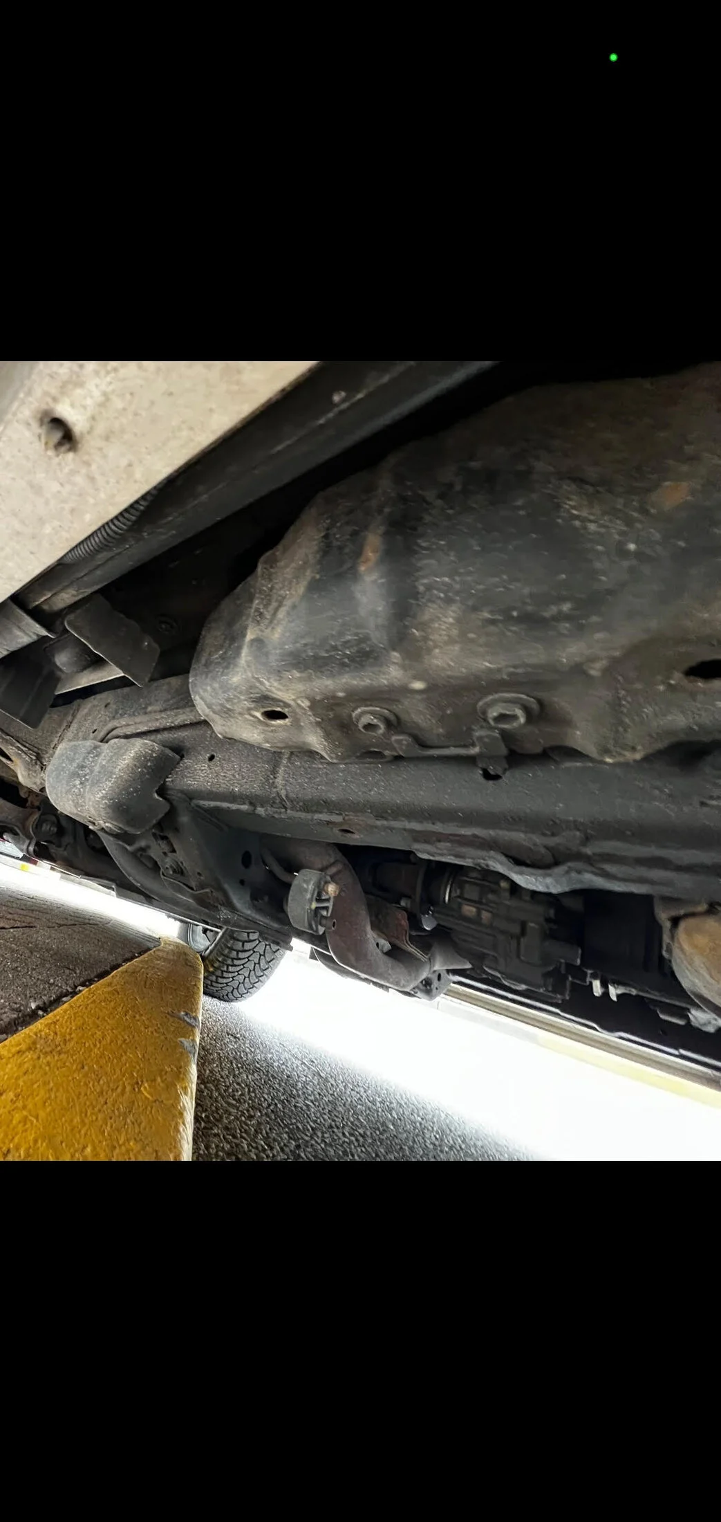

I went through the photos my wife took and I found this one that she just happened to capture. From a Canadian perspective there is VERY little rust on the vehicle for having 210000. This is a result of yearly undercoating. To me, i see an indication of a leak in the seepage around the bolt holes. This very well could be from undercoating coming through or just my imagination. Unfortunately, sending my wife to take the cover off the guy's vehicle is not really an option i dont think. She is capable, but i doubt the guy would be okay with it.
Wow! That's cleaner than my So. Cal GX!
