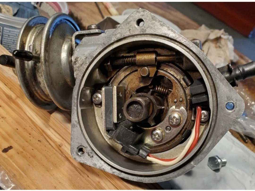

FYI, Not sure if you're looking for oem, but, the oem distributor for the 79 US model is an electronic, small cap distributor with a 3-point base, paired with an early-ish (79-80) igniter, coil and embedded (pink Yazaki) resistor wire.
I'm in the process of upgrading to an FJ60 large cap setup on my 79 FJ40 and have pulled the oem components (distributor, igniter, coil, yazaki). The distributor had too much slop and the igniter worked but didn't pass all the FSM tests. I got tired of messing with it and am opting for a later oem model. It's a bit of work, but hopefully it will pay off.
In any case, here are some pics of my oem 79 FJ40 US components for reference. If you don't need year-correct oem or even electronic you have lots of options.

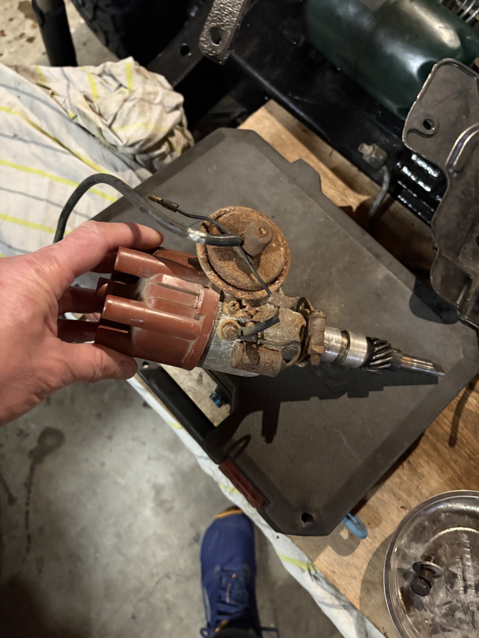

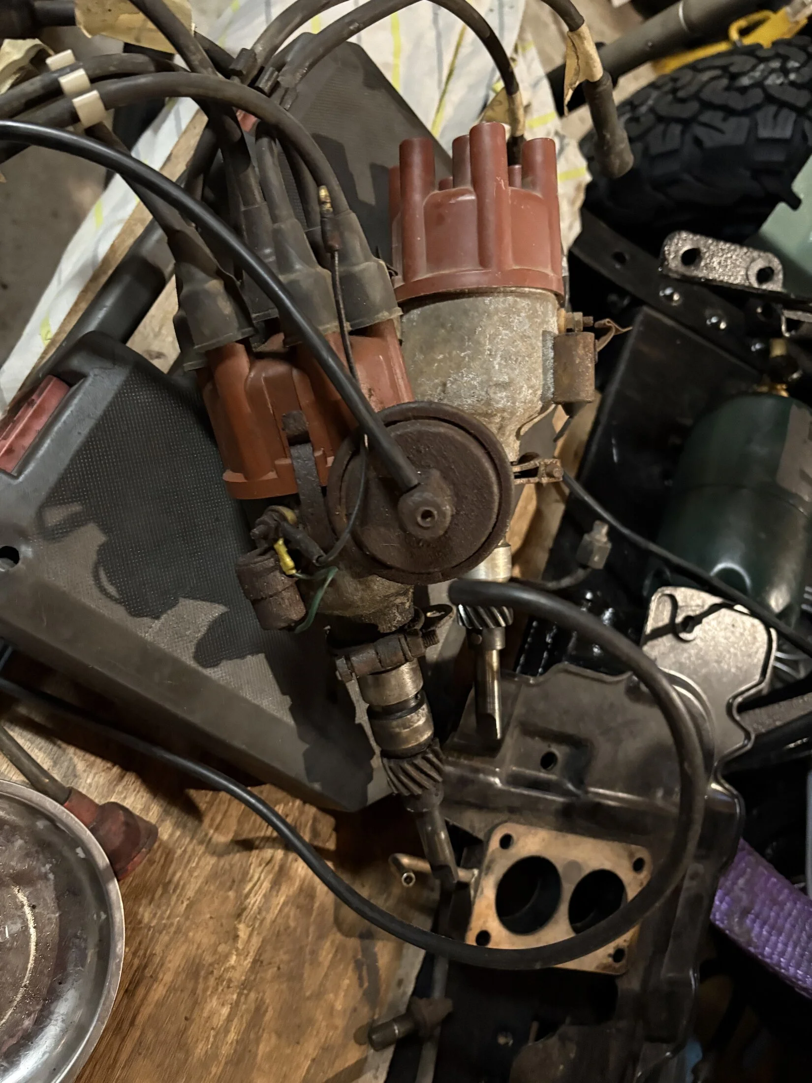

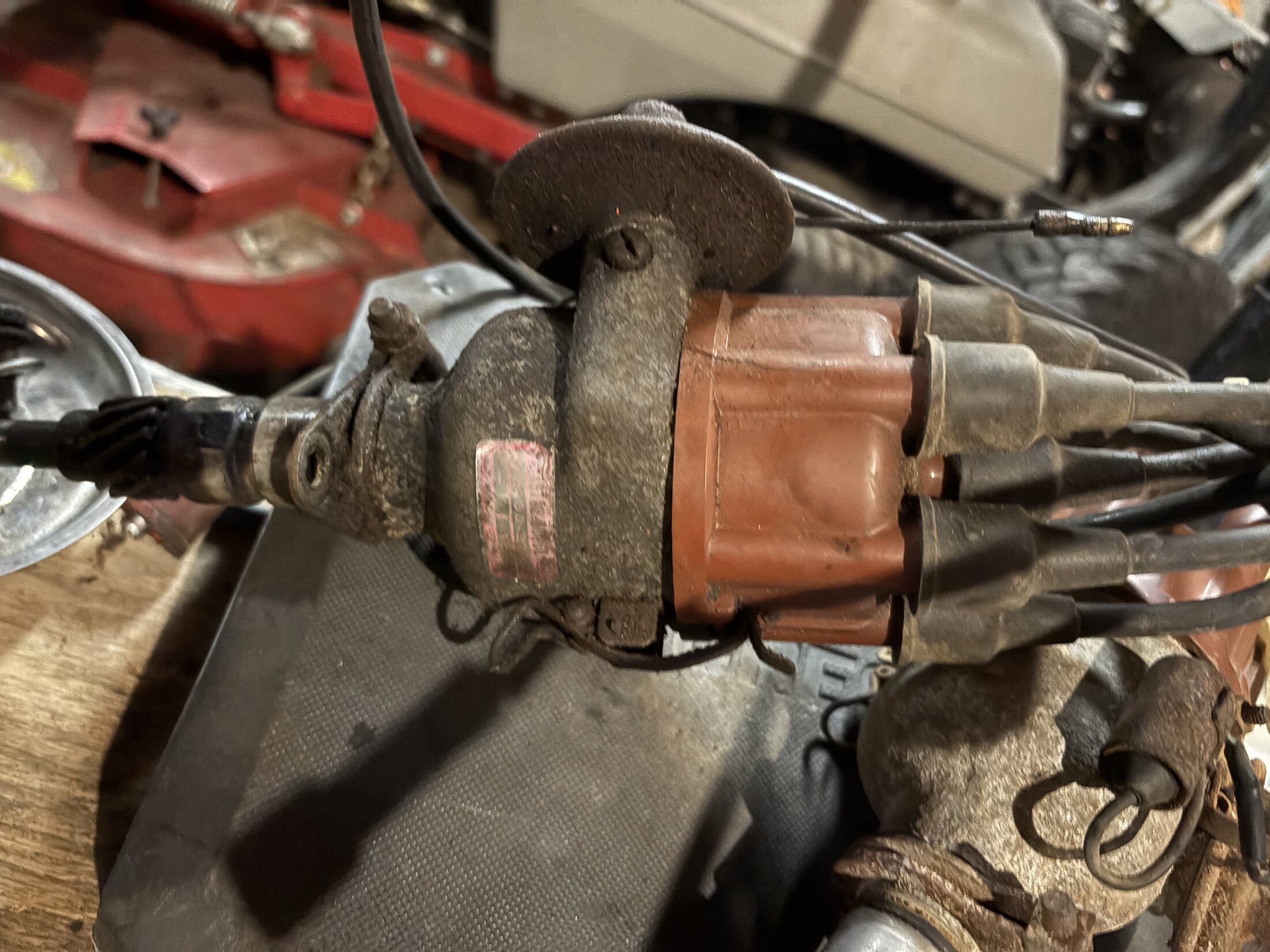

Sorry for the delay. Here is what I currently have. One came from a 1970 and one from a late 1973. I will be running a 2F made 1/09/1979 and an Aisan carb from 1985. Not sure if the 2F is from a 40 or a 60 but my wiring harness is from 12/73. If you have any recommendations please let me know. Thank you!

The Johnny Cash description helps.
Those distributors you have appear to be mechanical points type. You might pop the caps on those distributors to confirm that and to see if they are serviceable (lots of threads to help eith that).
If yes (points type and serviceable), you'll want to look on your shelf for a coil and ceramic resistor to feed it.
If you can't make any of those distributors work properly, there are lots of available options for new or used.
Either way, have a look for your coil and resistor, and go from there.

I just realized that the distributors in the photos appear to be vacuum retard distributors.
You may want a more common vacuum advance distributor to work with your newer carb, but you could probably use one you have for now.
Oops, one more consideration. I just noticed that the distributors in the photos appear to be vacuum retard distributors, (not common). Not sure about compatibility with your newer Aisan carb.
I think you'll want a more common vacuum advance distributor to work with your newer carb.
