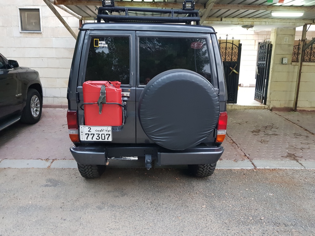

looking at 70 series tomorrow any tips?
dam you all. got me rethinking this.
and that's my 80 on the far side in one of the pics.

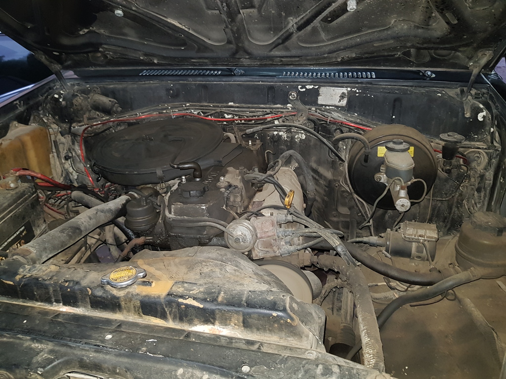

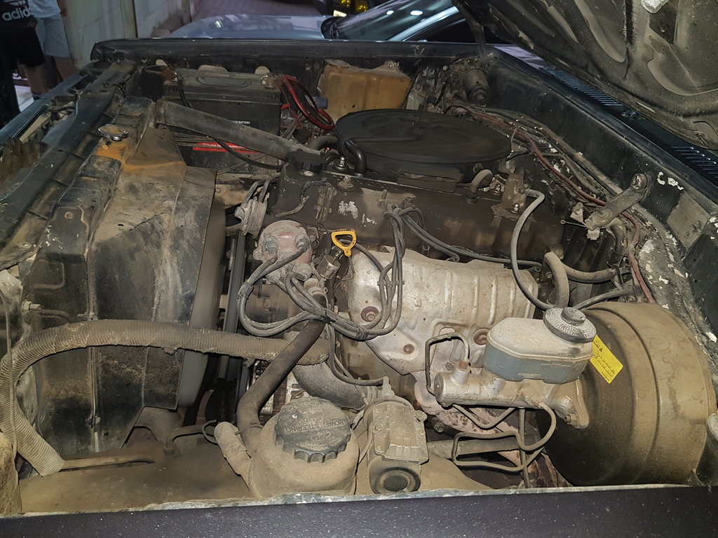

Looks like transfer case output seal is bad. I would put that radiator cap on all the way and run it. It looks like rusty nasty water stains and it might be loose to reduce pressure(leaky radiator or head).. my 2c but all of it is easily fixed if you are good with wrenches

I would go over the engine very carefully, it may be ok, or at least good for a year or 2. Those t/case are not hard to rebuild. It looks fairly unmolested, just neglected as you say.
