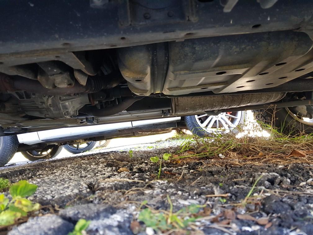

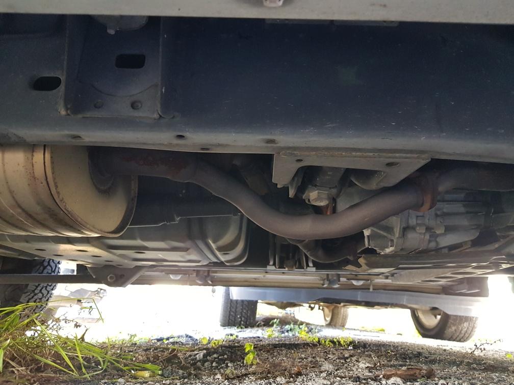

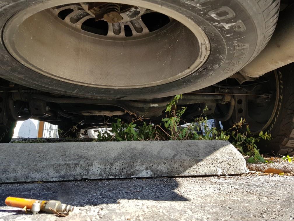

Hey everyone! After having our third kid I need something a little bigger than my six-speed hatchback. I stumbled across the 100 series and liked the idea of a big SUV that could last upwards of 300k miles. Plus the wealth of resources on a place like this is a huge incentive.
I found an 05 LX at a dealer in another state. It has a clean carfax and has always been serviced at the Lexus dealer. Just had the timing belt done in the last 15k miles and is just under 200k miles, so it checks a lot of boxes. It has been in the south its whole life but on the coast. I asked the dealer for some pictures and got these. They aren't the greatest pictures but give a rough idea. The side rails look ok but there is some rust on the front skid place and it looks like some of the frame behind the skid plate.
Would anyone mind weighing in on if this is something to be concerned about or a normal level that could be cleaned up? If it doesn't seem that bad I'll have a local mechanic give it a fuller look over. Thanks in advance and hopefully I can join the ranks in the near future.
What rust? This thing is pretty damn clean. The spots that even look like they are coming close to thinking about rusting can be managed with wool wax, fluid film, etc.
View attachment 3222466View attachment 3222468View attachment 3222469View attachment 3222467
Regardless of Make/Model and location, this thing is essentially rust free. Nothing to be concerned with at all.

As noted , rust is not an issue here. This is a beauty of a 100 series. In a perfect world they would drop that rear tire so you can check the back end. Some people use these rigs for boating and the rear end may have seen salt but otherwise it looks great.
Shift your attention to maintenance history. Yes these rigs, especially the 2UZ motor, are extremely dependable but that doesn't mean they can go for 20 years of neglect and expect to get to 300k. Dealer service history is a big plus.
With that being said you may find yourself going down the rabbit hole we all go down as you start to swap out old parts with new to ensure another 200k , and that can get spendy but these rigs deserve it.
Take some time to check over fluids ( take a sniff of the trans fluid and look into radiator for clean pink / red coolant ) Timing belt recently done is a huge plus .

I'd like to pop that front skid plate off and drop the rear tire to get a full view of the underside . The reality is it's a high mileage truck so you take a bit of a risk but this is one of the few vehicles worth taking the risk on. Maybe the dealer would let you dive into it more before purchasing or maybe that thing will sell before you have a chance to get down there.
