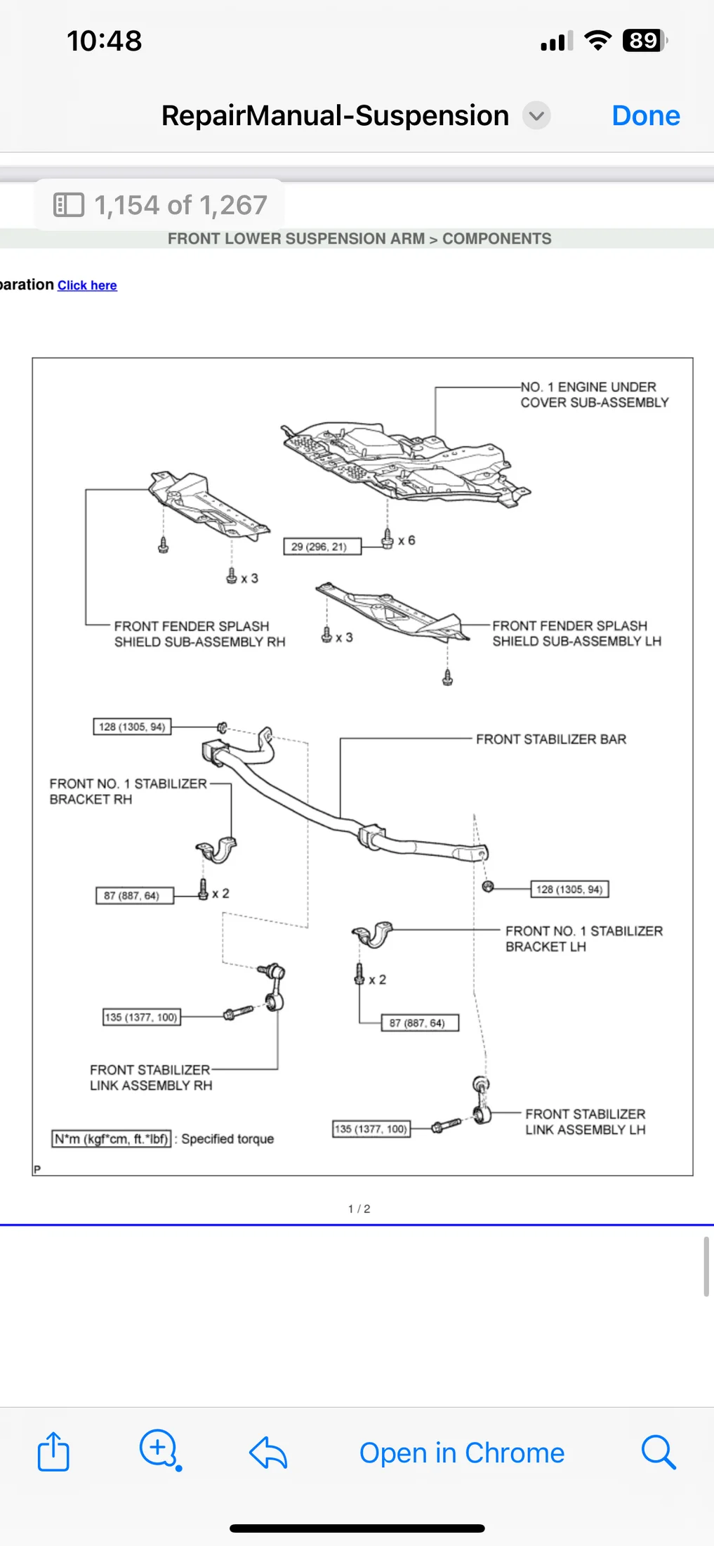

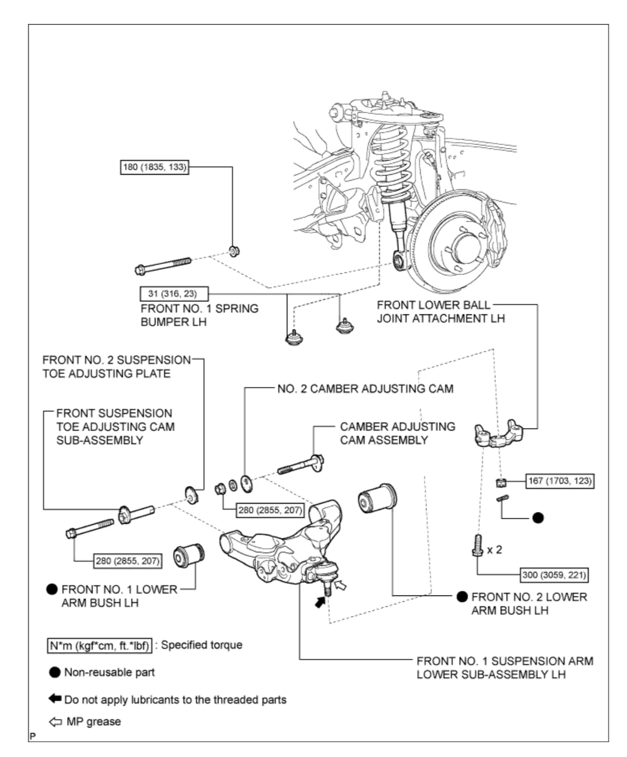

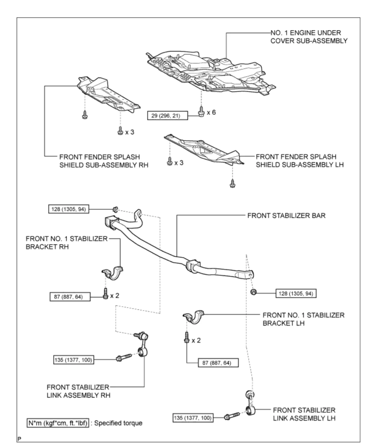

I have all new LCAs, Sway bar end links and inner and outer tie rods installed. Struggling to find the right torque specs though to button it all up and get back in the road.
Aha! Found em. Hope this helps someone swear less one day.

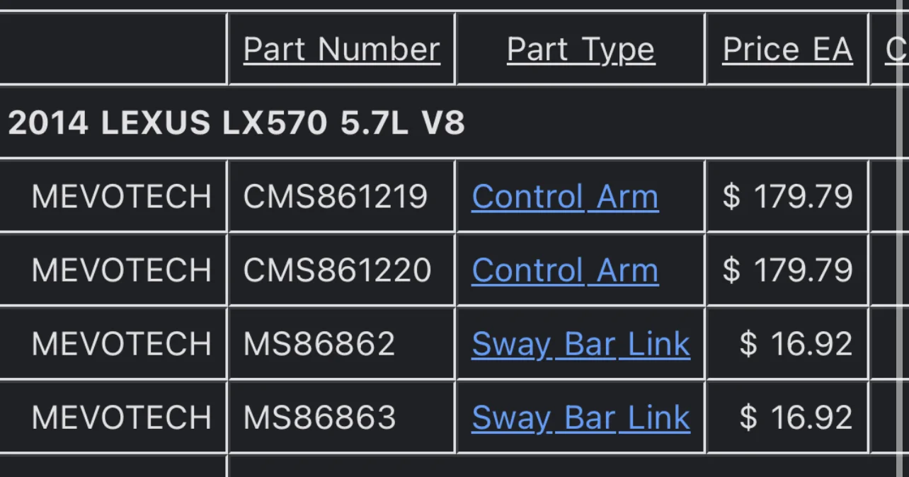

I actually bought mevotech supreme LCAs from rock auto the night before the tariffs hit. Now $210ish I think.
Time will tell how these hold up. Plan is to replace bushings and get a 555 BJ in the old OEM arm to swap it back one day. Atleast I’m back on the highways now without vibrations (although a butt clencher first round around the block as I may have forgotten to tighten the lug nuts properly, wooops).
