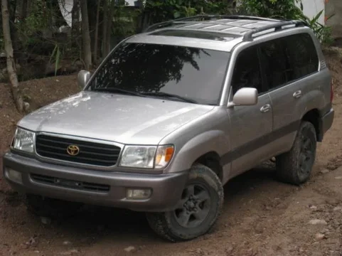

Just bougt this 1998 LC with 180K on her here in MX, but it is not a beauty queen by any means, this is my second LC that I'v owned. Just glad this was not the first one I'v owned.
Currently I reside in PV Mexico for now, have traveled through MX numerous time in the past years. I ended up buy a home here and am planing to stay here indefinitely.
Before buying this LC, I found that this LC has minor issues' . This LC was in a minor fender bender on the passenger side as the front bumper cover/fender/two passenger doors were repainted and missing the front lower inner finder splash shields on each side. The repair was not done very well at all, but the frame and core-support was never compromized from this fender bender.
The wind shield is an after market and it is cracked and chipped and might be leaking.
