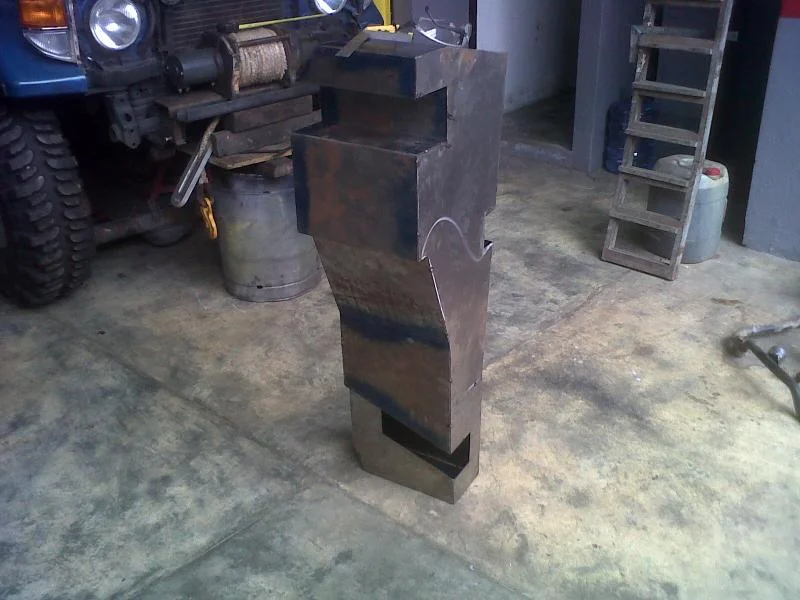

I fab my onw aux gas tank its hould 87 litres but you have to move the Exhaust system. I goin to take some pics I can give the plans

here is the pic still in process but almost done. I going to put de pump inside of the tank because I put a 1fz efi engine
