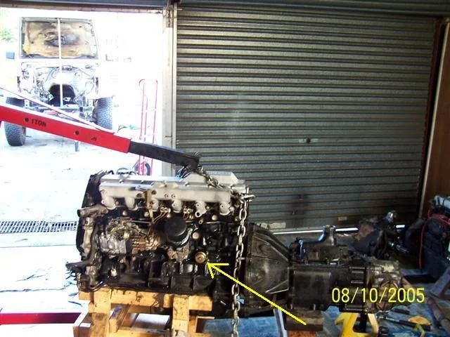

Hey Mudders,
I am looking to install my new oil pressure and oil temp gauges, and not count on the stock pressure gauge that is not accurate.
Is there a place on the block or anywhere under the hood where i can plug or screw in a sender unit for my applications without having to tap?
Thanks guys, and info would be helpful. Pics or diagrams too.
Cheers
staying in the front of your 80 series on the right hand ( IP side ) just between youur IP and firewall about 6 inches down you will dounf the oil press sender ..
It's more easy to see and have acces from down the cruiser ..
You could maybe fit a T piece in there and run the factory gauge as well as an aftermarket gauge.
Te sender is common to about 30 toyota models,petrol and diesel
