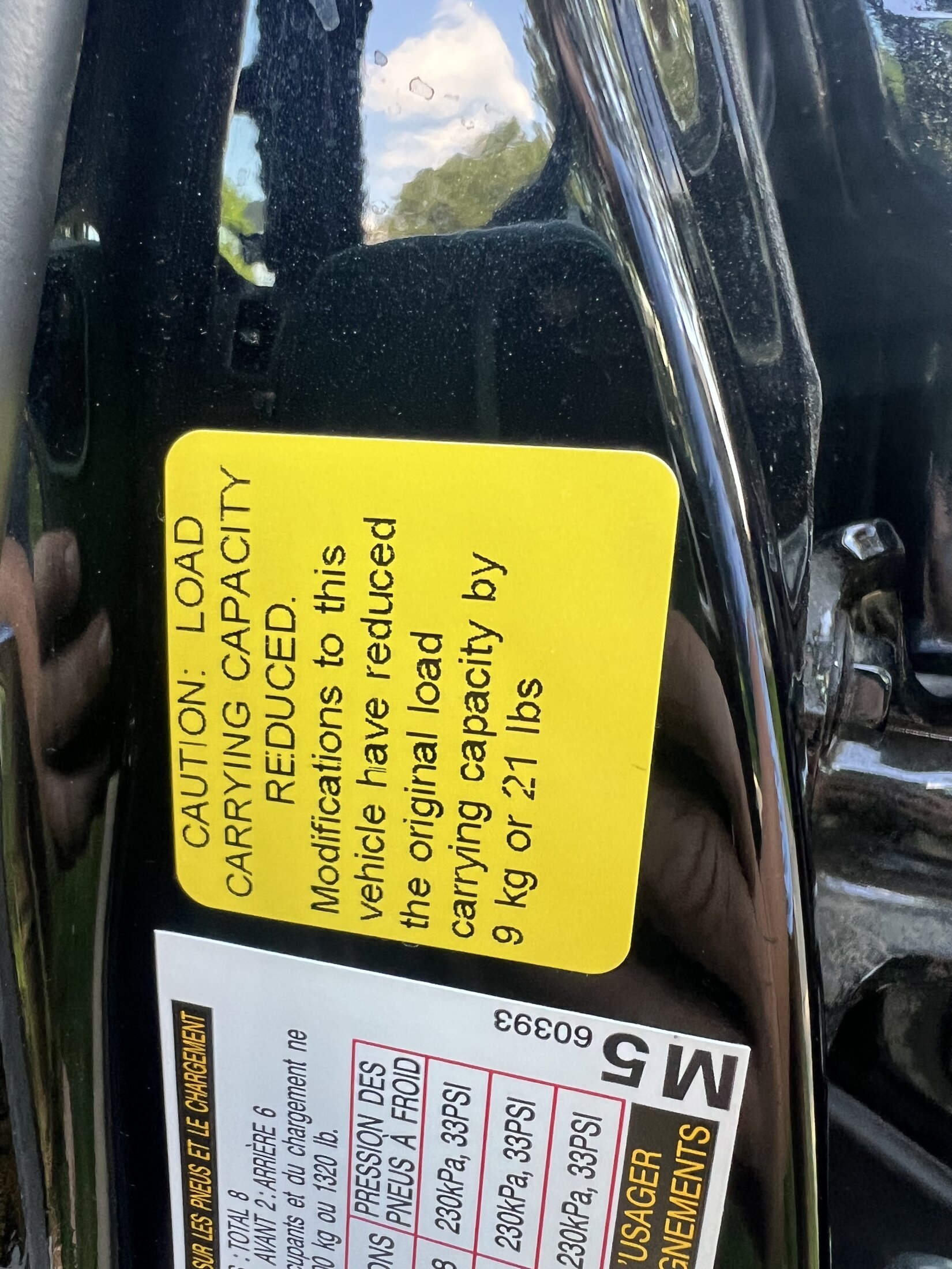

Is this a common sticker? As far as I know, my 200 is stock…

sticker: probably port/dealer installed options like mats/screens.

Weird , no screens. It’s pretty stock.
