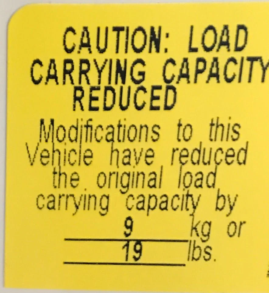

Inside the driver's door of my new 200-series LC, I found the above sticker, indicating my LC's load carrying capacity had been reduced by 19 LBS. Any idea why? Thus far, my vehicle is stock, and has not been touched by anybody besides the dealer or myself.
That sounds like something the port or dealer may have added; what are the options on your truck (if any)?
These stickers crack me up. What complete nonsense.
My LC is "box stock" - except for the special color and the floor liners & cargo mat. Could this addition have created the need for said sticker?
I also have that sticker, and when I investigated with my dealer we came to ther conclusion that the added weight of the rear entertainment system - which was added AFTER the vehicle came off the assembly line in Japan - was the reason behind it. It was our understanding that the standard door label listing GVWR, etc. covers all items on the vehicle at time of manufacture. The rear entertainment system, apparently, is not installed at the time of manufacture and therefore must be covered with the separate sticker.
HTH
That lines up with what a member here stated the weight of the PMRS was when he removed it - about 19 pounds.

I found a similar decal on my 2011's door jam. After a search I found this thread. To note, the load carrying capacity is reduced to 24 lbs on mine, instead of 19.
just checking tire pressure and noticed the same sticker. I dont have the rear entertainment and not sure what PMRS is. Anyone ever find out what is the cause of the sticker? Just curious......
PMRS = Pimp My Ride System
