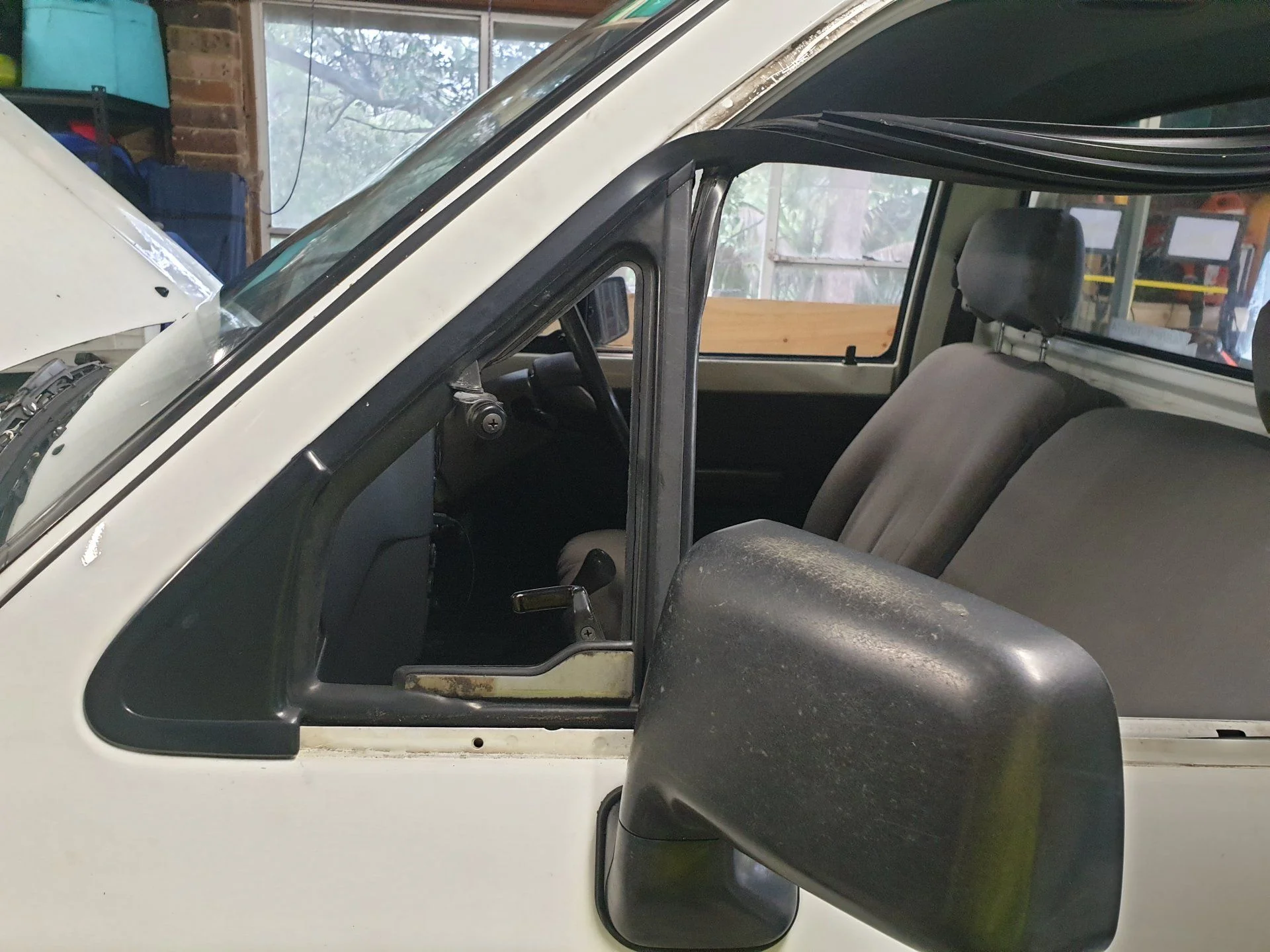

Ive been trying to remove my window in my single cab hilux.
I have removed the door cards, the weather strips either side of the window, etc.
I am stuck at the little quarter window though.
All the ones ive found have been different to mine.
I don't have a full triangle on the front quarter window.
It's got a flat front to it and I'm struggling to work out how to remove it.

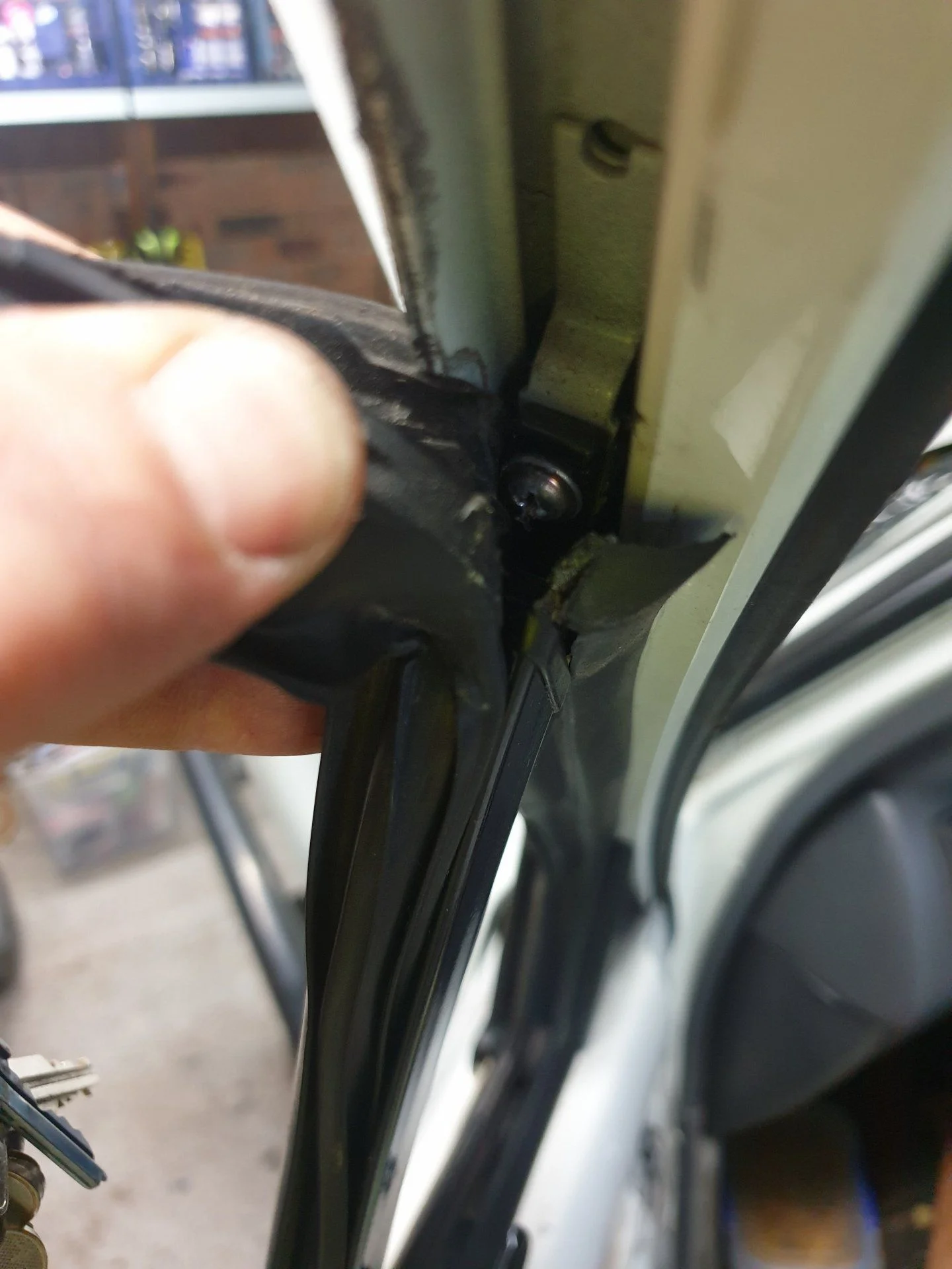

The book says to remove the screws holding it in but I can only get to one of them.
Any help would be greatly appreciated.
I'll try get some pictures up if I can work it out.
the little black triangle on the inside of the door should pop off. Use a putty knife to pry it off carefully. The little tabs that hold it can break pretty easily. That should help with the seal from the inside. Maybe. It is not quite the same as mine.

Thank you for the reply.
That was my thoughts too.
Was hoping there was another way as it is reluctant to come off and im not sure how easy it will be if the clip breaks.
Let you know how it goes.
