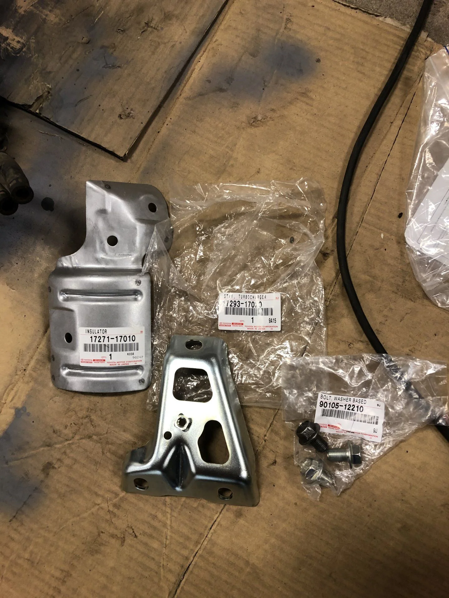

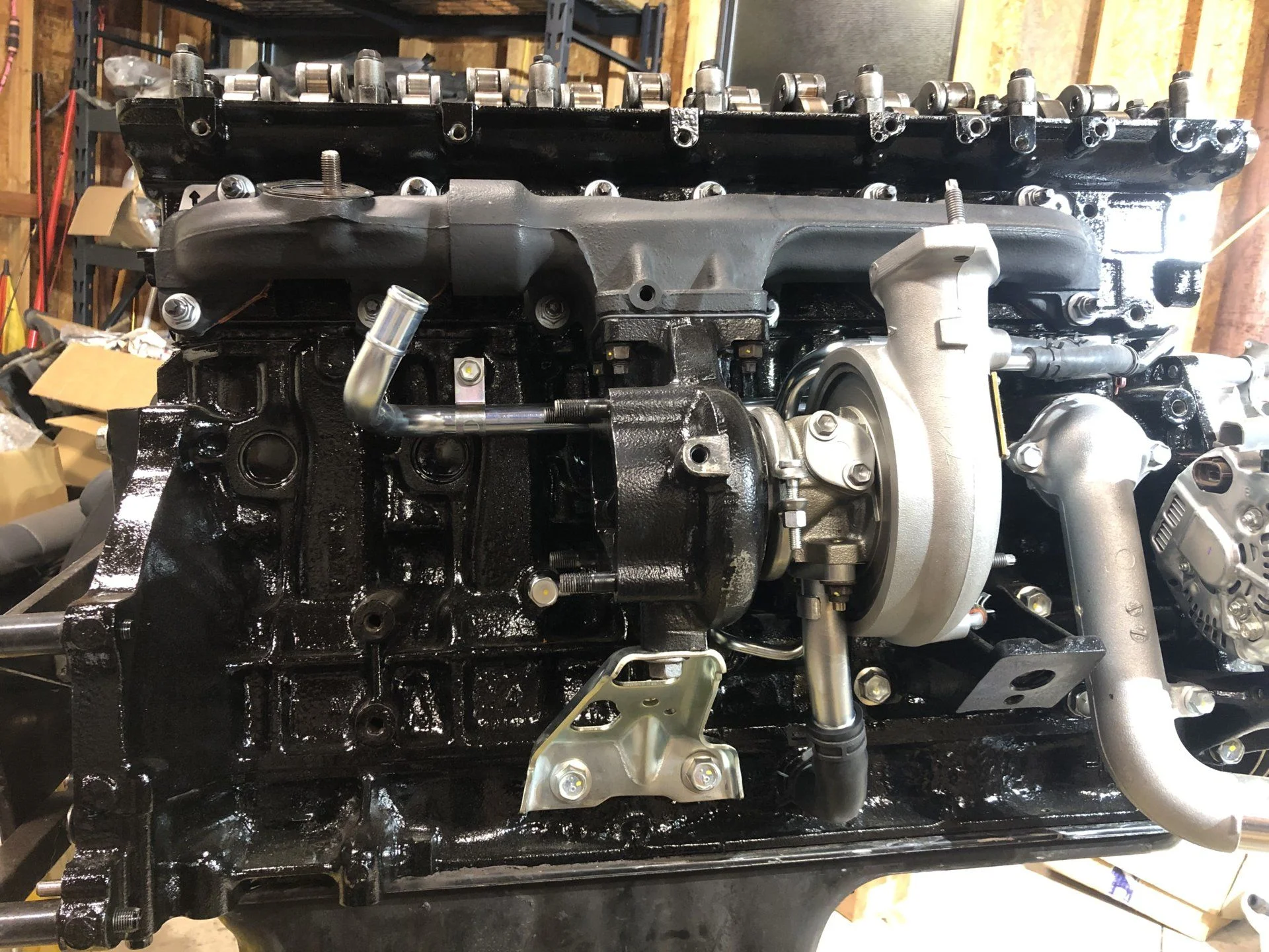

Turbo family pictures:
Two missing part numbers: oil inlet gasket 15471-58010; nuts 94180-40800. Had to reuse the nuts.
I also had to reuse one of the turbo stay bolts.
All together:

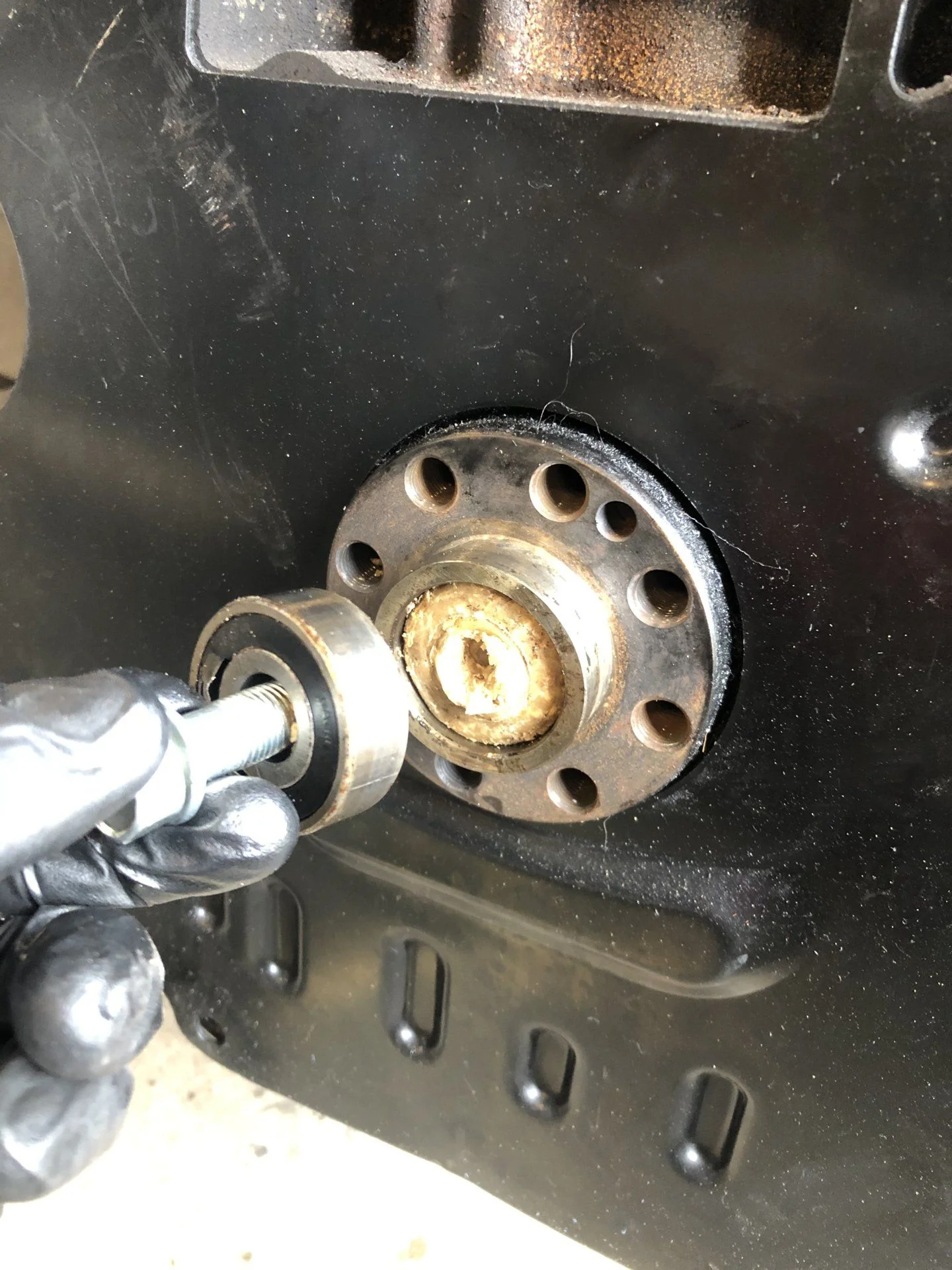

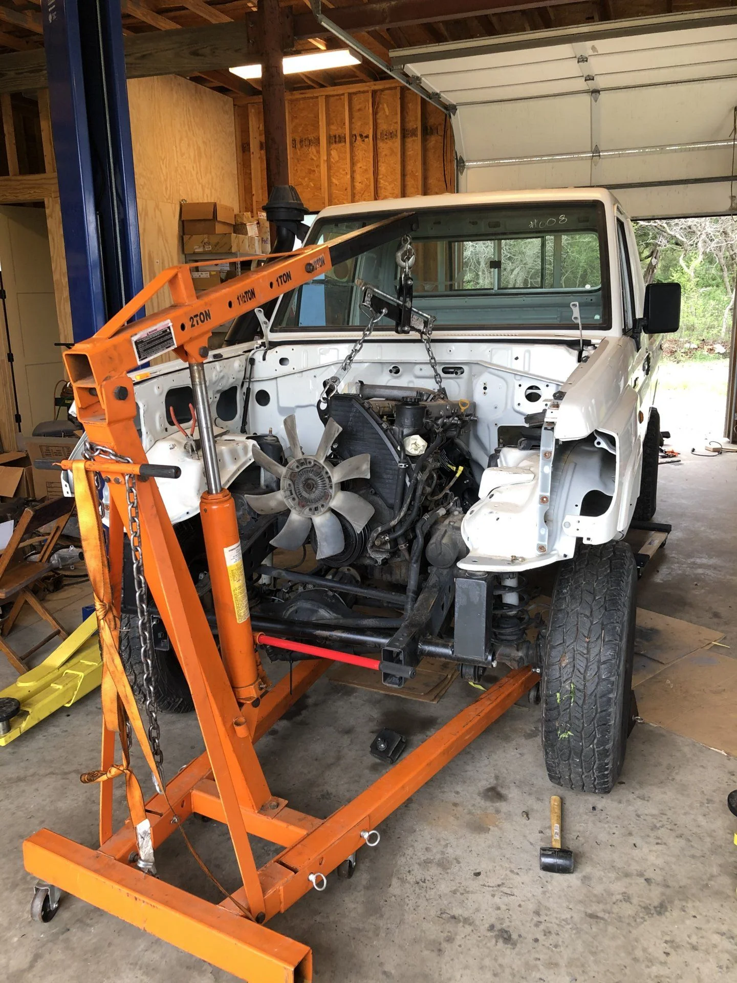

Big day today- got the 79 into the shop and the H151 bolted up to a 1HZ I had in the shop, so I could keep working on the 1HDFT. I swapped motor mounts to make sure they were 80 series, not 70 series mounts, and removed the pilot bearing from the 1HZ with the old bread trick. Time to line things up.

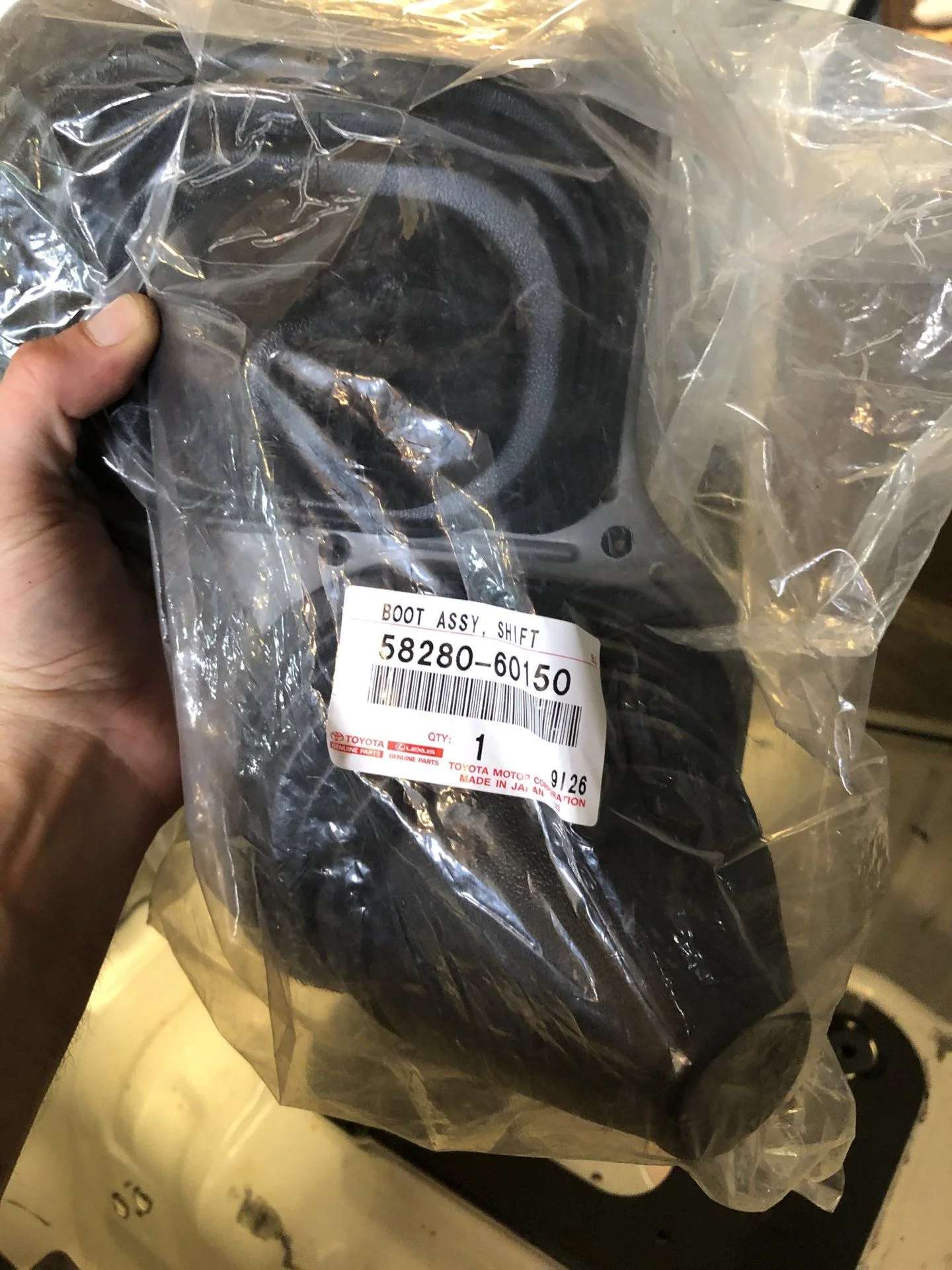

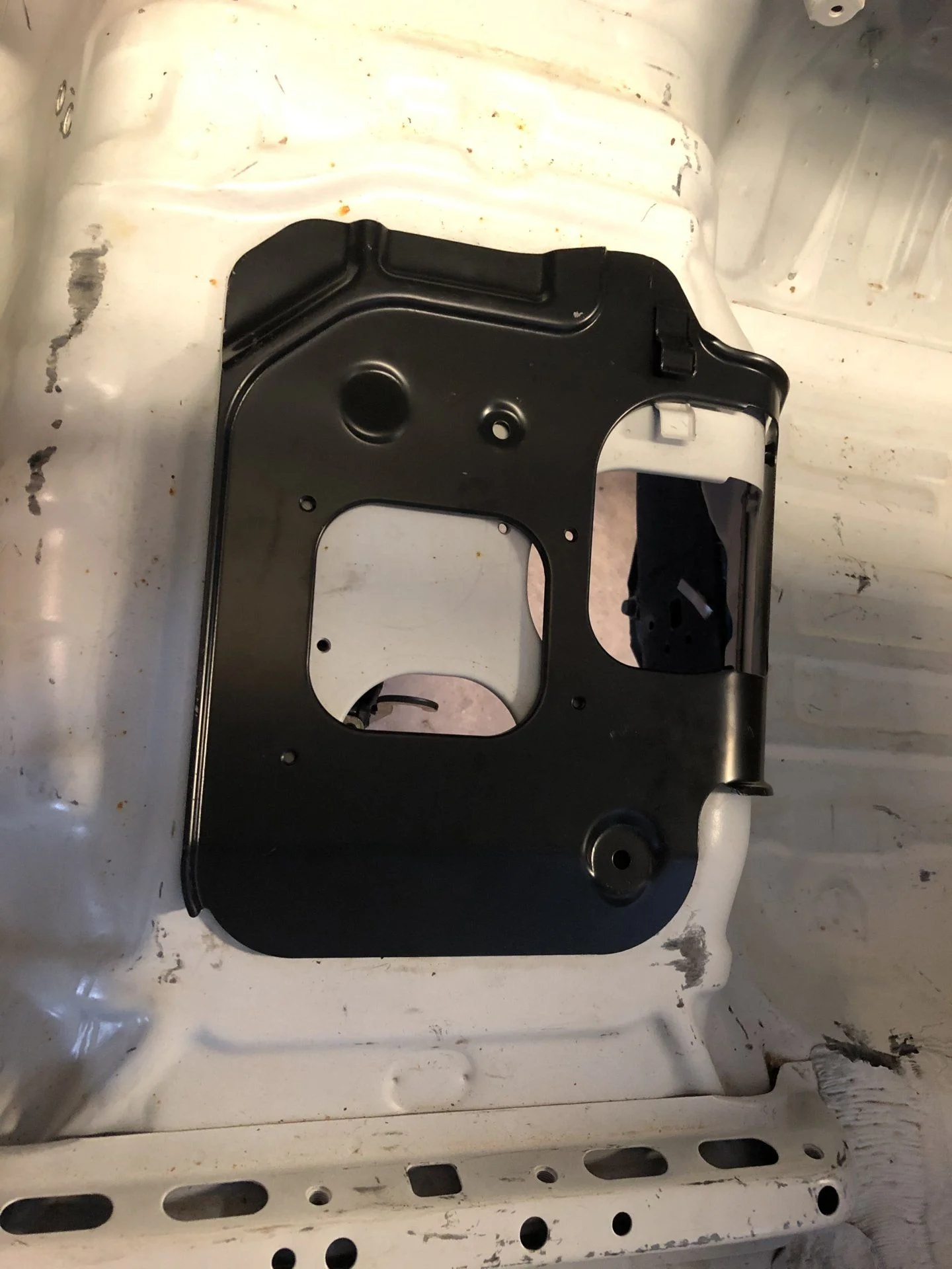

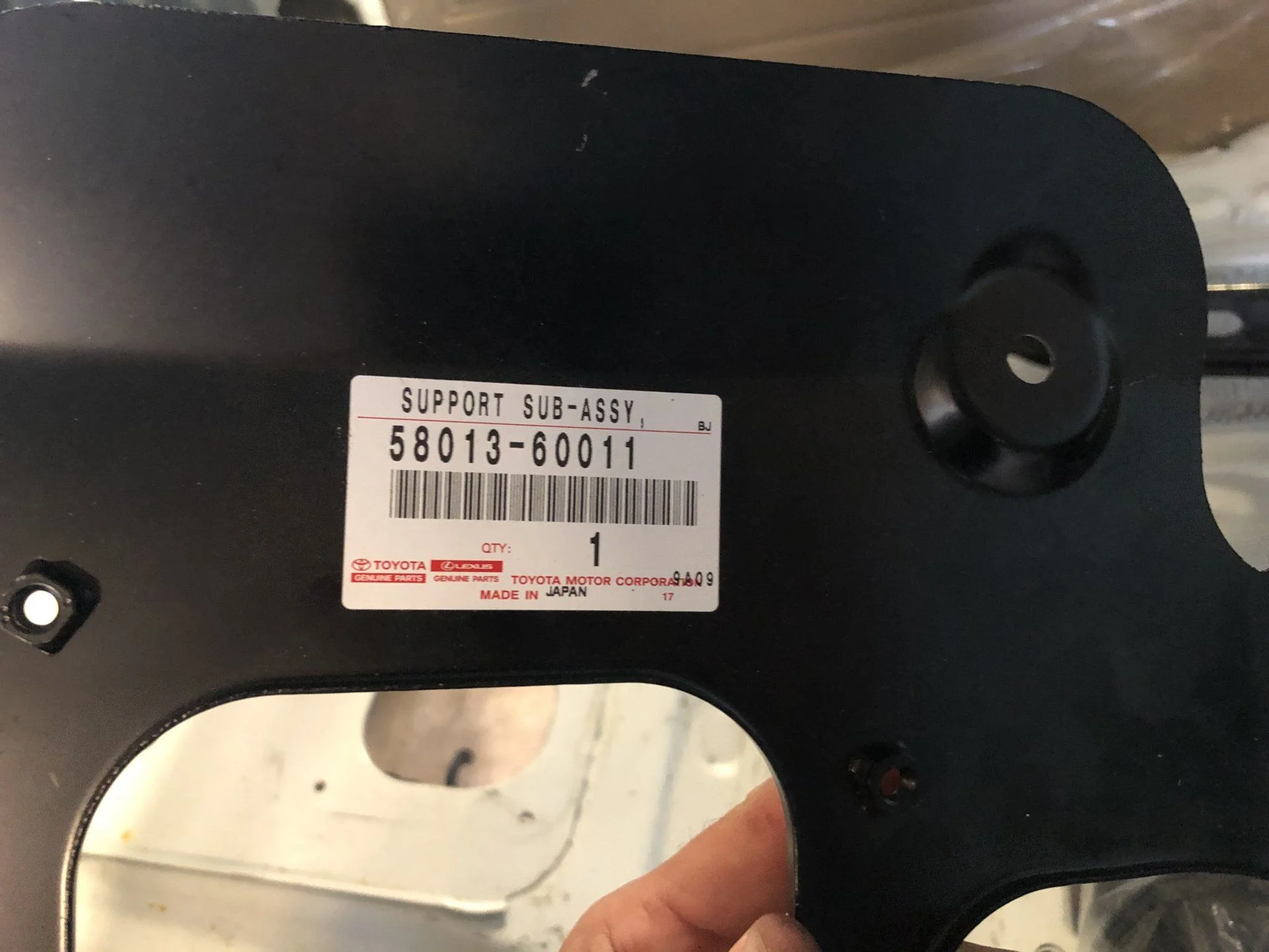

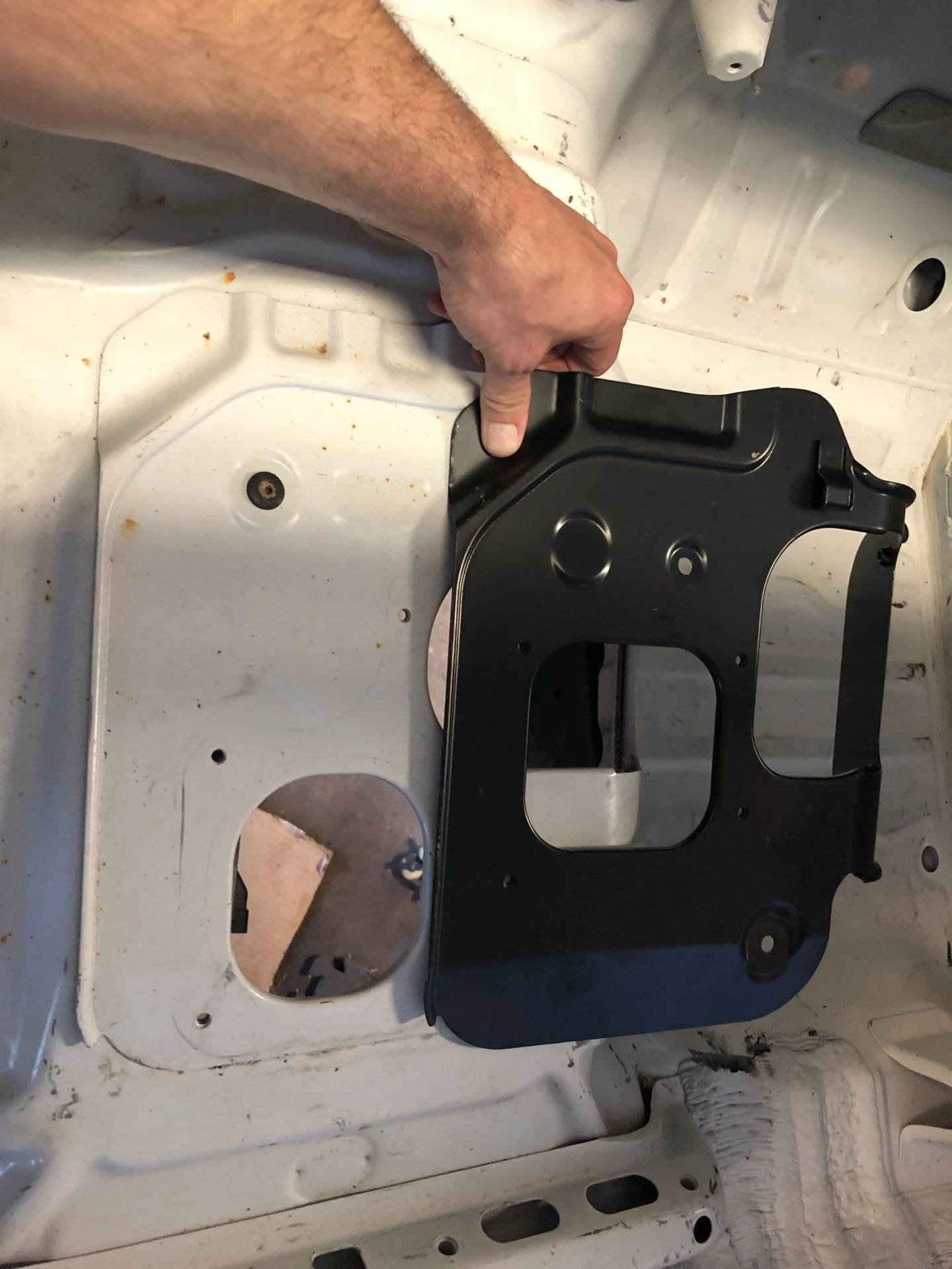

I was only able to get out to the shop for a second, but I found the HDJ79 shifter plate that I had squirreled away. It took me forever to find it in my hoarded piles of parts. Maybe I will have time this weekend to actually localize the engine and transmission.
The correct shifter plate for the H151 instead of R151 really does move the shifter forward about 3 inches. Also, note (what I hope are) the correct HDJ79 shift boots.

Boot looks like what mine looks like.

No, it’s just glued/cemented in place. I need to figure out how to get the old one off without destroying it. Probably a putty knife.
It's spot welded on....you'll be drilling thru about 20 welds I think. Get a good spot weld cutter.
You can glue the new one one with panel bond. We used windshield adhesive(our go-to adhesive) and nutserts to secure ours down. It's not coming off BUT it could if it needed to.
I just found the spot welds 20 seconds ago. Yeah. Time to cut them out.
Wonder why Toyota went that route rather than the bolt in cover that uses a gasket like the older 70 series.
Score on that shifter plate “find”! Your finds ar different from mine. IIRC that gets you really close to the existing motor mounts doesn’t it?
