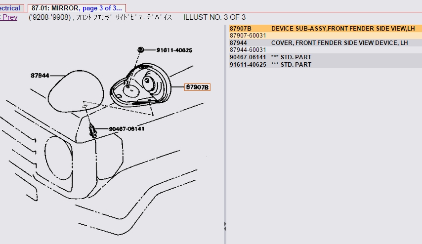

I didn't want to crash Jordan345's thread, I'm wondering if anyone can confirm whether that little mirror pictured is OEM, and if so the part number, and if they come in RH as well.
I have looked, came up with the following and only for the left side, but the associated picture (often not correct) is so different it makes me doubt it
87907BDEVICE SUB-ASSY,FRONT FENDER SIDE VIEW,LH
87907-60031
This is for JDM only.
Japan is RHD so this fender mirror is supposed to be on the LH only. Not available for RH.
Light duty series cruiser has a rounded shape whereas heavy duty series has a squarish shape mirror.
Thanks for the info guys, I appreciate it. I guess I'll just have to find an aftermarket solution to my blindspot as I have LHD.
Anyone seen a solution with an OEM look?
