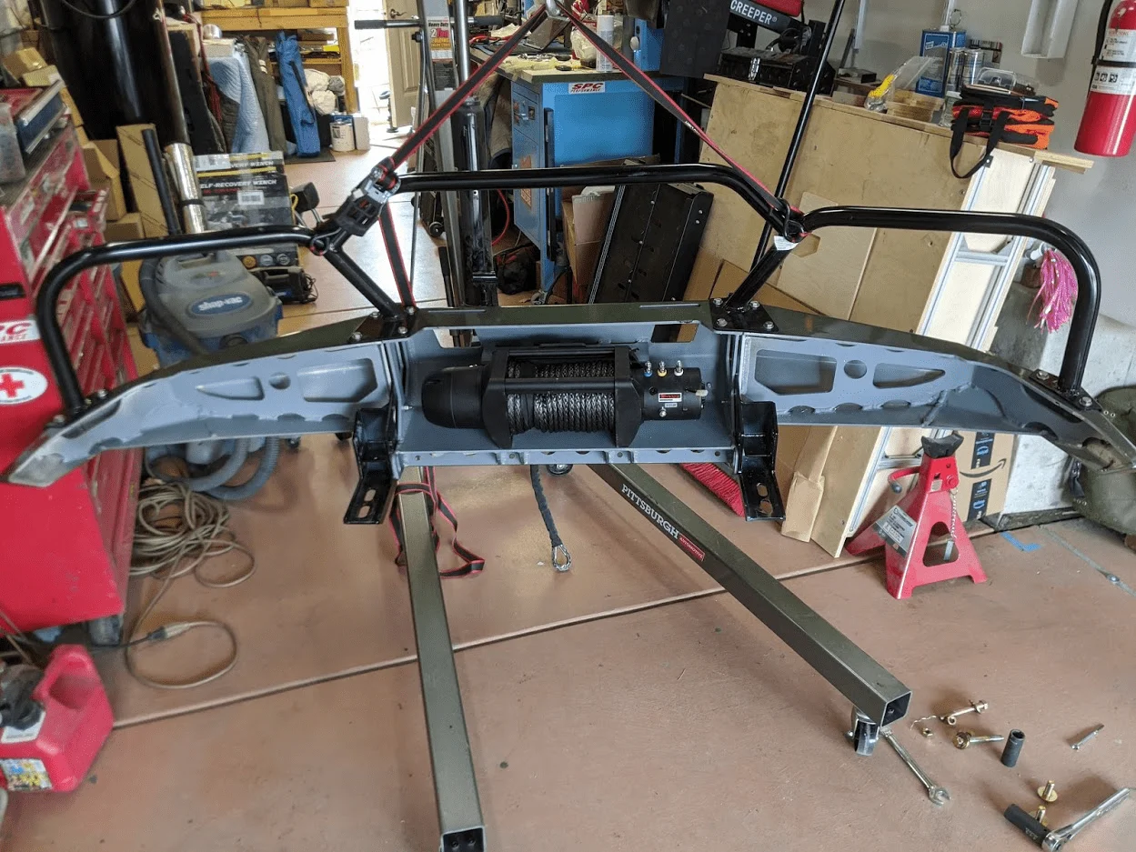

Aluminum: Hands down Dissent. Well gusseted and gorgeous.
Also worth noting/repeating that AHC can handle steel if you really want something that's only offered in steel. Aluminum is the better choice, IMO, but AHC doesn't preclude you from going the steel route if you want. The adjustments to t-bars made for either bumper material are identical and reliability differences should be negligible.

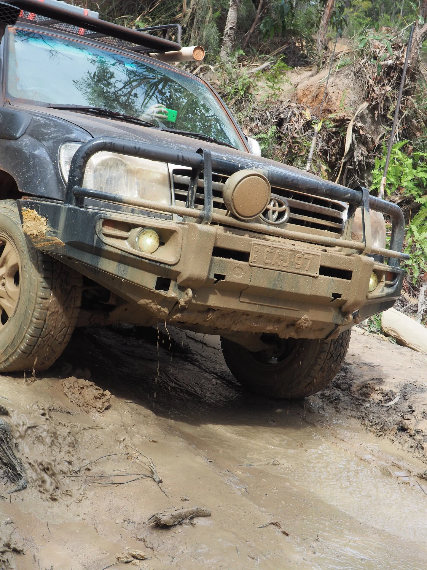

The bigger issue is how would the car fare? We hit a cow at around 80km/h (50mph) and while our steel (Ironman) bullbar seemed hardly damaged, the bar was actually damaged beyond repair. The crush cans had collapsed, which had the effect of preventing major transfer of stress onto the chassis and therefore the car was ok.
At 70mph impact, a steel or aluminium bar is going to be buggered - however any bar should also be considered in light of how it will protect the vehicle in areas you mightn't expect.
This is the bar in question. Looks ok - however the grille is cracked, the bonnet is slightly bent (both due to the bar being pushed in by the impact then rebounding slightly after) and you can see it's drooping along the front panel.
Go for a ausi made bumpers for the front of u care about impact from front end collision. Ausi made are tested and certified. Frame rail isn't stronger than most bumpers. Possible frame damage from even minor impacts.
Those crush cans a real deal.
