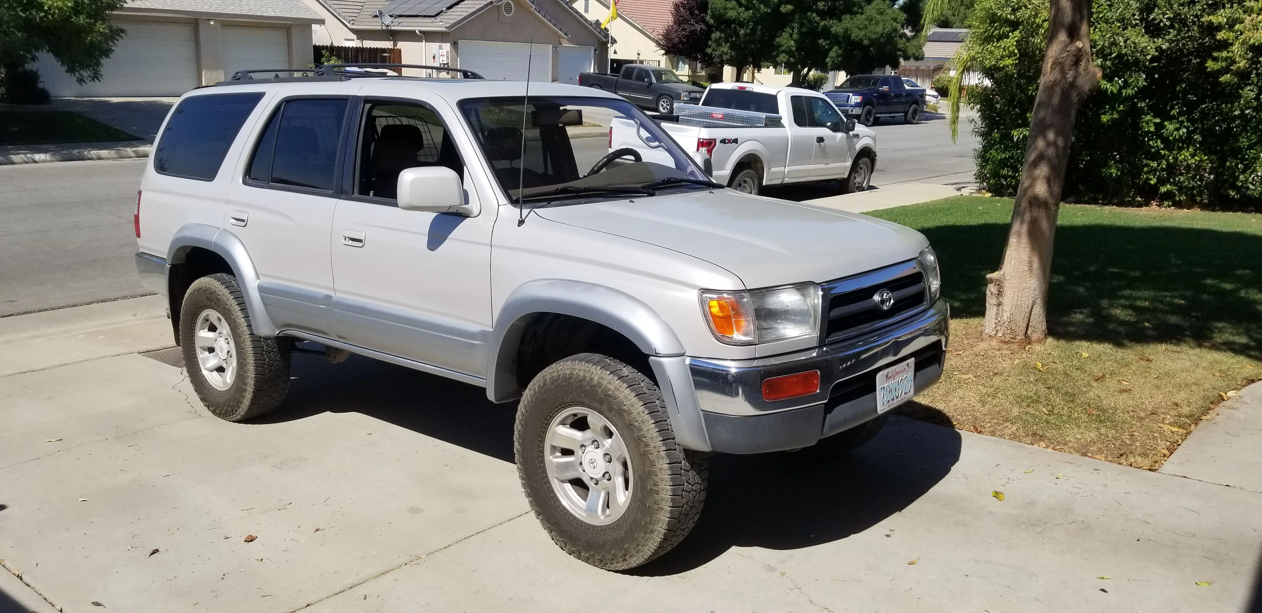

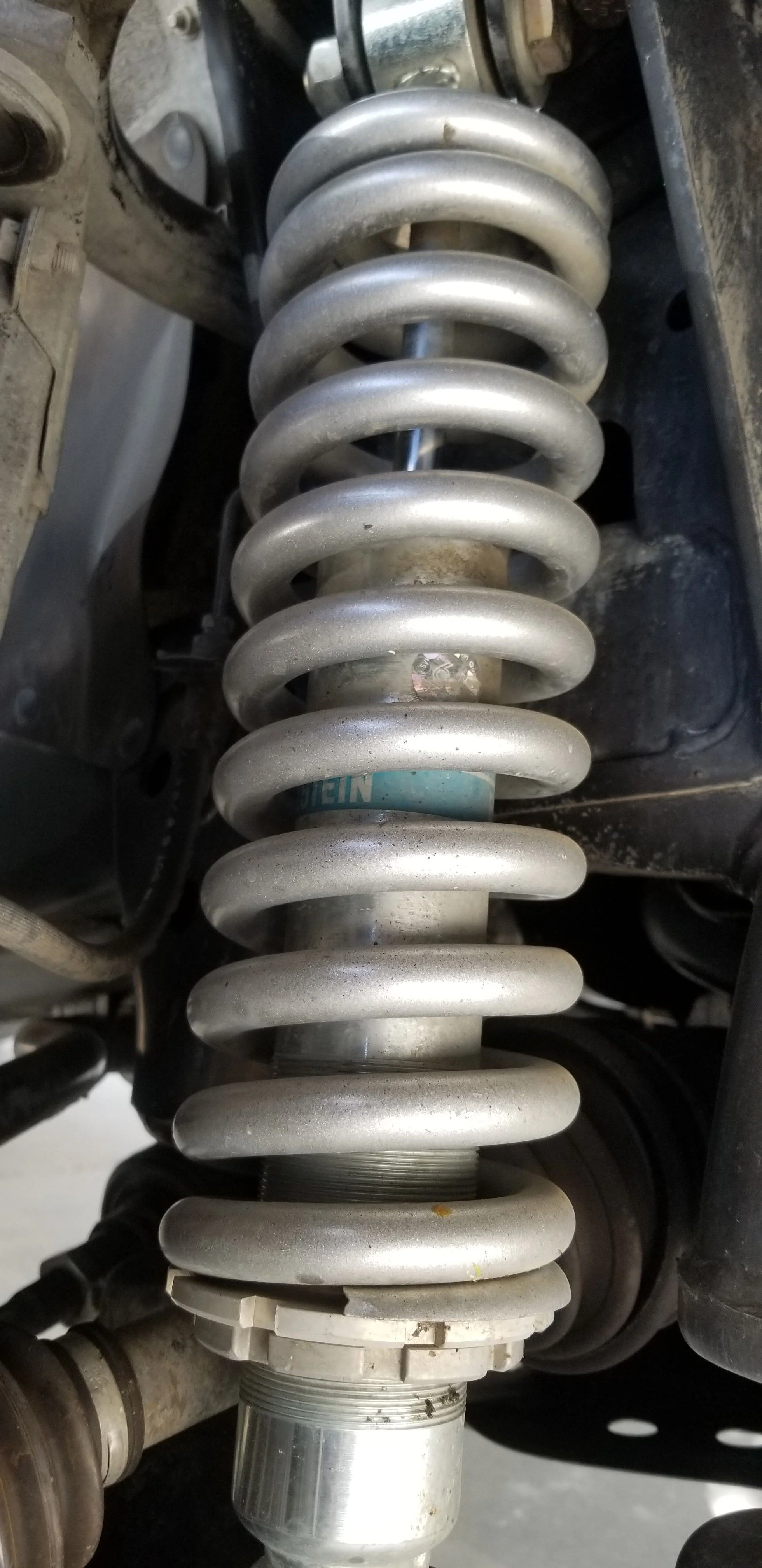

Heres what i just used on my daughters 97T4R.
Gave it a nice stance and feels great on the hwy, mtn. roads, and FS roads where we live. Not a crawler by any means but a simple huge improvement in ride and appearance. we put 33x10.5s mounted on stock 2014 t4r 17" trail series wheels and 1.5" spidertrax spacers under it. Rear was fine, had to trim the front in all the suspect places (rear fender liner and we have a tube bumper on it so no issue up front)
Lift ended up ~2.5" plus tire size.
Front setup-
Rear -
Amazon product ASIN B004P9IE96

...did custom-valved 5100 Bilsteins recently on my FJ60, and MAN what an improvement.
Did you compress the springs yourself? Also, did you re-use the top mounting plate of the OEM coil-overs?

Yes, and yes. I have a pair of spring compressors from OTC that i use with my impact gun. Mostly safe😂

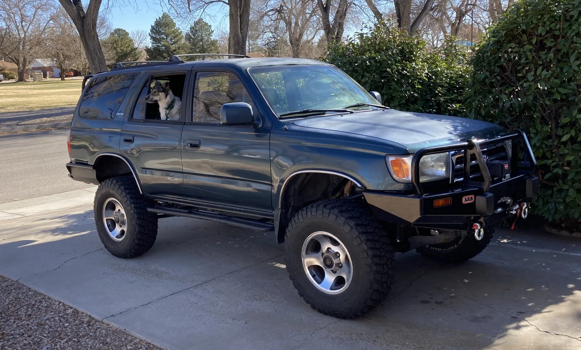

On his 98 4runner (3.4l, 5 speed manual) my son is running a Toytec 3” lift with SPC upper control arms and 285/75/16 KO2s. Seems pretty happy with the drive-ability of it. Now that it’s aligned, and we’ve addressed rear upper and lower links, it seems a very solid rig.
On his 98 4runner (3.4l, 5 speed manual) my son... ...it seems a very solid rig.

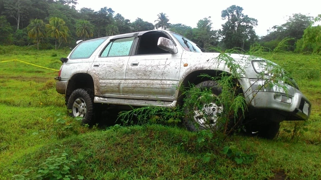

I'm not sure my aims are exactly the same as yours, but my 3rd gen Hilux Surf (4runner diesel) sees tougher 4wd than what you are describing including occasional stream crossings, mud, steep mountain trails etc. I don't do any intentional rock crawling, but light rock crawling has happened before based on trails/riverbeds etc.
My setup is actually very close to factory and I've never bottomed the Surf out or felt that it couldn't go where I needed it to. It is a remarkably capable vehicle offroad once the right tyres are on it.
OEM 16" rims, which i've never bent or damaged, and seldom even need balancing with 265/75/16 (was Goodyear Duratrac for 5 years, recently moved to Kumho MT51s which I got on clearance for less than half the price). Both of these tyres have been fantastic offroad and good enough on road. That size equates to 32" and i'm just at the limit without rubbing (not using any spacers etc). Re wheels, I wouldn't spend money on wheels from your budget unless you are getting a steal or have some cash to spare.
Bilstein 4600/5100 (i say both, because for the rear of the vehicle, they are the same shock just painted differently, buy whichever is cheaper)
For the front, the 5100 is height adjustable (spring perch adjustment)
I have a rear 1" spring (25mm) whiteline coil spring isolator to level the rear ( W72820 )
Re ball joints, if you can afford it within budget, go for the genuine stuff. They are expensive, but they LAST.
I've changed all suspension bushings to Whiteline Polyurethane bushings because I kept on destroying various rubber bushings, but the jury is still out on this. I think it did make the ride firmer, but my vehicle handles like a car on smooth roads, very little body roll in corners etc.
If you are an automatic TRANSMISSION COOLER IS A MUST FOR ALL TOYOTA AUTOMATICS! Buy a good one, and add a genuine (metal) magnefine filter.
Finally, make sure all of your metal guards/skid plates under the vehicle are in good shape. I kept the OEM one and it has protected my underside in every offroad situation I've taken it.
Add a rear tow hook from harbor freight (less than $10). My Surf had a front tow hook but only had rear loops and not a proper hook.
Extend the rear diff breather if it hasn't been done yet. Cheap and easy mod that can save some work later.

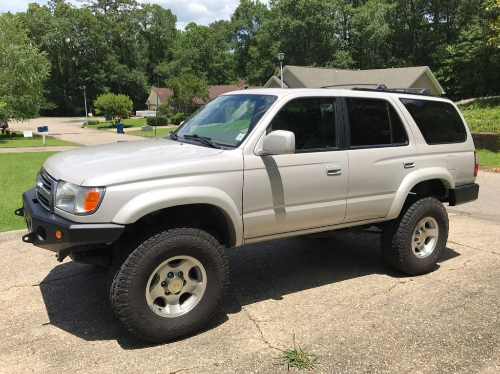

Good read, thank you. I have a '97 Limited with OME 906's in the rear and a set of Eibach 1400.250.0650s with Bilsteins up front. All sitting on 265's, absolutely no rub lock to lock and perfectly capable for anything I have needed it to do. I bought it this way from a friend of mine. I intend to go to 285's once these 265's wear out. So reading these really helps with what decision I make going forward. Mild wheeling & camping but mostly my DD when I am not in my work truck. I am thinking of going with OME 890's in the rear since I have the weight of the rack up top and only when camping I will have the RTT up there. Then probably cranking up the coils in the front to see where that gets me.

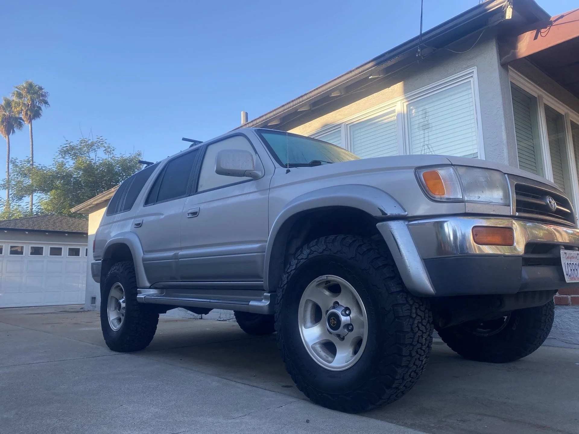

I did!
Did upper/lower BJ's, extended SS brakelines, and a SRQ fabrication hybrid Bilstein/OME kit, as well as a differential drop from Total Chaos.
(had to make some little spacers + extend the bolts to retain the OEM skidplate, but that's mickey mouse stuff)
Used all new components for the front strut assembly, since the old ones were really clapped out at 200K+
Install went well, and was accomplished in 1 day. Hardest part was deciding which circlip to put the shocks together at.
Went with the lowest clip, but I think it has a bit of rub due to this extra missing 1" of lift... but only at a very specific 2/3rds turn and in up-travel or full stuff in the rear.
Went and shook it down on. some roads last weekend, and it performed well. Really eats bumps well, and dampening is fantastic.
If I ever get a wild hair, I'll take the fronts out and re-compress them for a 2nd time, and put the spring at the 2nd clip... but, for a 95% mall crawler that can get you there if the old FJ60 takes a dump... it's golden.
