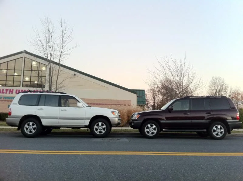

Tires and a few turns in the stock torsion bars is a great first step. I think I lifted my front end about .6". That gave the truck a more level stance but kept the rake. Keep in mind, removing the 3rd row will "lift" the rear end 1/2". I set my torsion bars (turn, stand back and look, turn, stand back and look) with the 3rd row out - so that when in, I still had a bit of rake.
Side Note: ^Those^ are both 2006/7 100s. Just removing the running boards (have MT sliders now) and the flares and nudging the front up a tiny bit, gave the truck more of a "truck" look. By comparison, the other looks like a minivan.
