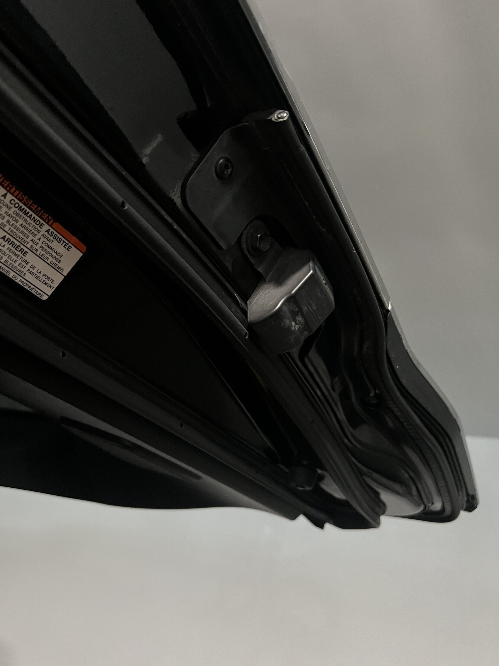

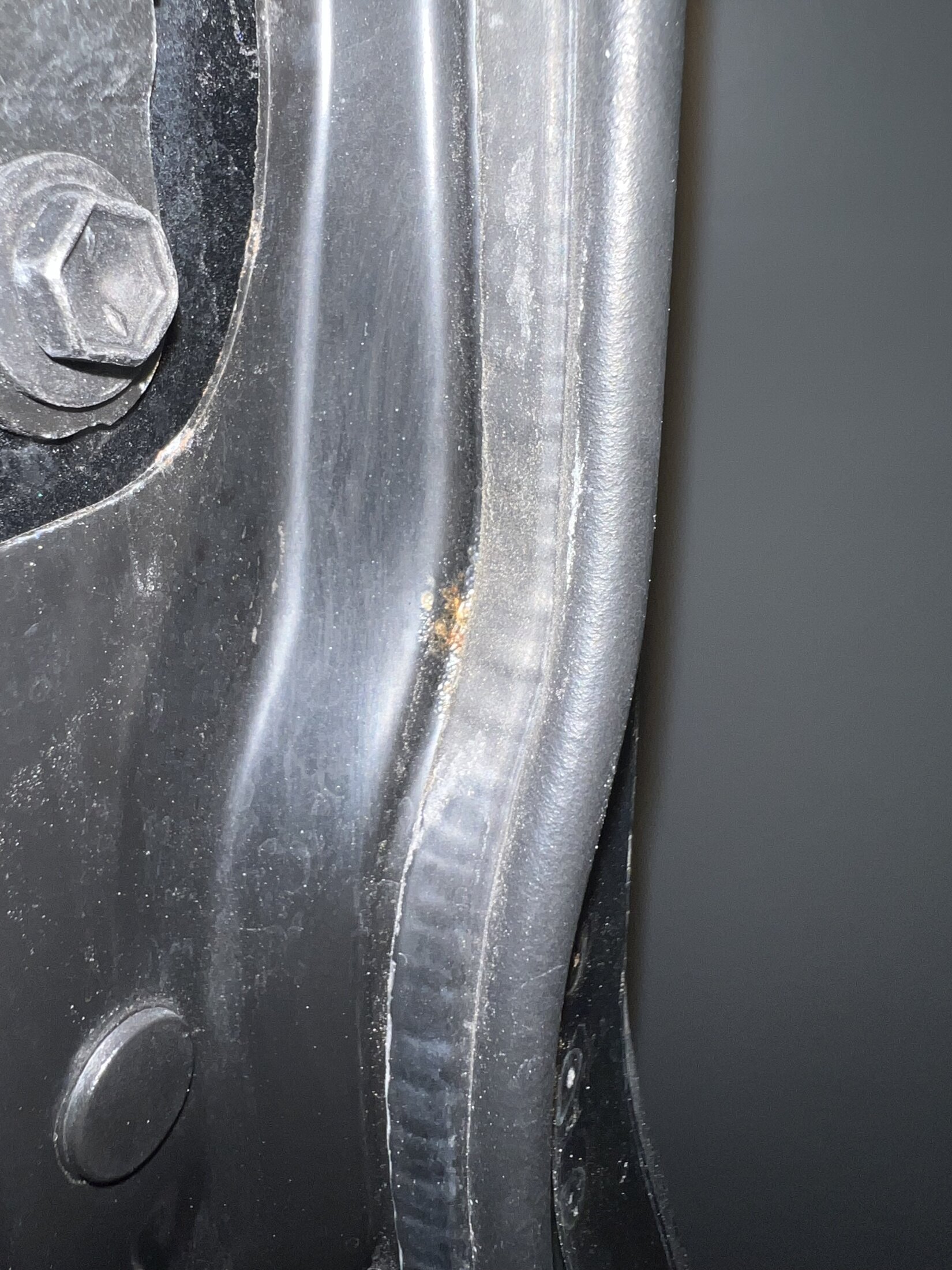

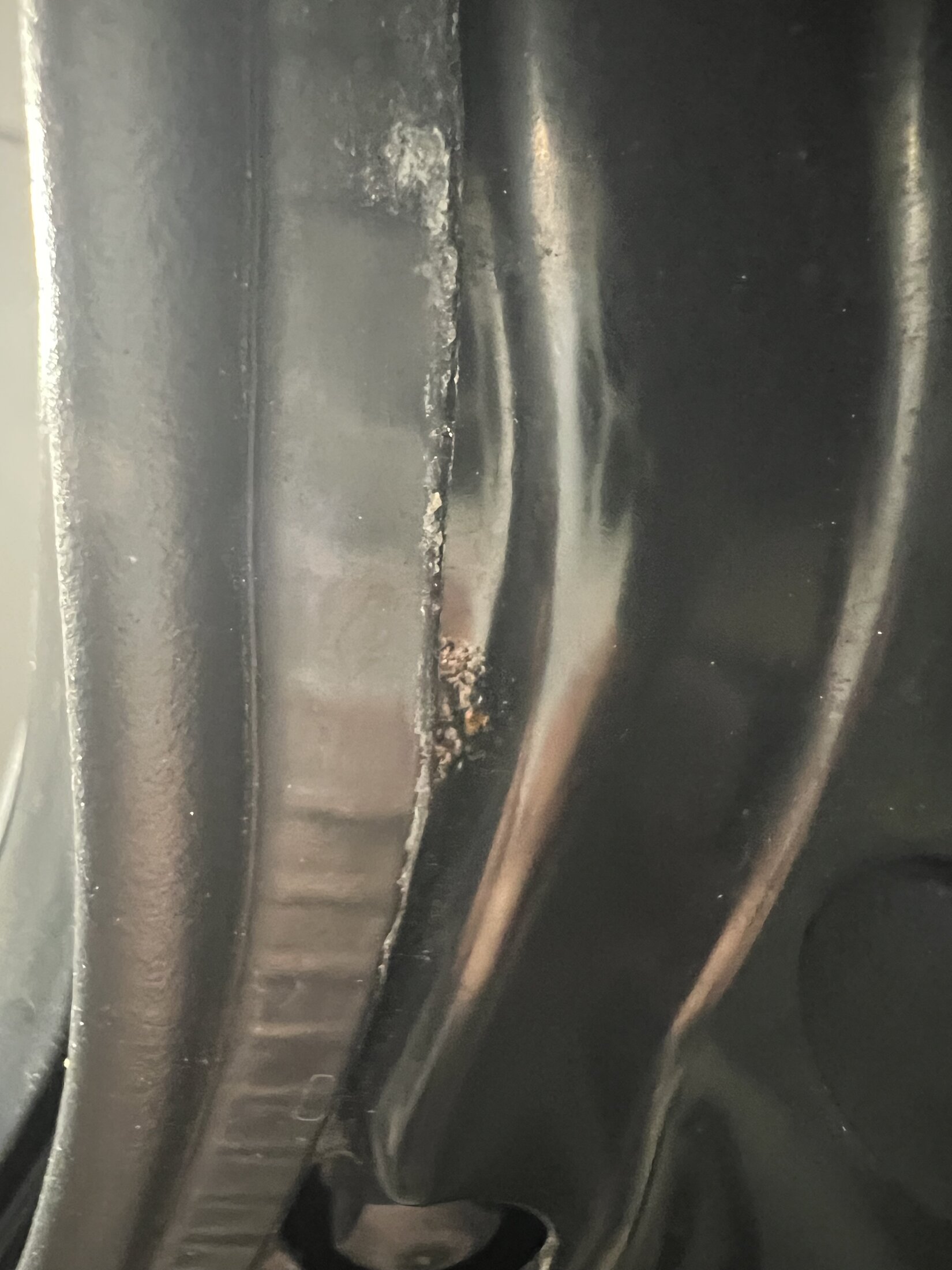

1) I found two pretty bad rust spots (bubbling) on what looks to be a piece of metal trim that holds the rubber lift gate gasket in place. One on the driver’s side and one on the passenger side.
It seems like this metal trim just bolts on. Would you all recommend just replacing it? If so, any idea what the part # would be?
2) Any clue why the paint on the top portion of the tailgate is so worn down? Something is clearly contacting it as it feels rough to the touch on both sides.

I've taken these sensors off before to do some cleanup/check for rust. They just unclip and no calibration seemed to be needed. And yes, they're expensive unfortunately. Since they aren't part of the structure themselves, I would recommend just cleaning them up/keeping them around and focus all your effort/money on the tailgate itself if needed.

Fingers crossed there is nothing going on underneath the sensor. There’s no visual evidence that anything is rusting besides the metal bracket, but it’s curious why those are corroding in the first place.
Worst case the lift gate is rusting and I will need to get a body shop involved. Not a visible, exterior part of the car so not the end of the world.

I just cleaned up the rust and repaint after removal.
Chances are that what you see is rust wash from the sensors and the tailgate itself is good.
Why they rust? Because the paint is not great to begin with and tailgate is a place where the water and whatever else is in it in the winter tends to stay and not wash away by the air or water flow.

My mechanic and I were working on installing the new sensors this morning. Very easy swap.
Then we go to close the power liftgate. Double beep. Won’t stay closed.
We troubleshot for like an hour. Disconnected the battery, tried to reset the liftgate system, looked for debris, you name it.
Gave up and put the old parts back on. Worked immediately.
So yeah. Really disappointing first experience with PartSouq. And a lesson for me that a small cosmetic issue like this is not worth messing with (liftgate itself is fine - no rust).

Alright, I caved and went to the local dealer to see if there was some magical initialization process that I was missing.
Turns out the driver's side pinch sensor assembly was bent, probably during shipping. This caused the pinch sensor to push up against the interior trim of the trunk which is why it wouldn't close.
It's still bent but the tech managed to straighten it enough to get the power liftgate to function consistently.
Definitely lots of fun scratches on the liftgate from this install. Have done my best with the touch up pen but now I'm worried that my quest to remove some slightly rusted standalone parts will put the entire liftgate at risk...
PartSouq was responsive, although not the most helpful. The parts were genuine but damaged. I'm going to let them know that today but I'm not sure there is much to be done.
Moral of the story: Some small things are best left alone, lest you unintentionally cause more problems.
