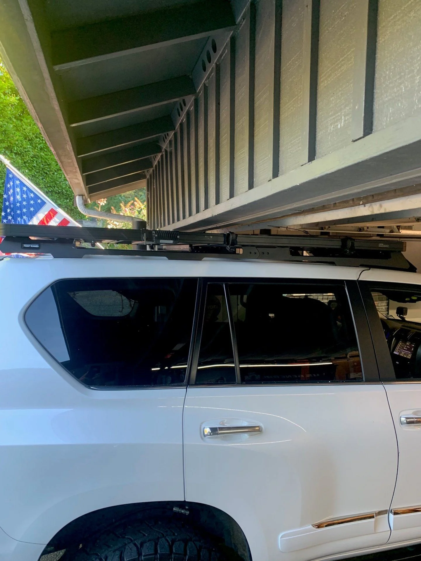

You will be close. I don't remember my garage door height. 2.5" of lift.

Highest point I could measure my bare roof line was 76.25”, just behind the rear axle. Factory roof rail runners measured at 1” to 1 1/8” tall.
So stock roof line with no rack, 2.5-3” lift and 285/70/17s put me at 77 3/8” aka about 1.5” of clearance in your work garage.
The top edge of my Gamiviti rack sits 3” above roofline in the rear, or 2” higher than the factory roof rails giving an overall height of 79.25”.
285/70/17's, Ironman FCP's set to 2.75" front and 2.5" rear, Rhino Rack with Backbone side rails, measured two inches behind rear axle center comes to 78 3/8".
