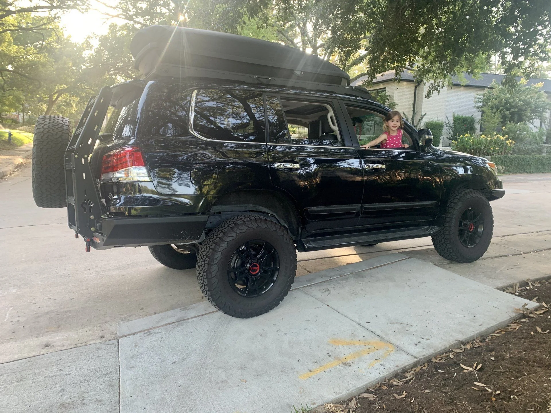

Here you go. 35’s on a 4inch Stock lift 😁
Please stop posting pics of your truck, you are going to make me order a Dissent rear bumper for my LC if you keep it up haha. In all seriousness I really need to meet up with you locally so that I can see it in person, definitely interested.

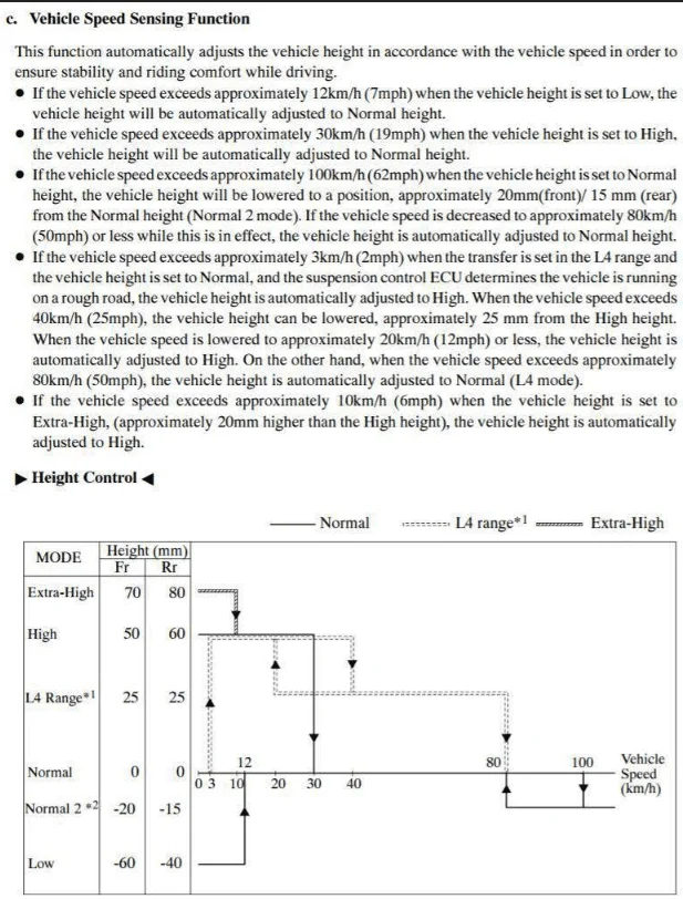

The sensor lift is permanent, but the rig still drops to Normal when you go above 19mph.
The thing im curious about is, it looks nice whenever the AHC is set to High, but you cant keep it at that level from what I read, so how do you keep it from rubbing when it drops back to normal setting?
Not sure if your background is with solid axles, but with the front IFS, lift really doesn't have much to do with making clearance for tires. The tire needs to fit across the stroke of the suspension which lift does not change. It only sets the neutral point. The LX has clearance for bigger tires than the LC.
Sensor lifts can be set up to about 1.75" stock or more with brackets. The ride height will be offset for every height mode from that. Personally, the advantage of AHC is not to overly bias the sensor lift as AHC high should retain some useful droop travel.
For technical off-road where additional clearance is necessary, 4LO will setup the suspension to keep higher clearances up to about 50mph. Combine that with the sensor lift, and it maintains about 3-4" lift.
