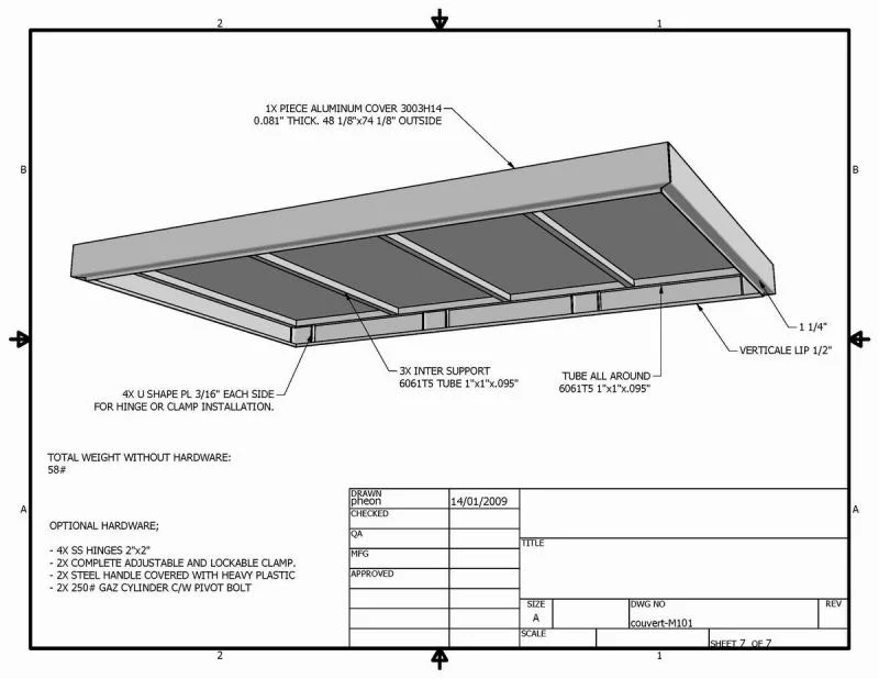

For the Do It Yourself people, here is the cutting list and drawings for the lid.
Very cool of you to post that info Eric. I wanted to buy one from you initially, but $$$$ was too tight. This will let me make one when I have the time & money.
Classy move. Thanks.
Take the list and drawing and head to any metal, aluminum fabricator with a press break and they should charge you 6-8 hours to do it.
