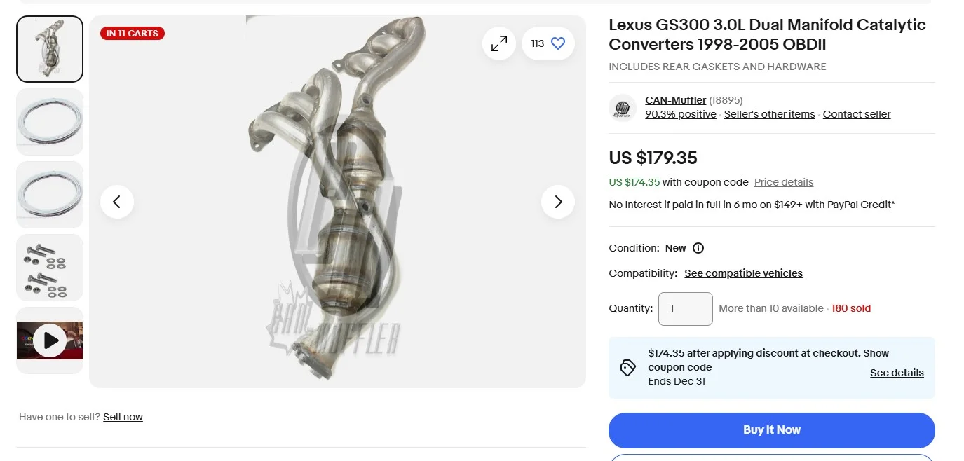

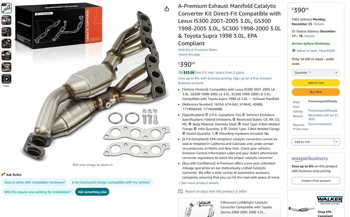

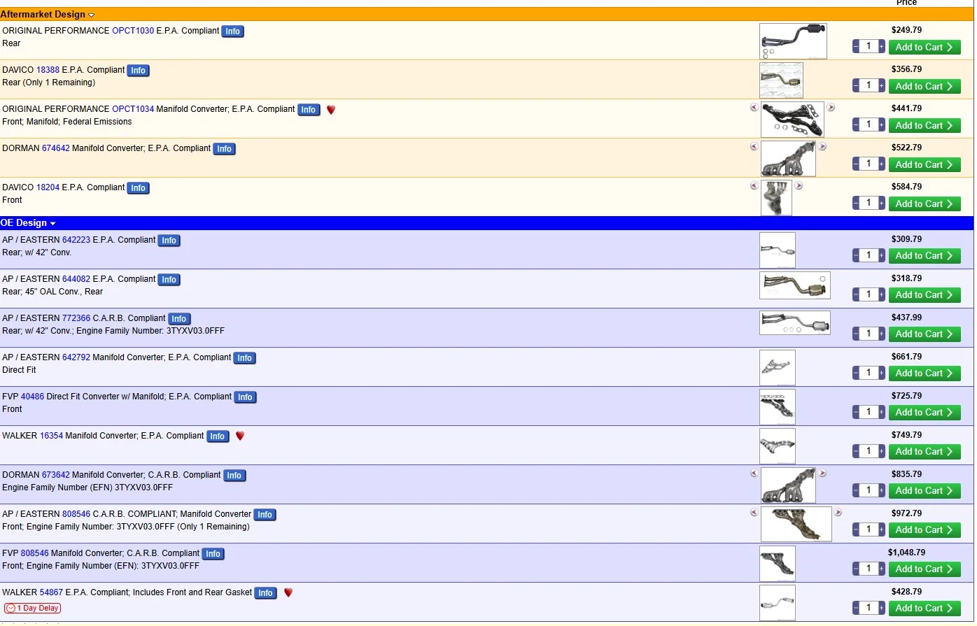

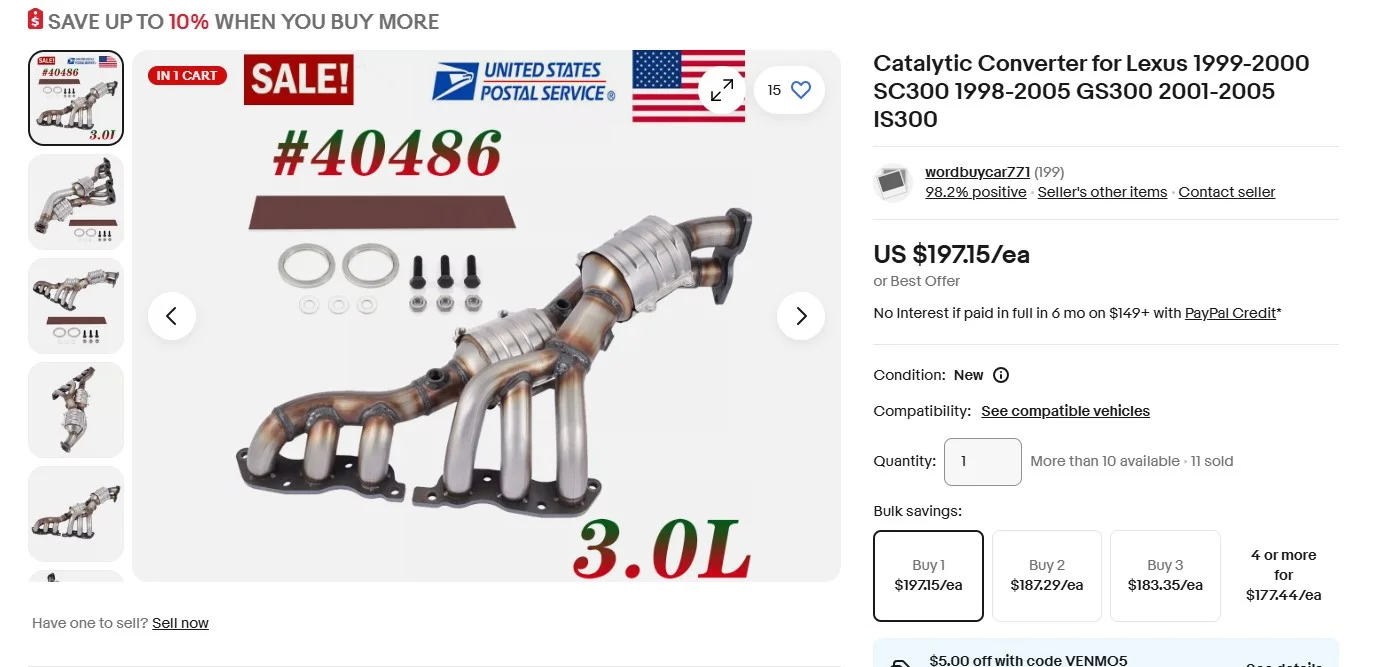

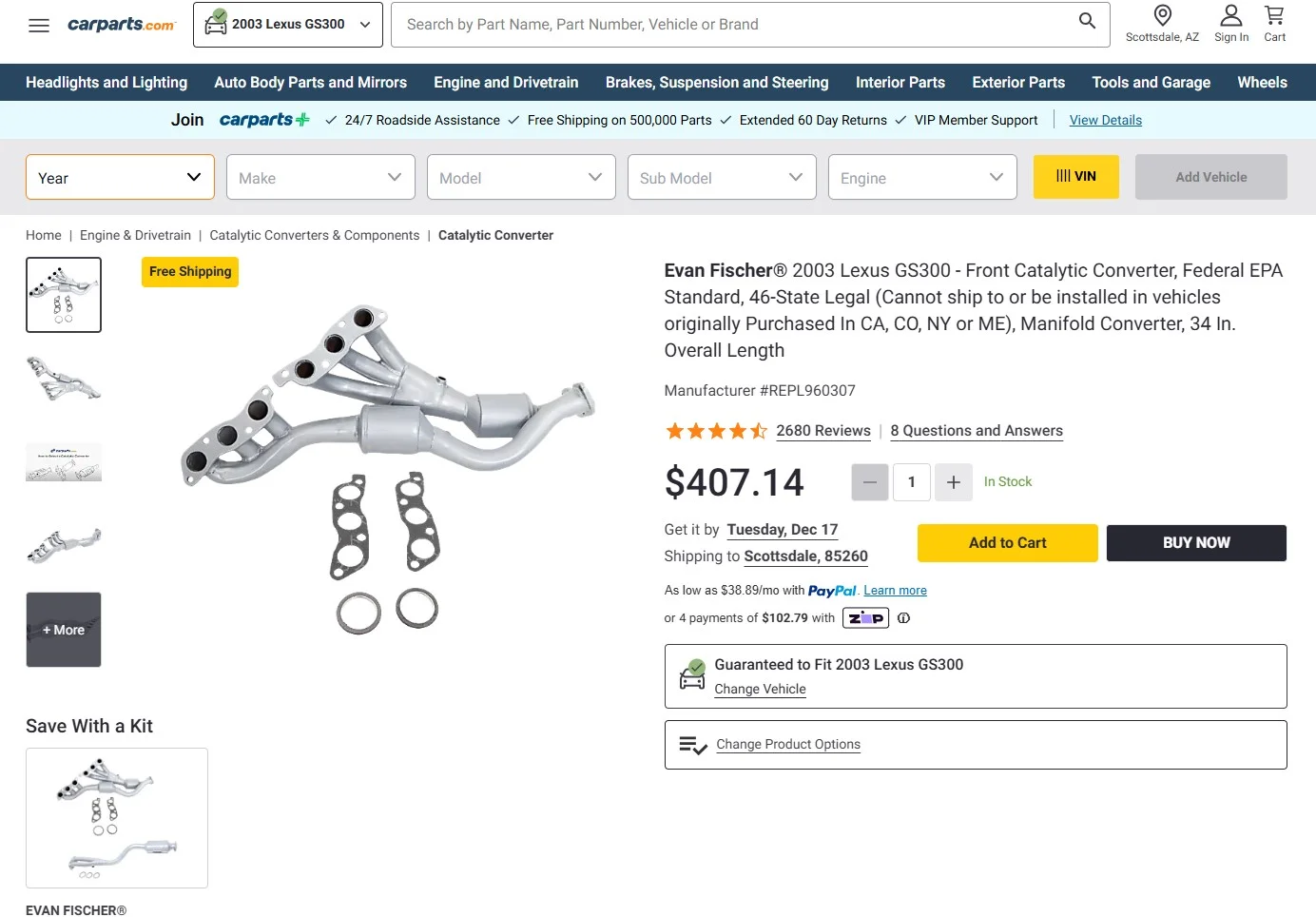

There are a couple of Lexus GS 300s in my family. I have an 2001, and my daughter and SIL have a 2003. These are great cars, with great straight six engines (the 2JZ-GE).
The 2003 is throwing codes, and the mechanic in Utah said the catalytic converters are clogged needs a new exhaust manifold. The mechanic also said they would only install OEM-- which are very very expensive. Like 5K worth of expensive.
But there are lots of non OEM options, but I am not sure which if any are good. And which should be avoided. Ebay has several, Amazon, Parts Geek. RockAuto has several.
Some are as cheap as 200 bucks.
And I have heard that some people just cut the old cats out of the manifold and weld new ones in. Or even just "unclogging" the cats.
As I said before, this car lives in Utah, and it does need to pass an emission inspection. And we don't necessarily want the cheapest--if decent quality can be found for a good price.
Does anyone have any recommendations?
And while I have you-- is there a decent Lexus car forum out there? I know there are a couple, but I don't if one will get you better advice than any other.

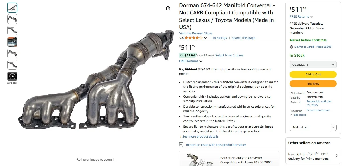

It is in pretty good shape with about 205K miles on it. I just checked Lexus Parts Now and it now says the OEM is discontinued.
But I found another option-- a Dorman EPA version (not CA) on Amazon for 511 bucks.
I feel like Dorman is a big company, so maybe it is worth paying a little extra to get one from them.
