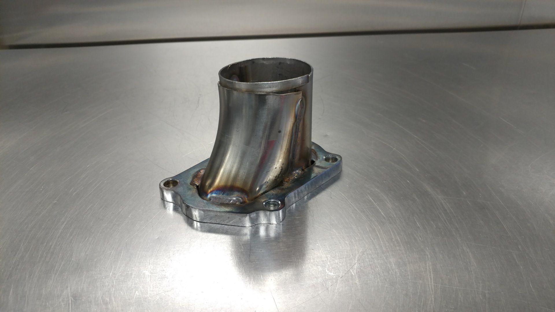

We were able to start the process of building the exhaust. Downpipe was first obviously....we wanted to dump the exhaust down while we're running the truck now.
We will run our exhaust inside the frame. Full stainless 3" all the way from front to back. Spherical joint/donut gasket at base of downpipe....which will all be thermal coated. Aero Exhaust Aeroturbine muffler. OEM Toyota rubber exhaust mounts. Thinking of dumping the exhaust on the passenger side before the rear wheel....sure would make things easy.
I bought a flange....we started by mocking things up to see how the 3" pipe fit.
Then the fun started....
Did a quick test fit to see where we were going to need to make our bend down...
And this was how we ended up....

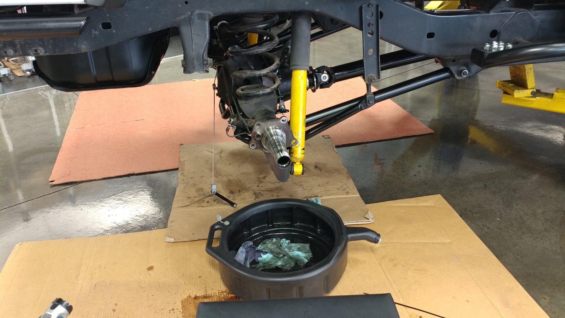

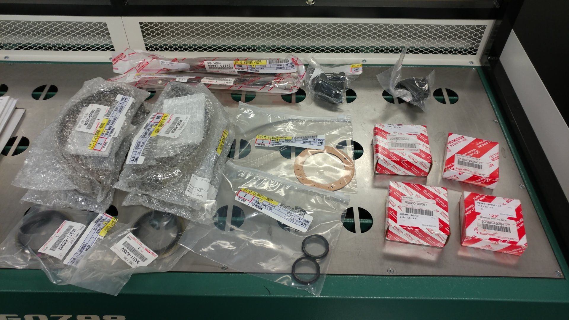

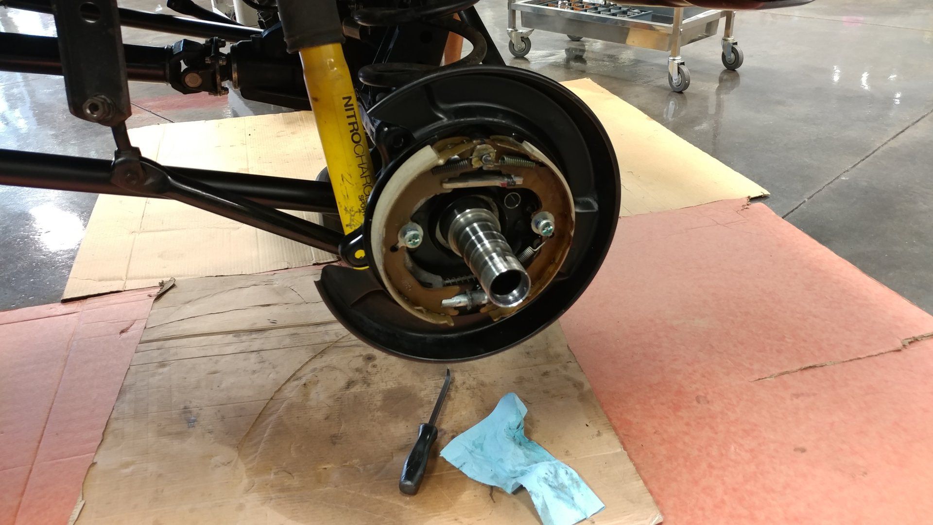

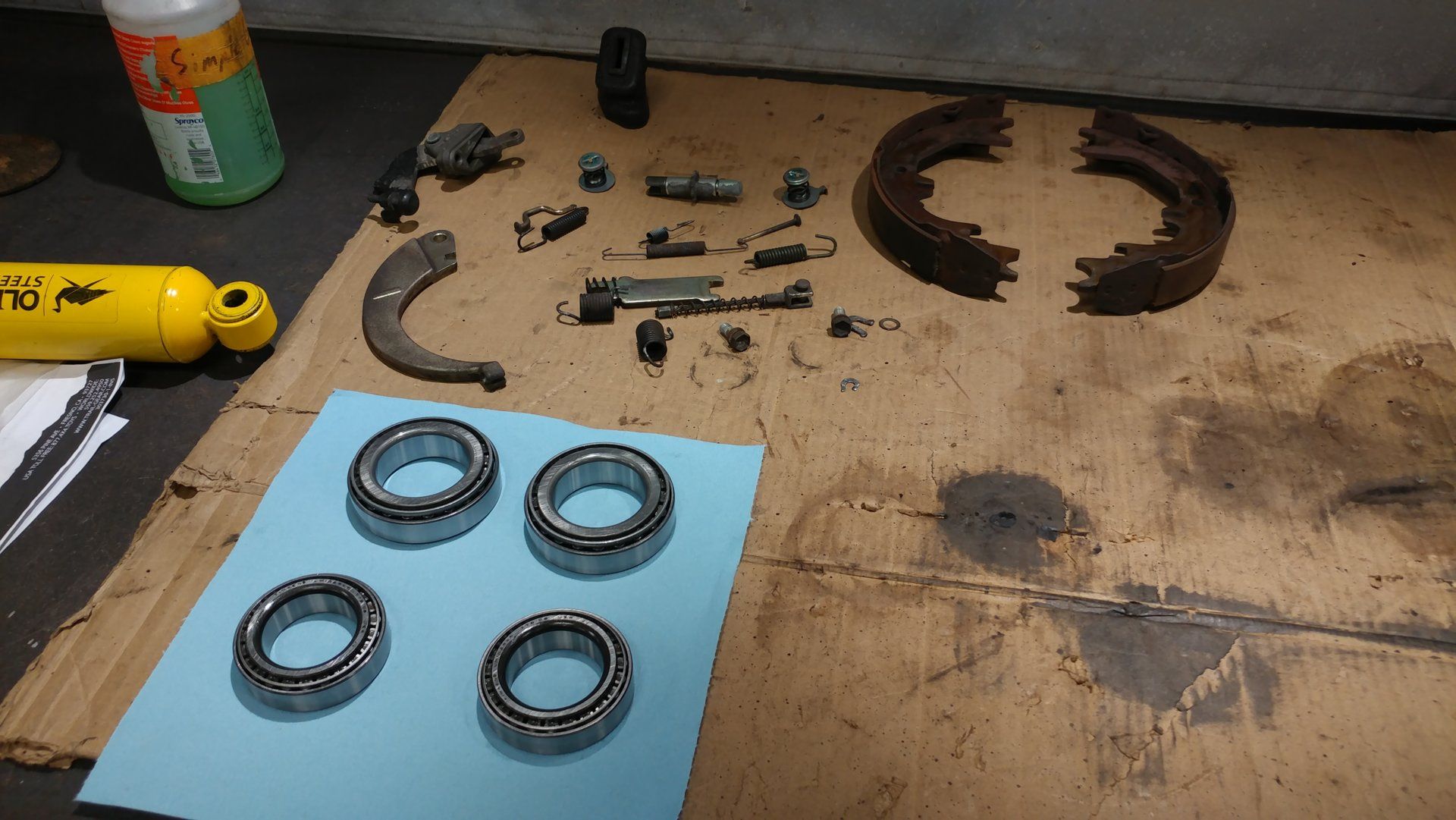

Addressed the rear axle.....new bearings, seals, parking brake bits and pieces....everything cleaned and painted. This axle was missing the locker actuator so we installed a new one, the shield, limit switch...all of that stuff.
With an assembled rear axle......I was able to get it out of the shop. Still not ready for a drive around the block but that should be happening tomorrow 🤞

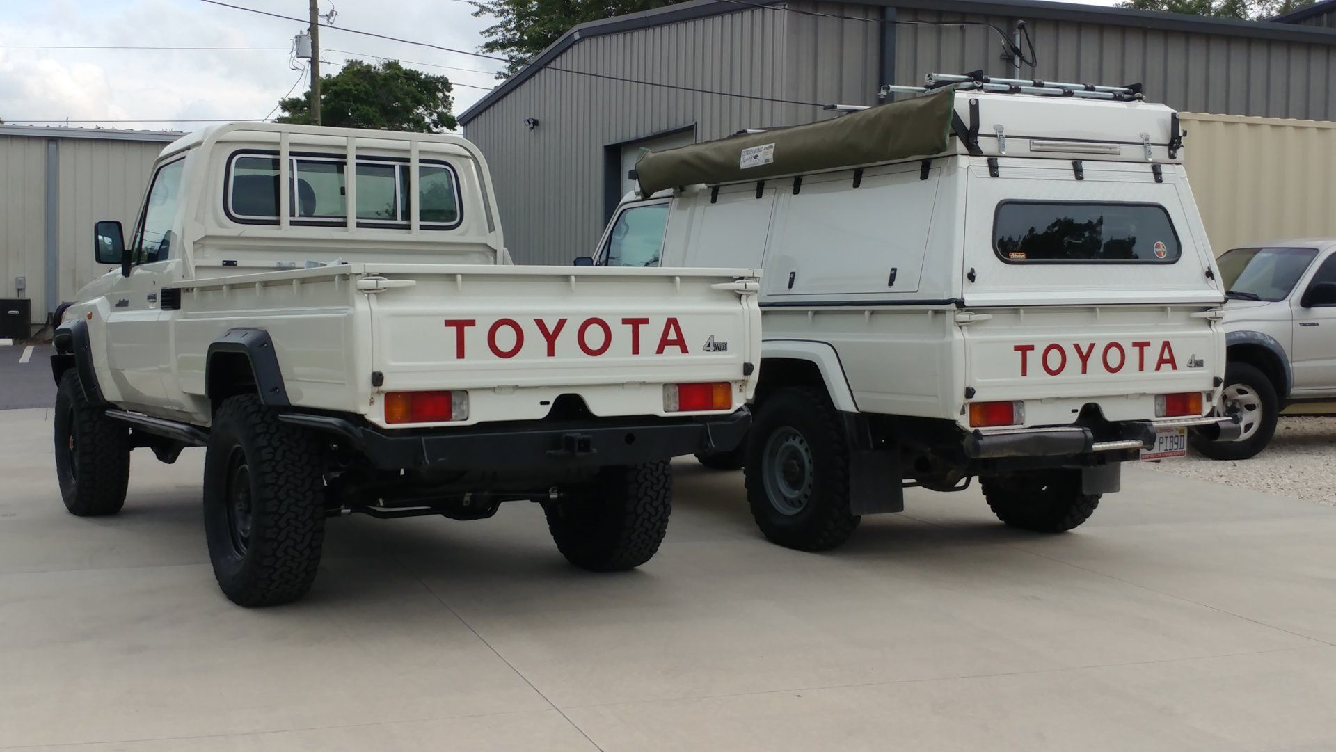

Time for #1 to meet its much larger brother #2. Pretty sure #1 is going to get a serious makeover. Looks like a 2wd truck compared to the new one.
