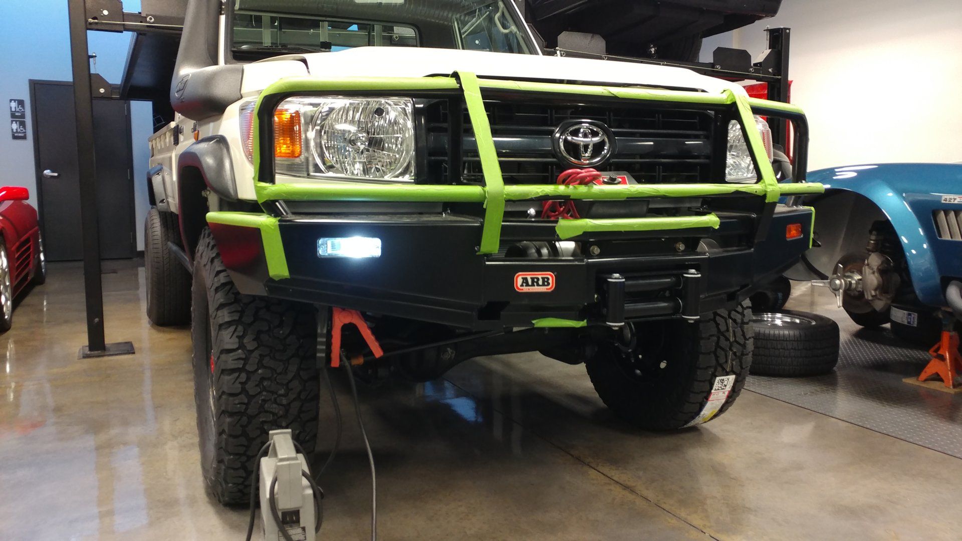

I'm going to run clear front lights in the ARB bumper...they will be both a marker and a turn. Added a dual terminal socket to run a 1157 bulb....and just so it doesn't melt the lens, using a slick switch color LED. Neat bulb. Found some clear lenses on Ebay....and this is the result.
White for running
Amber for turn
The super cool bulb. I'm sure they won't last so I'll have to have some spares.
Clear lens

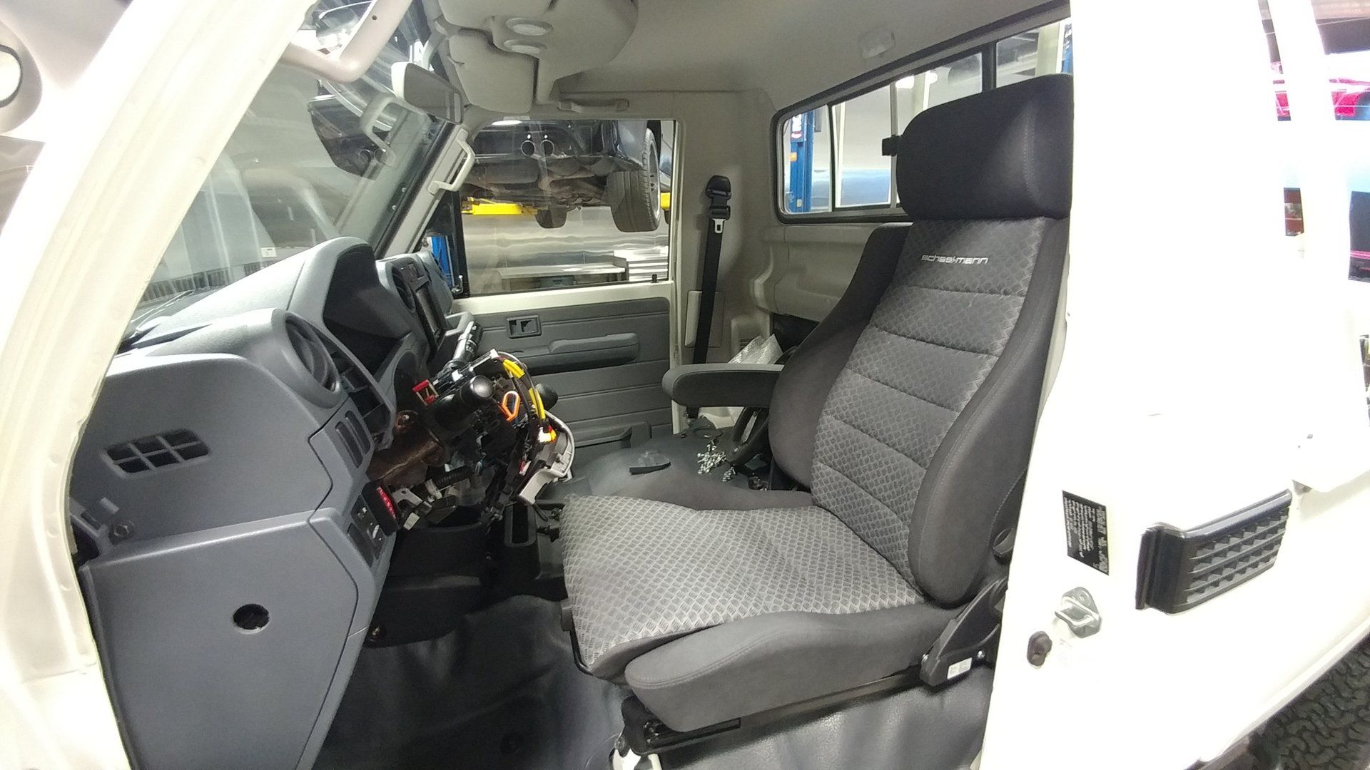

Wanted to get this beauty out of storage and into the truck....been waiting a while to put this in. I've installed a fair number of seats over the years from a wide variety of manufacturers.....these Scheelmann seats are some of the best.
Mine truck take-out seat belts...
Great color match.....not super obvious that it's not OEM which is what I was after.
