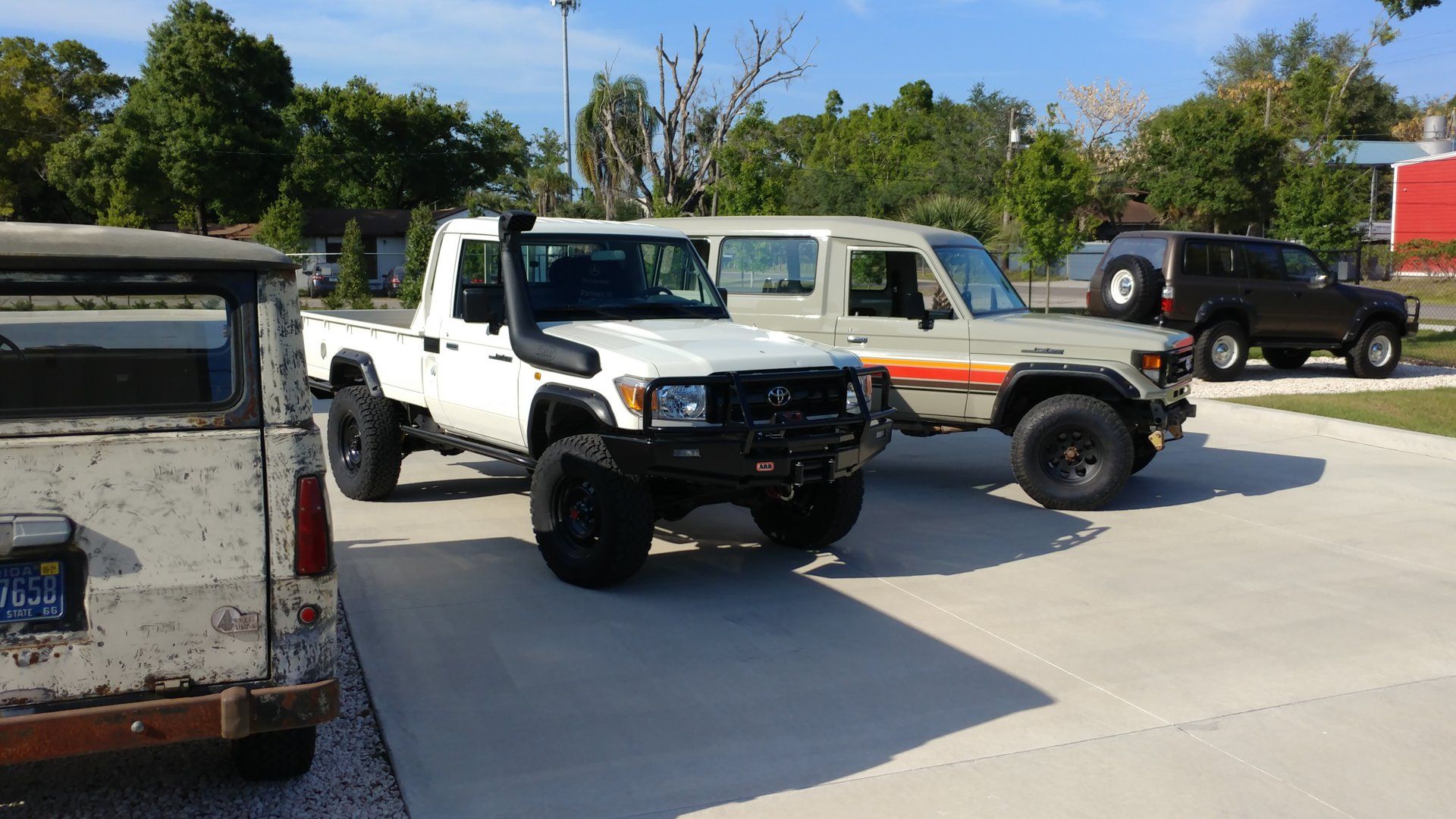

Practiced some social distancing with the Toyotas today....except for the 4Runner and the 60 way in the back. They seemed a little close :)
