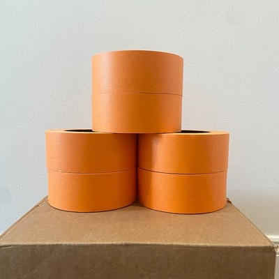

For tape I buy seconds/blems on eBay....1.5 and 2" by the case.
Pro tip right there. NICE.
We use low adhesion green for body protecting stuff and orange high adhesion for everything else.
