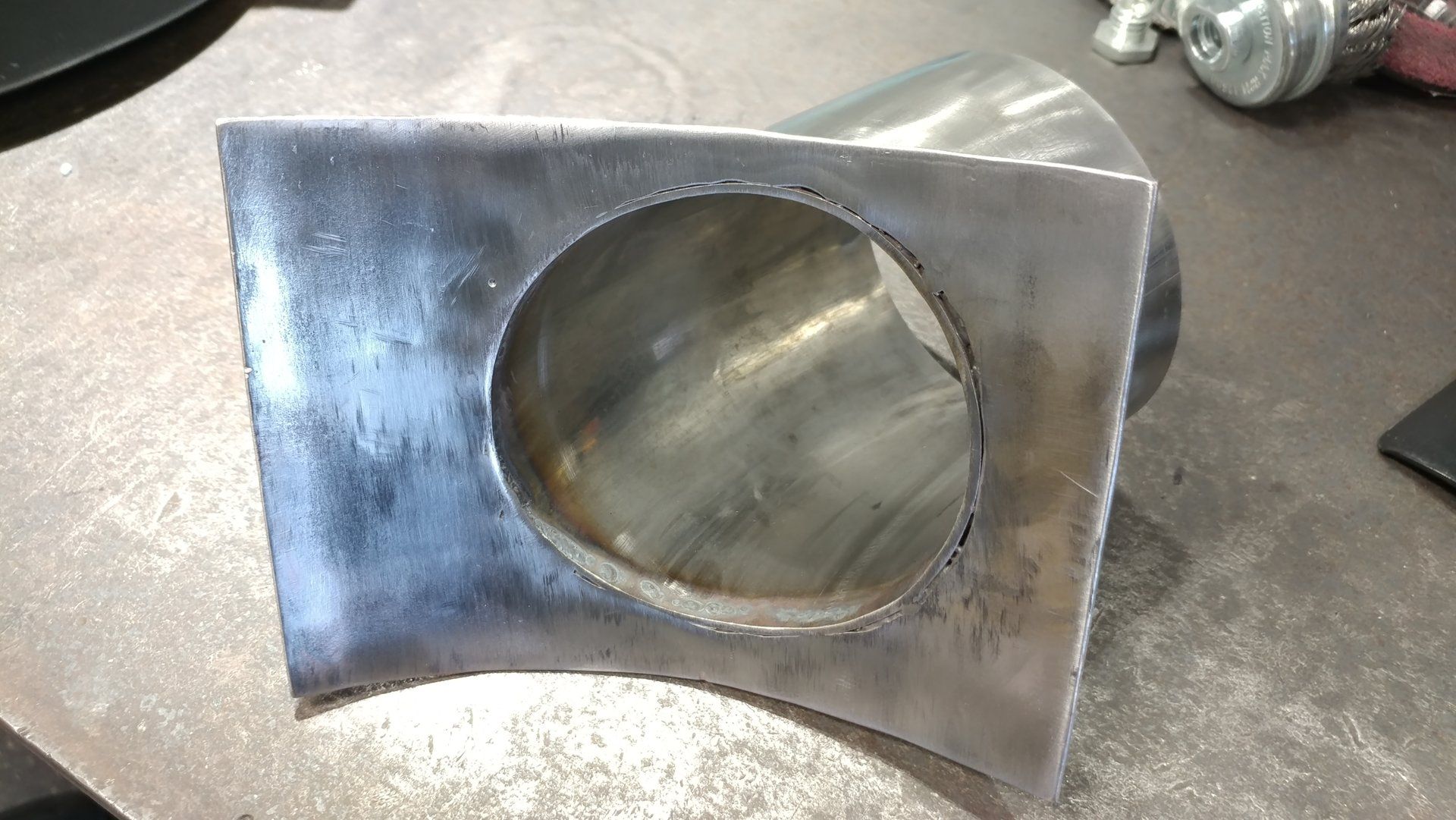

Back on the air box today.....lot of work to do this thing. Questioning some of my ideas......like this.
Deflector getting ready to go
Deflector tacked in
Our cleaned up inlet adapter....may go over the edge with a big to fill in a little of that gap.
Yet another mockup....had to cut down the inlet for final today. Drilled some holes so when it all comes back from powdercoat, we can put in the sealant and rivet it together.

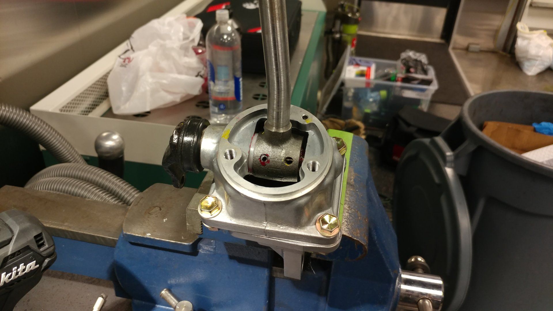

Had to make a quick adapter for the trans shifter mount......I'm not sure what I ordered wrong but the base did not fit the upper. We had a part time transfer lever from what I think was an HDJ81....we used some of its parts. I think at one point I had figured out what I should have ordered but it seemed easier to build an adapter. Some of this stuff gets really confusing.....compounded when you don't know what things came from too.
This is how far off the upper was from the base....
Adapter plate
In position......
We ended up using the shift arm(?) that came from the HDJ81 trans ....which of course needed modding. The hole that the roll pin went into was clocked differently....so we moved it to the other side.
In place and working. This is a H-N-L full time box.
