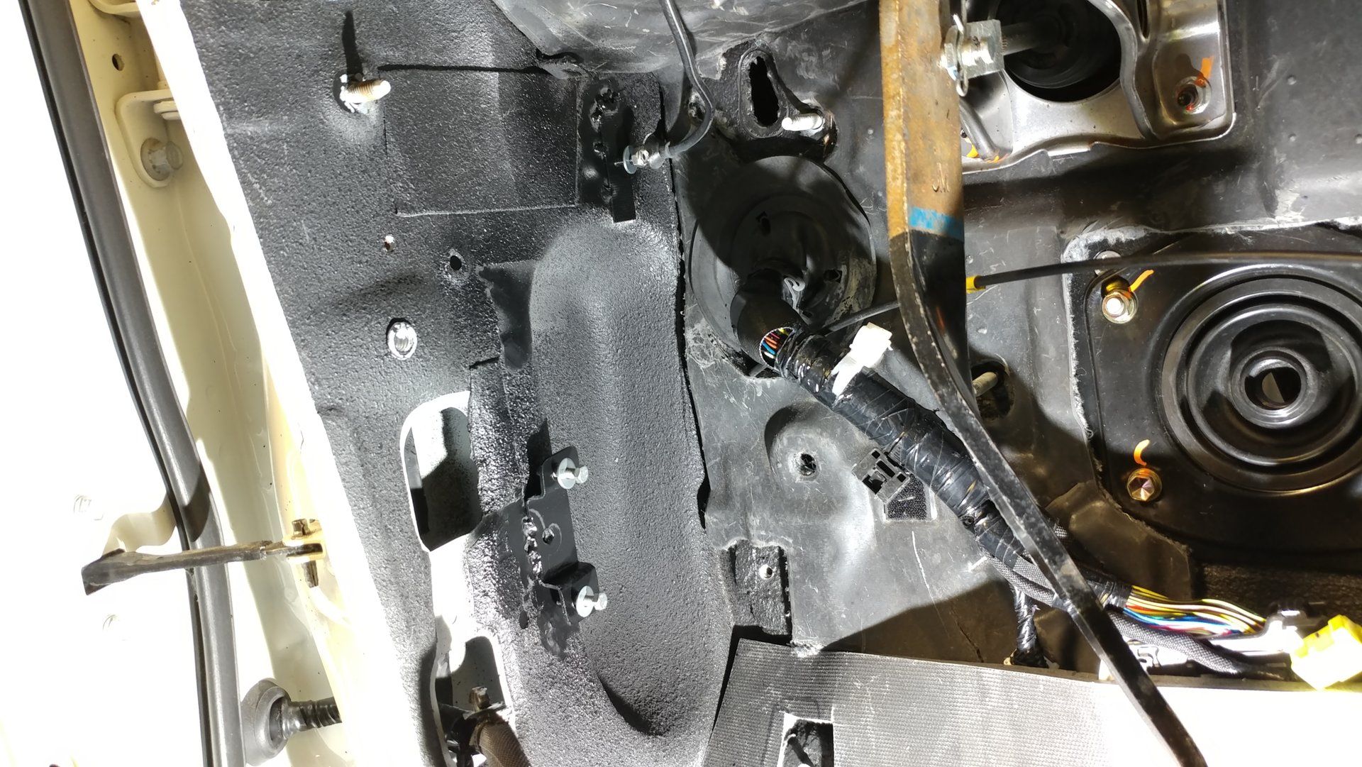

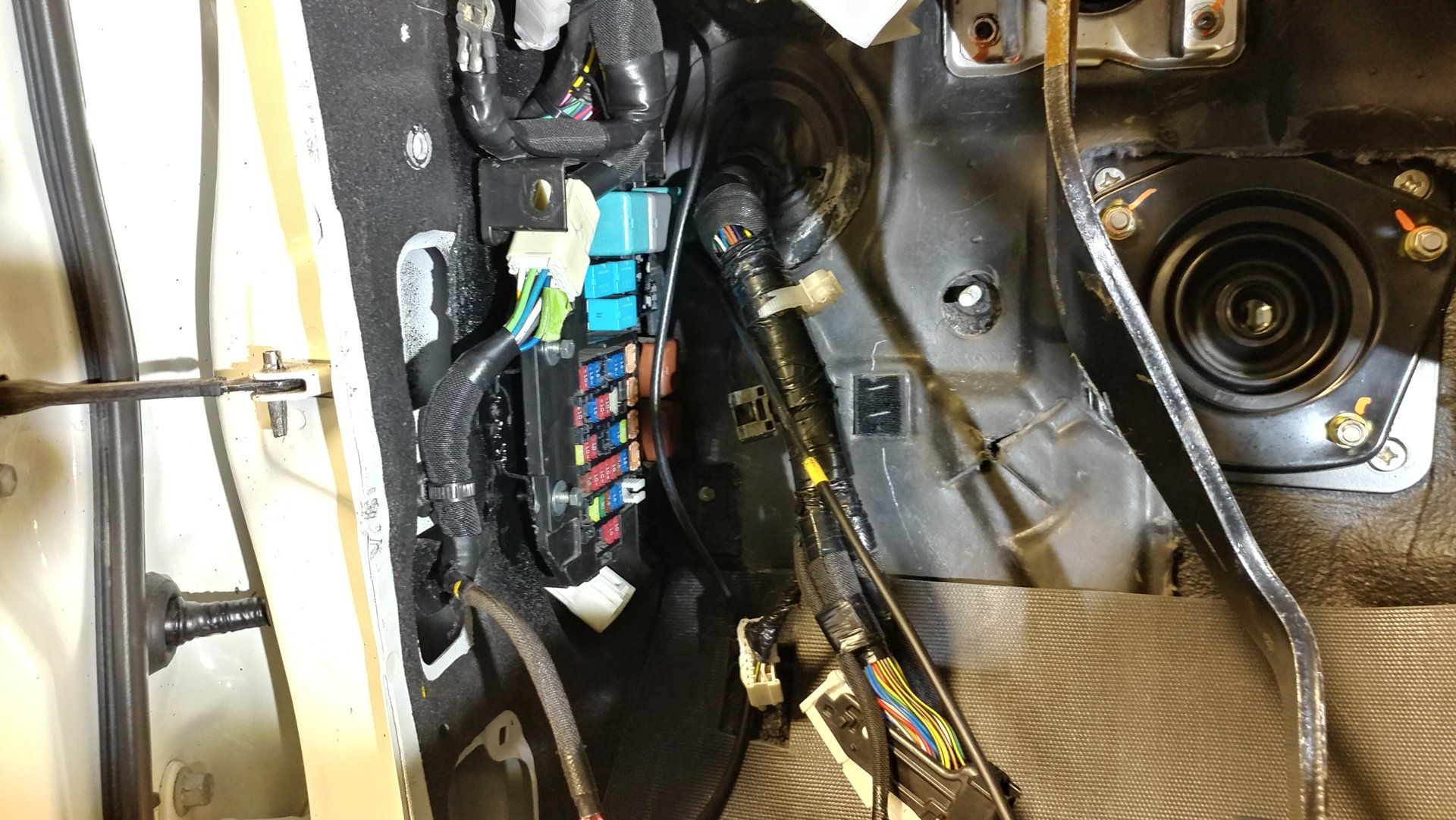

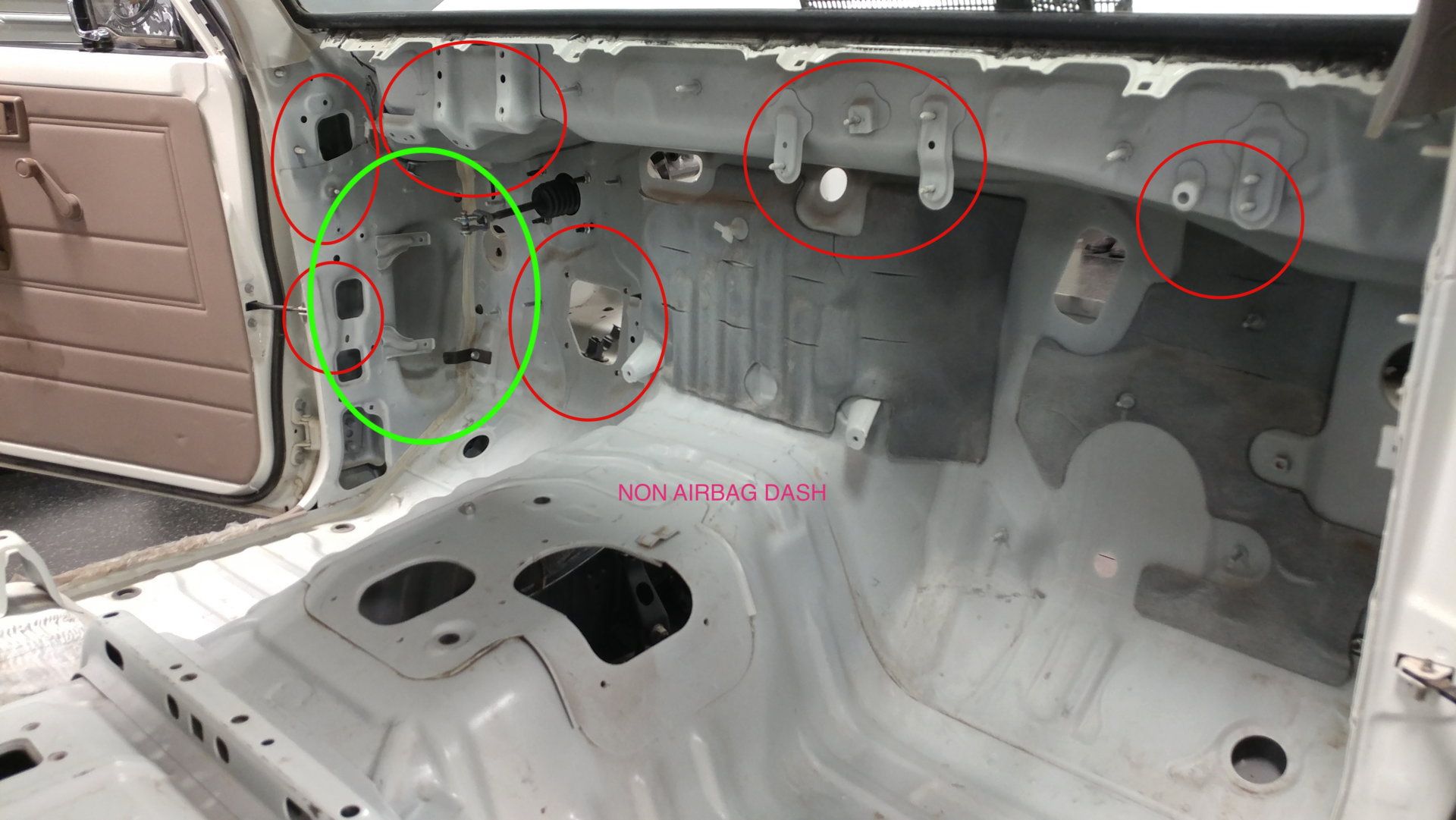

Got a lot squared away in the truck yesterday.....harness went in nicely. Couple small issues which we had to work around....the fuse box mounts very differently. Other than that....it all kind of fit. What a pleasant surprise.
The area circled in green was our problem area.....those tabs had to go to fit the later model harness. Ground down the spot welds, primed it, made some new tabs, welded them in and................the fuse box mounted up just like Toyota designed designed it on the later dash cabs.
