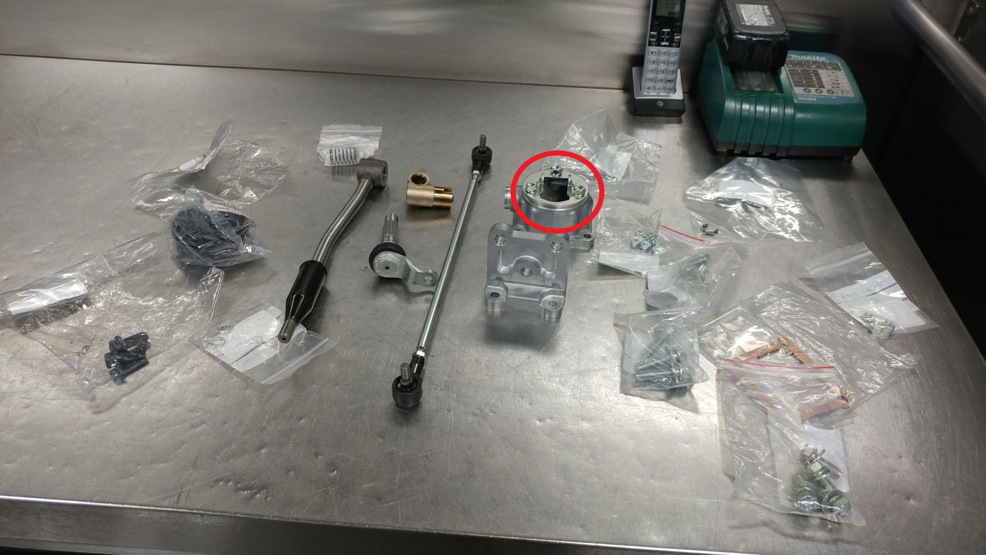

Well today was a day of learning. Learning more about shifters/shifter shafts/shifter brackets/etc., then I ever thought I would need to know. Or wanted to know. Also found out that I pretty much bought every wrong piece I could. So back to Partsouq and Megazip I go....like so many orders, one place has some but not the other....so 2 orders. I could have bought a new truck in what I have spent on shipping. I'm impulsive when it comes to ordering parts.
It looks as if the shifter I bought is right. A couple of washers were right. A roll pin is right. That is it. The biggest screwup was the bracket for the shifter to mount to. I think I bought one for an R151. I needed 36346-60011....transfer control bracket. It's a touch wider.
We're going to adapt my shifter(keyed differently for the shaft I bought) and the shift rod(different ends the what I have....well one end) and try to get it all work. But first things first....we will shove it in the truck tomorrow and see where this thing lines up with the Rav4 dash...it's a lot different than the old school metal one where it meets the floor.

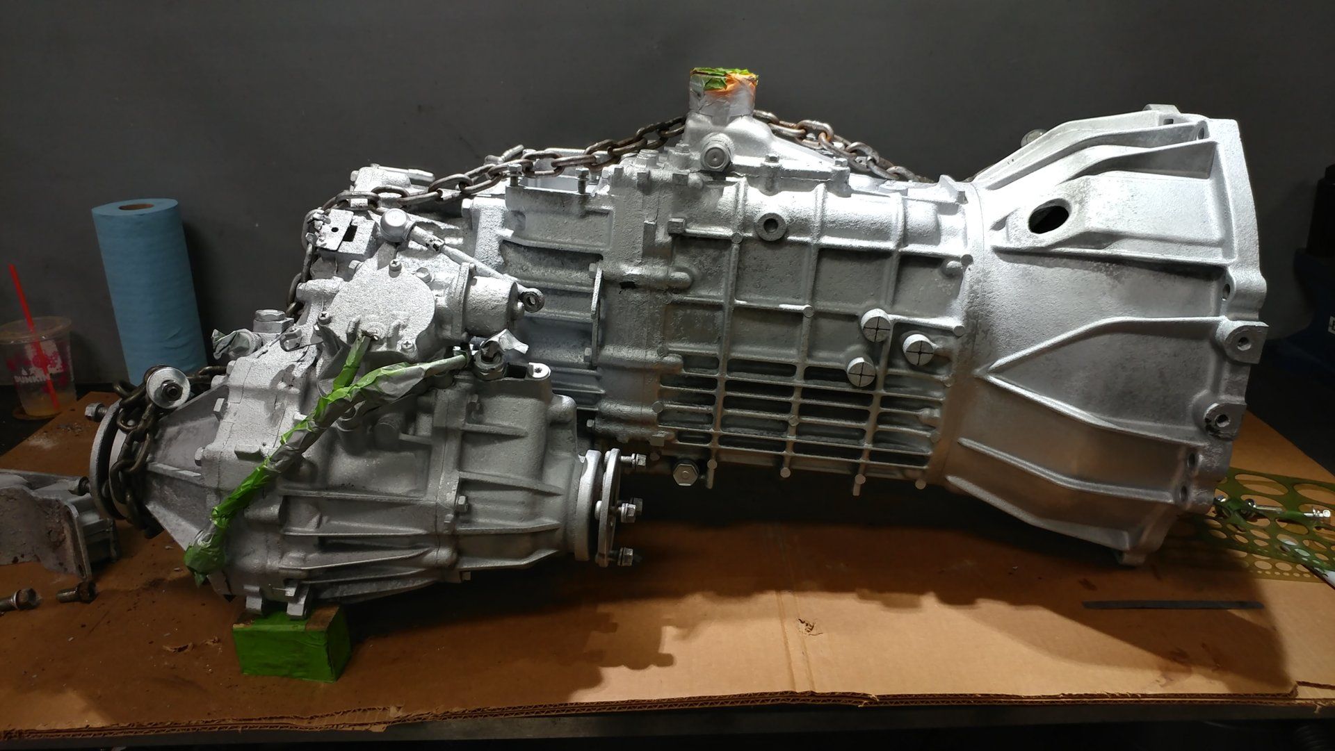

Big trans and transfer case assembly.
Shifter base that is too small....also using the longer arm from the HDJ81 transfer setup that we had(came with trans since trans was out of a HDJ81). This shifter arm has a pin pressed in the bottom...we had to drill it out so the ball joint on the rod could go thru. We're a little worried about clearance with this setup. The other shifter arm I have is shorter but tighter to the trans....we may have some interference with the trans tunnel. I feel a custom shifter arm needing to be made.

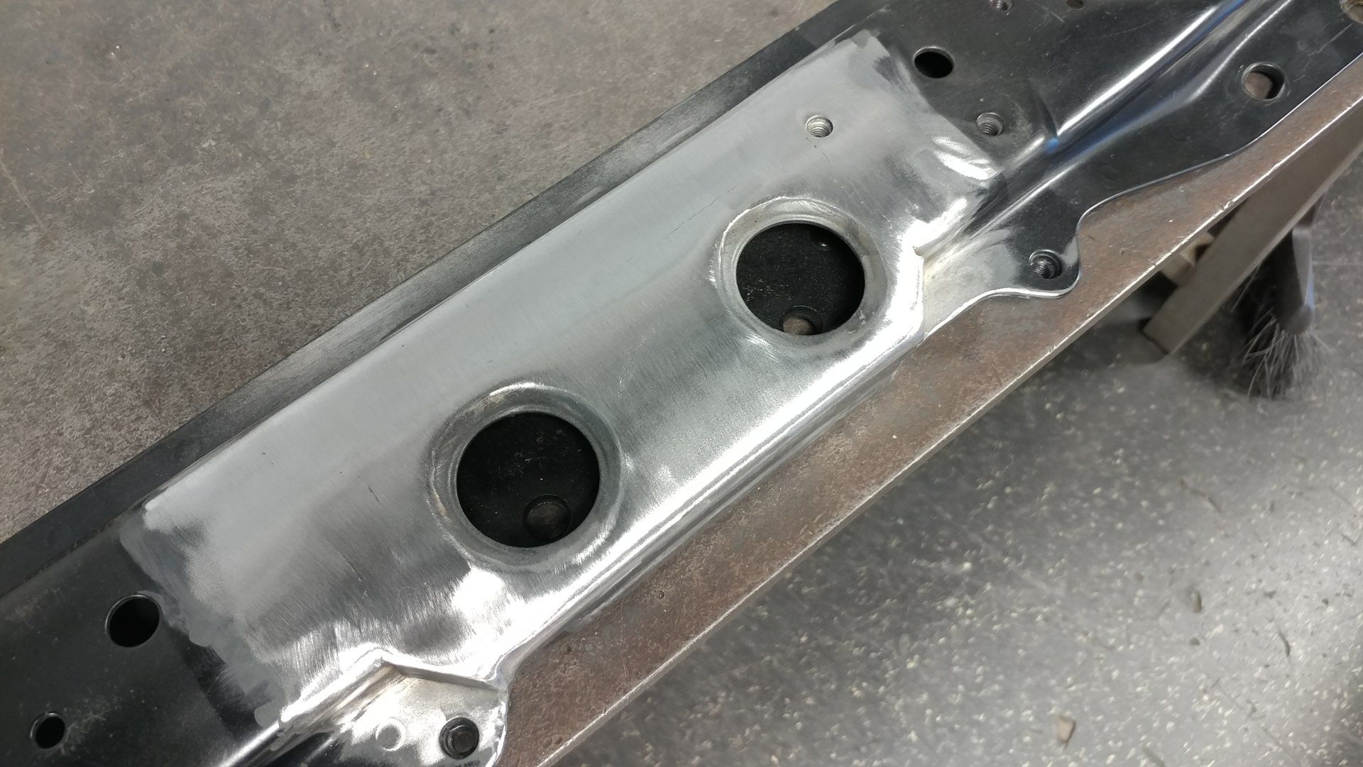

Underside of crossmember.....we'll need to cut out the access holes
Extended the top out the 1" we needed for the mount to fit flat on it.
Cut the bottom out...

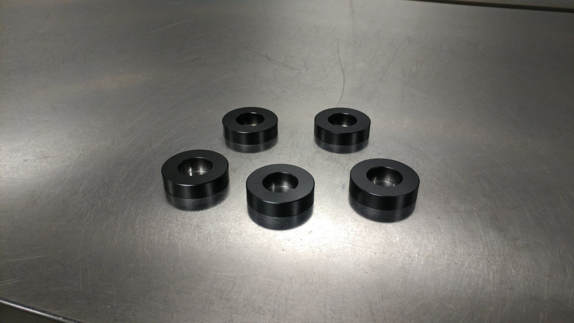

We installed some 1/2" thick aluminum spacers and that seemed to really make things right. Much better clearance on everything.
Truck had 70 series bushings but they were in all the wrong locations....we adjusted those first.
Used these for spacers to see if the 1/2" size was good...it provided great clearance and didn't affect my brake lines or anything else for that matter.
Going to use a larger 3" diameter on 4 of the cab mounts since they are larger. I think the 2" ones will work fine for the bed and front Rad support mounts.
