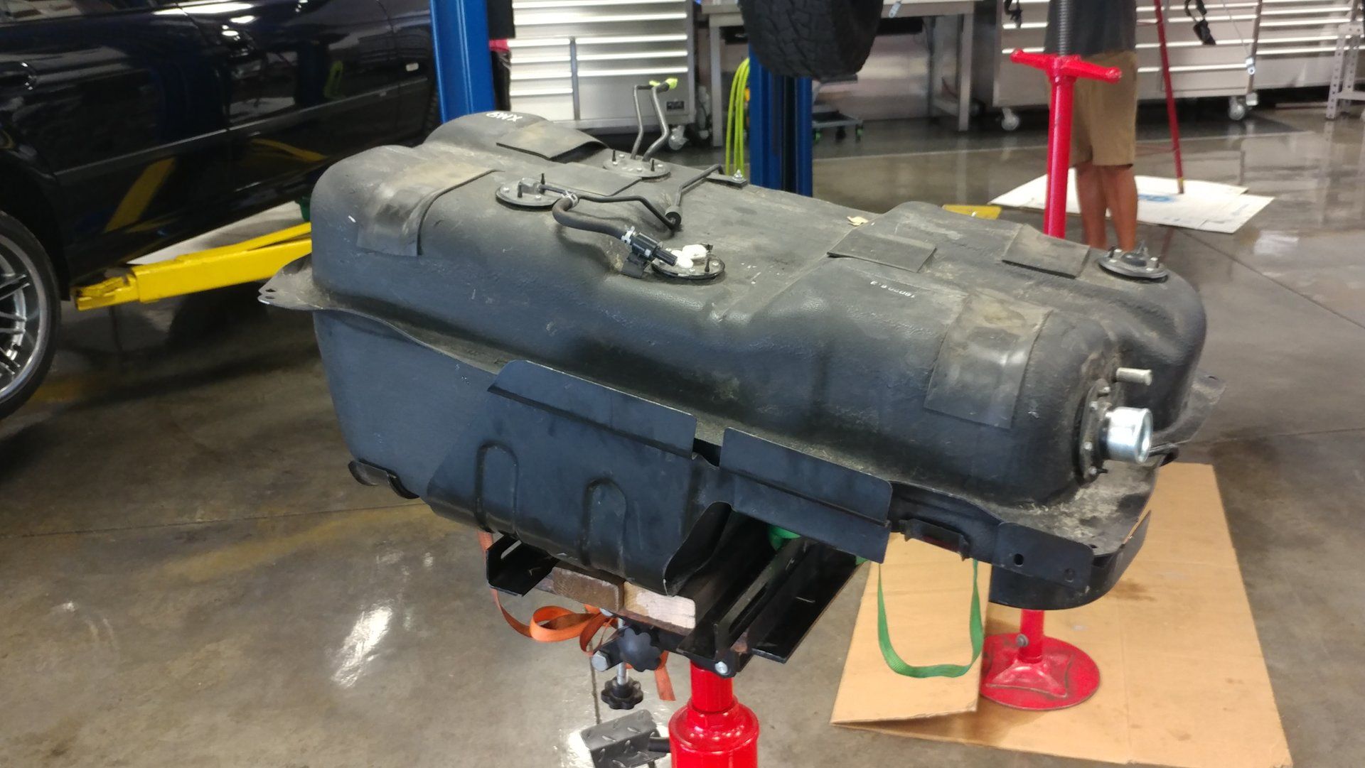

Started on this today.....main tank install
Nice new takeout tank....
Figured this was going to be an all day install.....but in 2 hours it was in. It did require a rather large dead blow hammer to.....well.....'contour' a couple areas of the tank. If the cab was off, I think it may have cleared but it was too tight in a couple of spots. We massaged it a bit and it went right in. WAY better than the rear sub tank. Ha. Couldn't fine the pins and clips for the strap(where they pivot) so I'll have to order them.

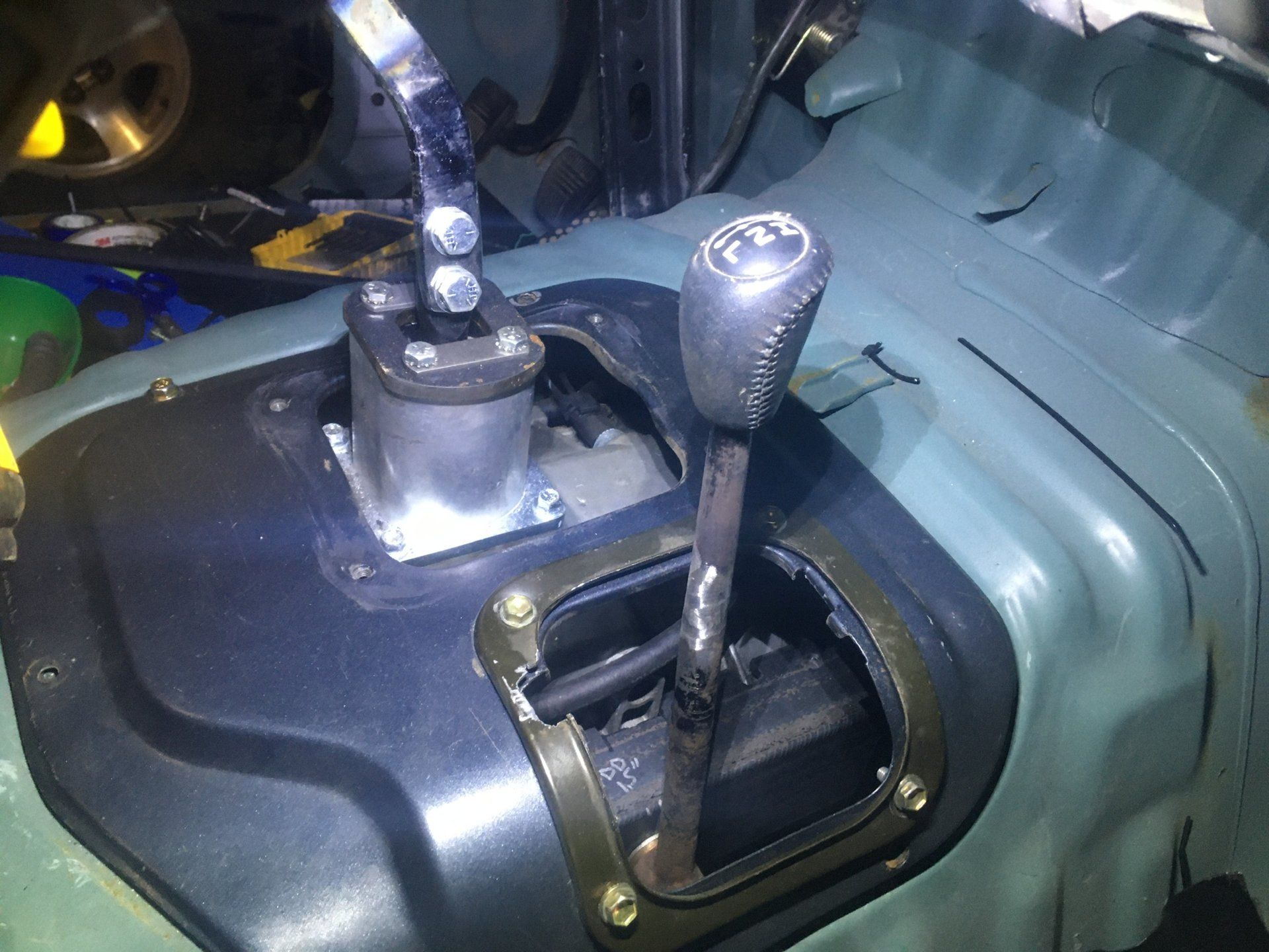

We had time to start on the part I have been dreading the most.....the trans tunnel. Truck isn't set up for a H151 trans....or the transfer case behind the H151....so this will require a fair bit of work to get it right. The floor covering is for a R151 truck so we'll have to come up with a console of some sorts to cover up where the changes are going to happen.
We'll install the trans tomorrow once the tunnel cover is off so we can see where things are going to line up. I have a sneaking suspicion that the shifter is going to be really close to the dash....which may be a big problem. If that's the case, we'll switch over to an R151 trans most likely. Not a huge deal...just not what I was planning on.

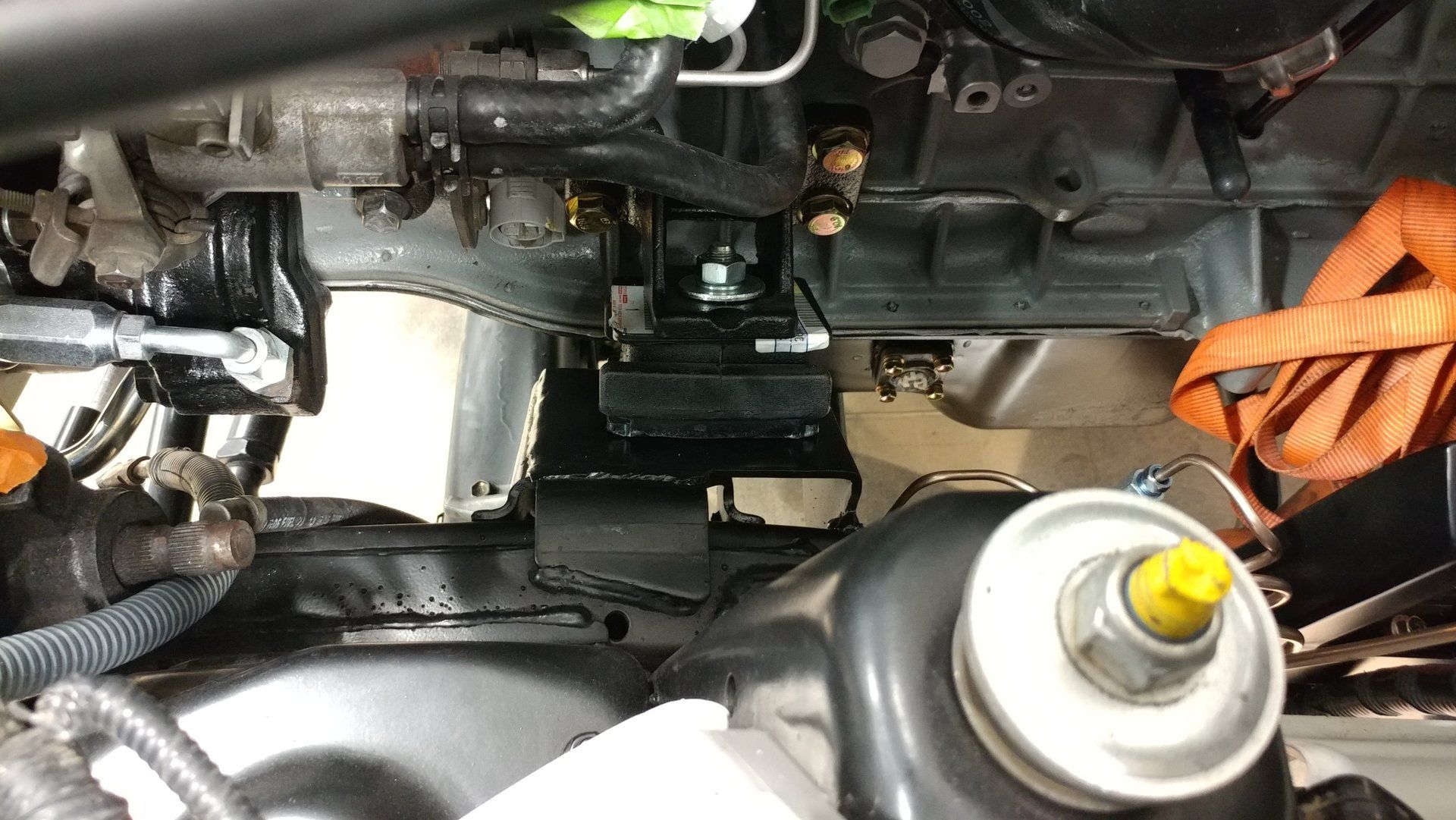

Today I wanted to double check where the motor sits in relation to the radiator, firewall, etc. Something has always bugged me about the motor placement and when I started doing some rough measurements on where the shifter tower was going to line up...it was off which perplexed me but also what I had kind of feared.....the engine was sitting too far forward. Bought this as a roller...saw pics of it with a 1HZ on it....took it for granted that it was located where it should have been. Could have been a big issue.
The 1HZ motor was sitting on the stock FZJ80 motor mount brackets....about 1.5" too far forward when I compare the placement of the motor in my HZJ73. Makes sense as I feel the shifter is about 1.5" too far forward from where it should be in relation to the R151 opening on the tunnel.

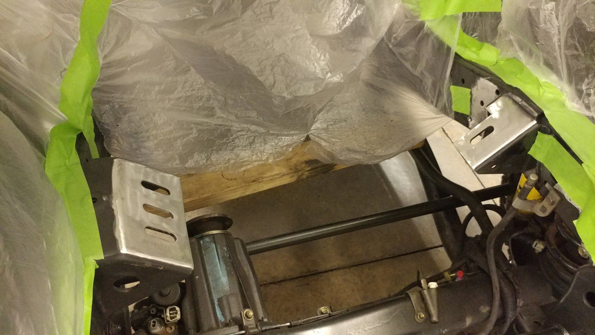

So.....this was how we spent part of the day:
Unfortunately, the new slotted hole hit the edge of the driver side bracket. So we removed part of it and will weld on an extension...I want to weld to the existing mount which will raise the pad/surface up .180 or so in thickness...so we'll have a .180 plate on the other motor mount to balance it out.
We made a new slotted hole in the passenger side mount....almost right in the middle of the 2 that were already there.
Got our modified mount buttoned up and the motor back in(I think it was in and out 3 times today).....I feel much much better with where it's sitting now. It looks right and when we lined things up with the fan in the shroud, it was right where we wanted it. Shifter tower will poke thru right about where I expected it. Confident we're spot on. It's a shame that we've had to grind on this frame and touch things up(was powdercoated) but when you finish someone else's project, sometimes that's the way it goes.
The takeaway from the is.....if you're putting a 70 series body on an 80 frame with a 1Hx motor, push that sucker back 1.5".

Bracket extension we came up with
Quite a bit of welding went into it....added some plug welds.
Looks pretty OEM after some grinding/finishing...
Things fit really nice....

Tomorrow we address this mess. Need to check shift lever placements. I think we're going to be OK.....
