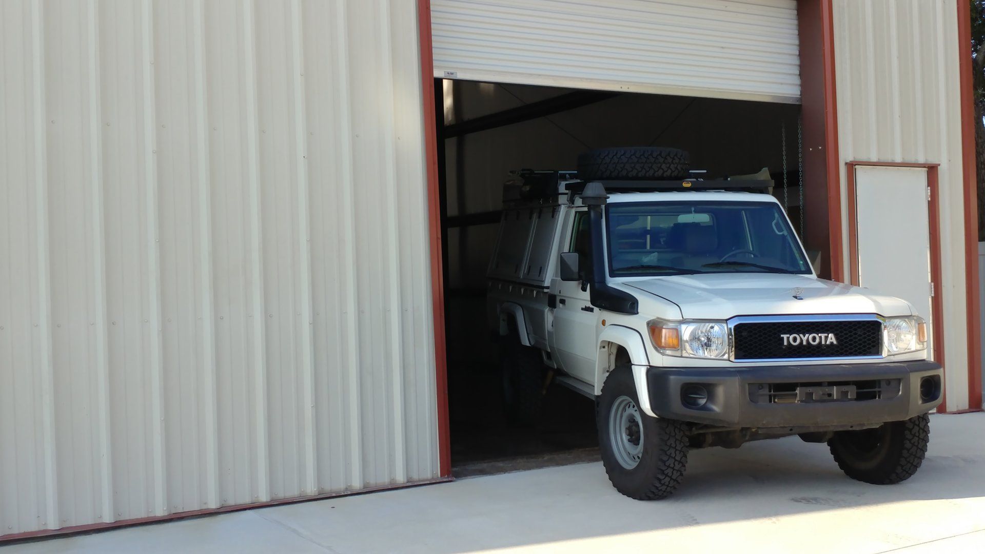

#1 making it's emergence to get ready for the 70 series gathering next week. Can't wait.

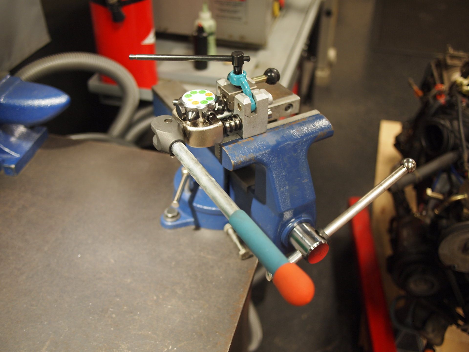

I always put a plug in for this tool in my build threads. This might be the best tool in our shop. I look forward to doing brake lines because of it. It's therapeutic. It's from another planet. It's perfection. If you have to do a brake line job....buy one. One of our buddies came to the shop one night when we were fighting with some kind of line a long time ago and was telling me about this thing. I didn't believe him. He brought it over the next day. At first I was in disbelief. Then sadness set in. All that time spent fighting with the stupid grinder, dies, clamps and BS of those little hand held flare kits. This changed my life. It will change yours. And it's under $200.

I have a very similar tool for flaring, your description is spot on! Read and listen to that plug, he's right!
I will probably never forget the day that guy showed me that piece of equipment. I was speechless. It was like somebody turned a light on. I bought my own the next day. He was also the guy that told me about the nickel copper tubing. 25+ years building cars and trucks and a solid 20 in the professional world and in 10 minutes everything I thought I knew about brake lines was turned upside down. Lol. Joy, disbelief, anger, sadness....I ran thru all the emotions.
Buy one and then tell everyone about it.

Do you get the metric copper lines and fittings or sae ?
I use 3/16" copper nickel line with 10mm fittings. I like the Inline Tube parts.
We also use one of these. REALLY makes it easy to get the lines straight. It does a great job of straightening them out.

I had one of those, Eastwood brand. I upgraded to this because you can flare on the truck if needed.

That one is slick. We don't tend to flare on the cars very much....usually we are making all new lines. I wish I had something like that a long time ago though...would have been worth it's weight in gold fixing crappy twisted off fittings. I wouldn't mind having a on-the-truck flare tool in my box.

Putting in a proportioning valve, that is when I need to flare on the truck the most.
